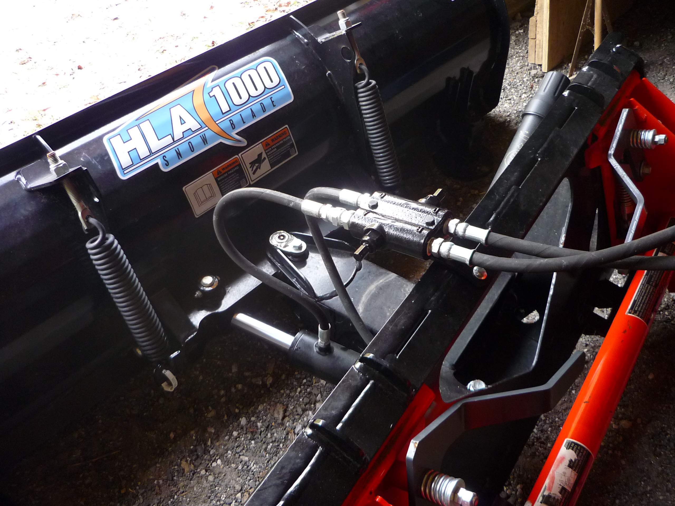

/ First CUT: Sizing and Used Options #46
Check out the HLA plows... made by Horst Welding, in Ontario. They make a full line of sizes and weights, and when I needed a plow, Messick's in PA set me up with my HLA 1000, 78", with the hydraulic angling. HLA Snow | 1 SnowBlade
Works well, and seems like it is solidly made. I see the current models come with a crossover relief- I had added mine, because I am plowing a rough lane, with snags here and there. I like being able to lift snow piles up and over using the loader, when I run out of space to put snow.

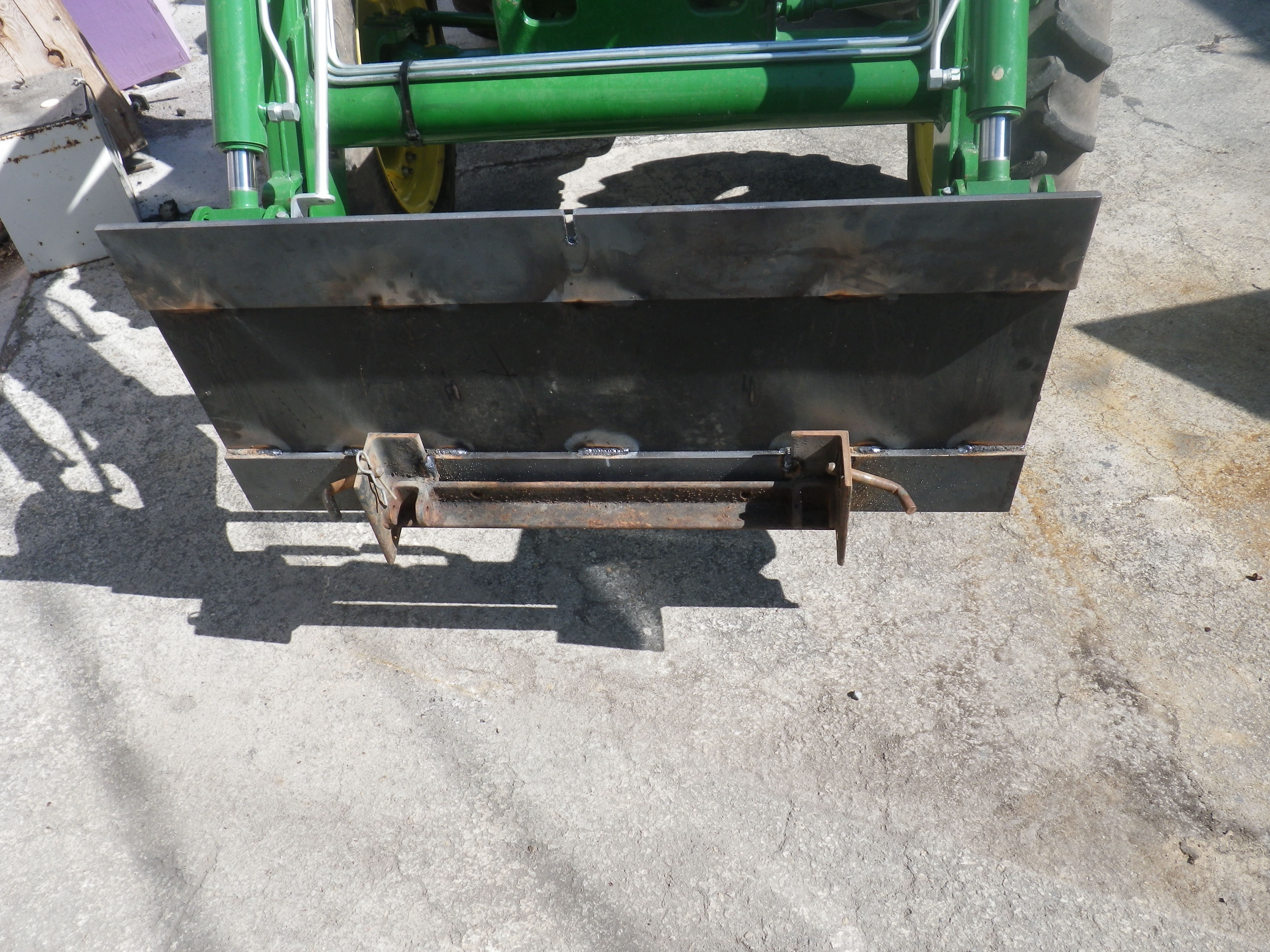

/ First CUT: Sizing and Used Options #47
i bought a SSQA plate and created a mount for an 8.5 ft meyers. i didn't shorten the a frame on the plow so it hangs way out there, but i can still use it on a truck if need be

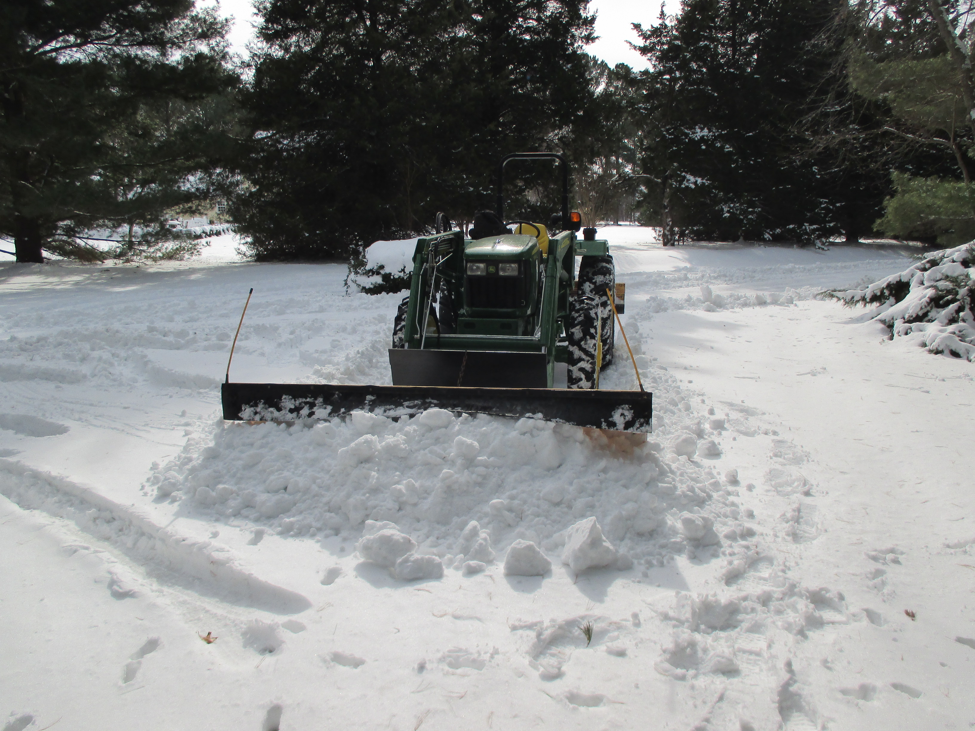

/ First CUT: Sizing and Used Options #53
I converted an old Curtis truck plow to my SSQA;it has worked well.Choice you have with the FEL mounted plows;float the blade or float the FEL.I chose to float the blade and it works quite well for my uses.

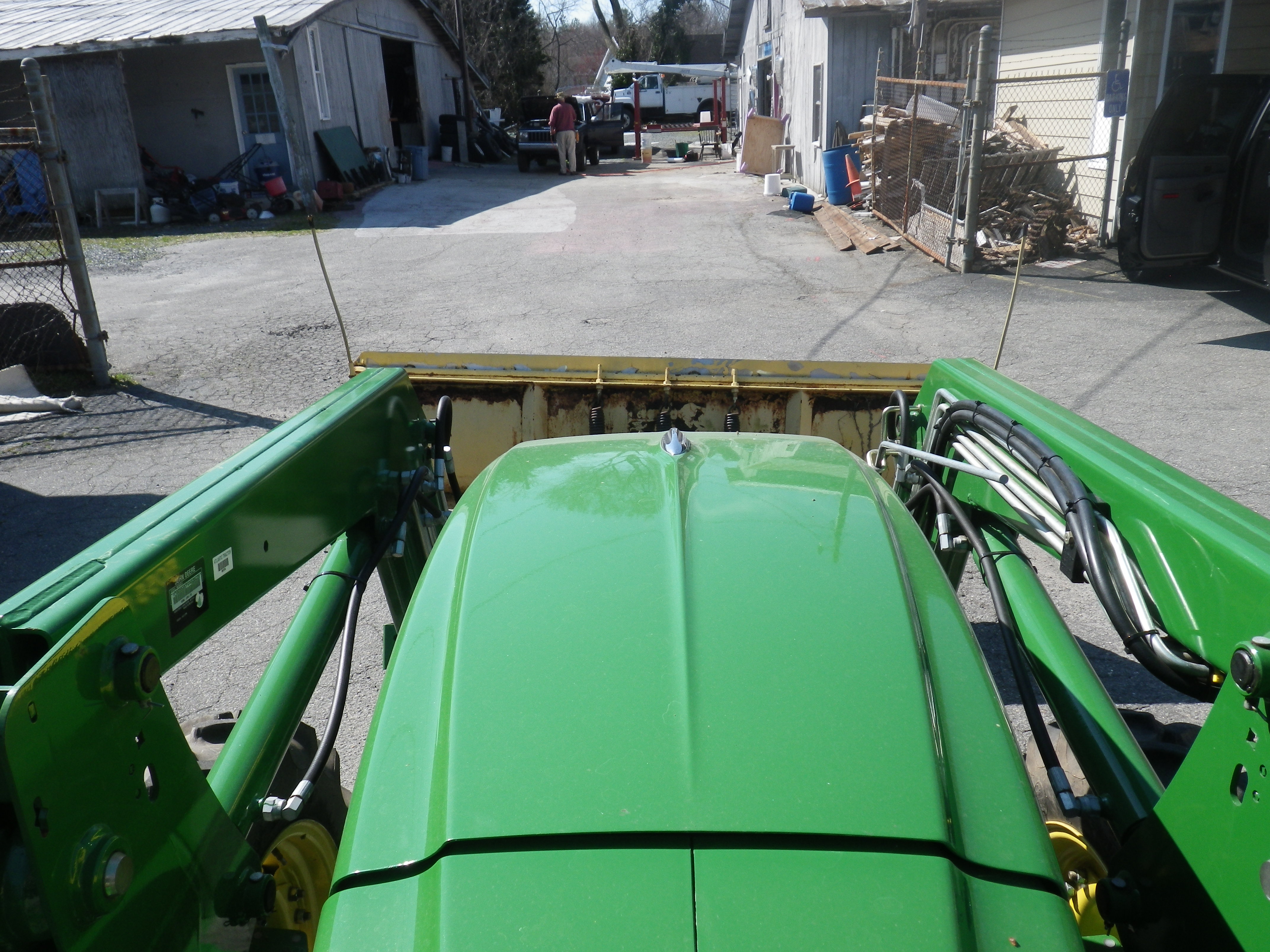

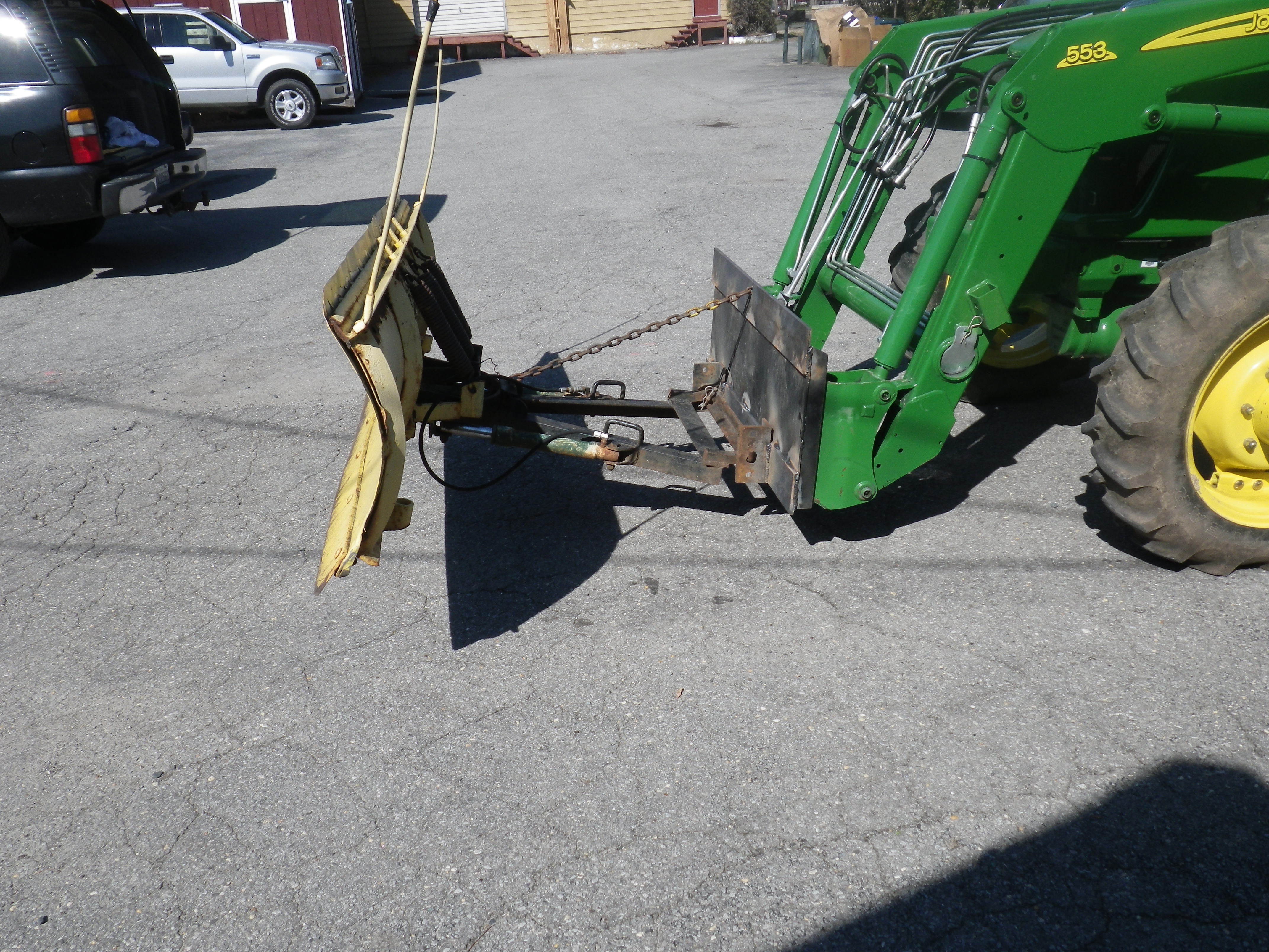

/ First CUT: Sizing and Used Options #55
I converted a 9' Western truck plow w/power angle to SSQA for the front of my tractor. Around $500 or so invested. Works great
I found a used 63" 2 stage rear blower in good condition for $825
