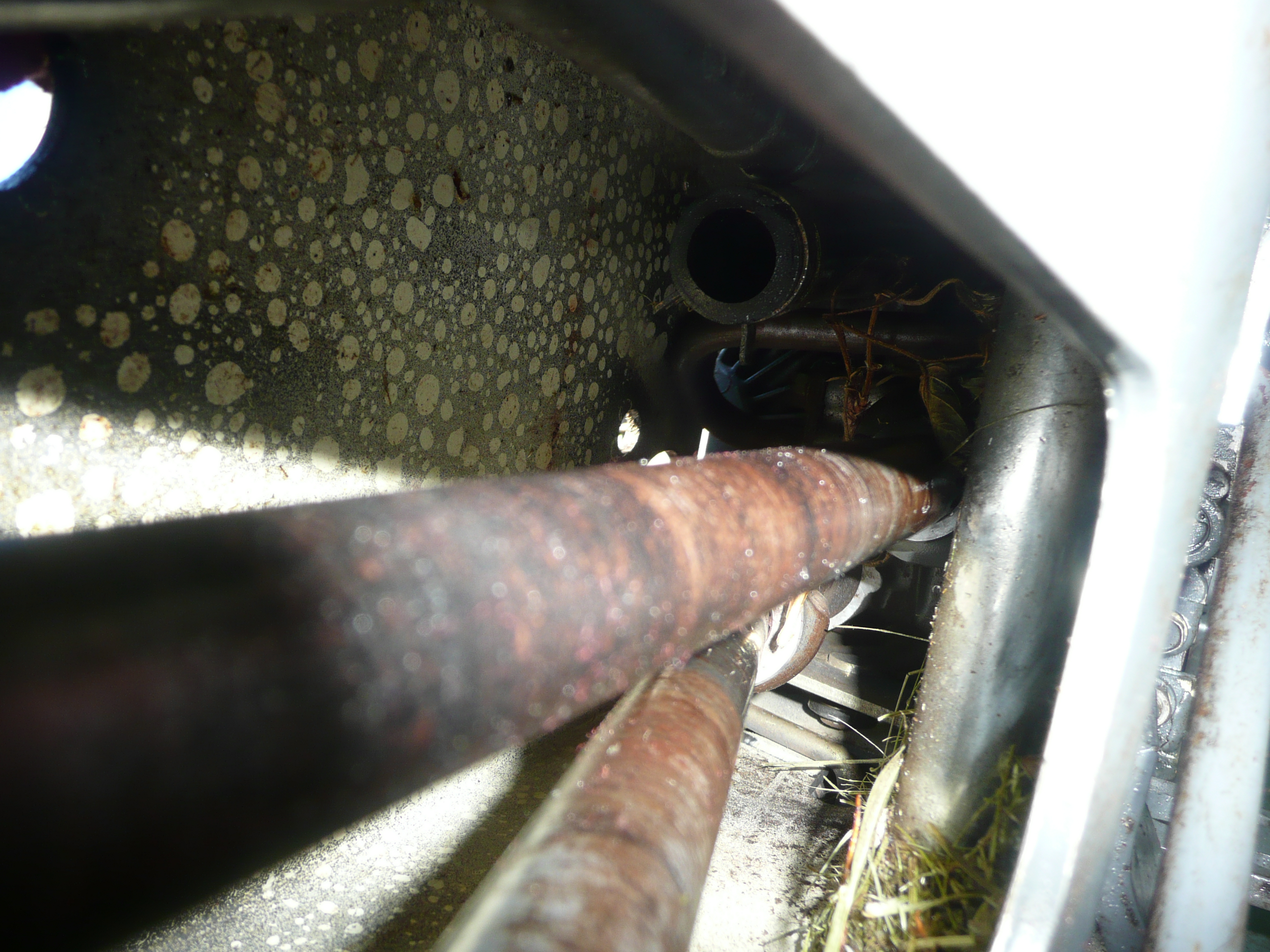

Here's the kind of stuff you can expect. About 1/4 mile from home, blazing a new trail. Salmon berry cane snapped up an went inside the tractor's center channel (not a big target) and slipped back and managed to pop the hose right off the pipe! Was "dead in the water." And I'd been circling back toward the house, which meant I had to pull the tractor out through uncut brush, which included a couple of large logs: wife and I took machetes and a chainsaw. Pulled it back home with the truck.
I couldn't see any of this out in the brush. And even when back home it took me a while to figure out what had happened. With a bigger tractor these kinds of things get more expensive: more fluid loss possible!
