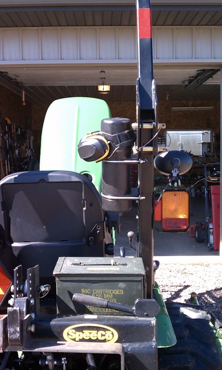

Besides the seat, I found two mods to do today. I relocated the "thermos" which might look like it is in the way for seeing implements behind you but it does not affect my visibility. Now to figure out what I want to use it for as I keep the manuals in the shop, not the tractor.

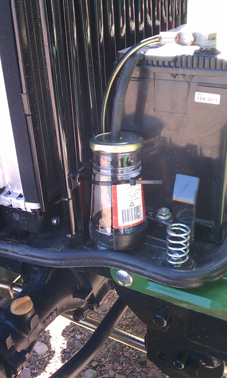

Next I noticed the battery has a drain tube for battery acid which I did not like so I took one of the wifes old olive jars and made a catch for any acid. The bottom and bottom edge are wrapped with a stick on rubber in case of vibration/rubbing.

Edward the "bullet box" makes a great tool box.
