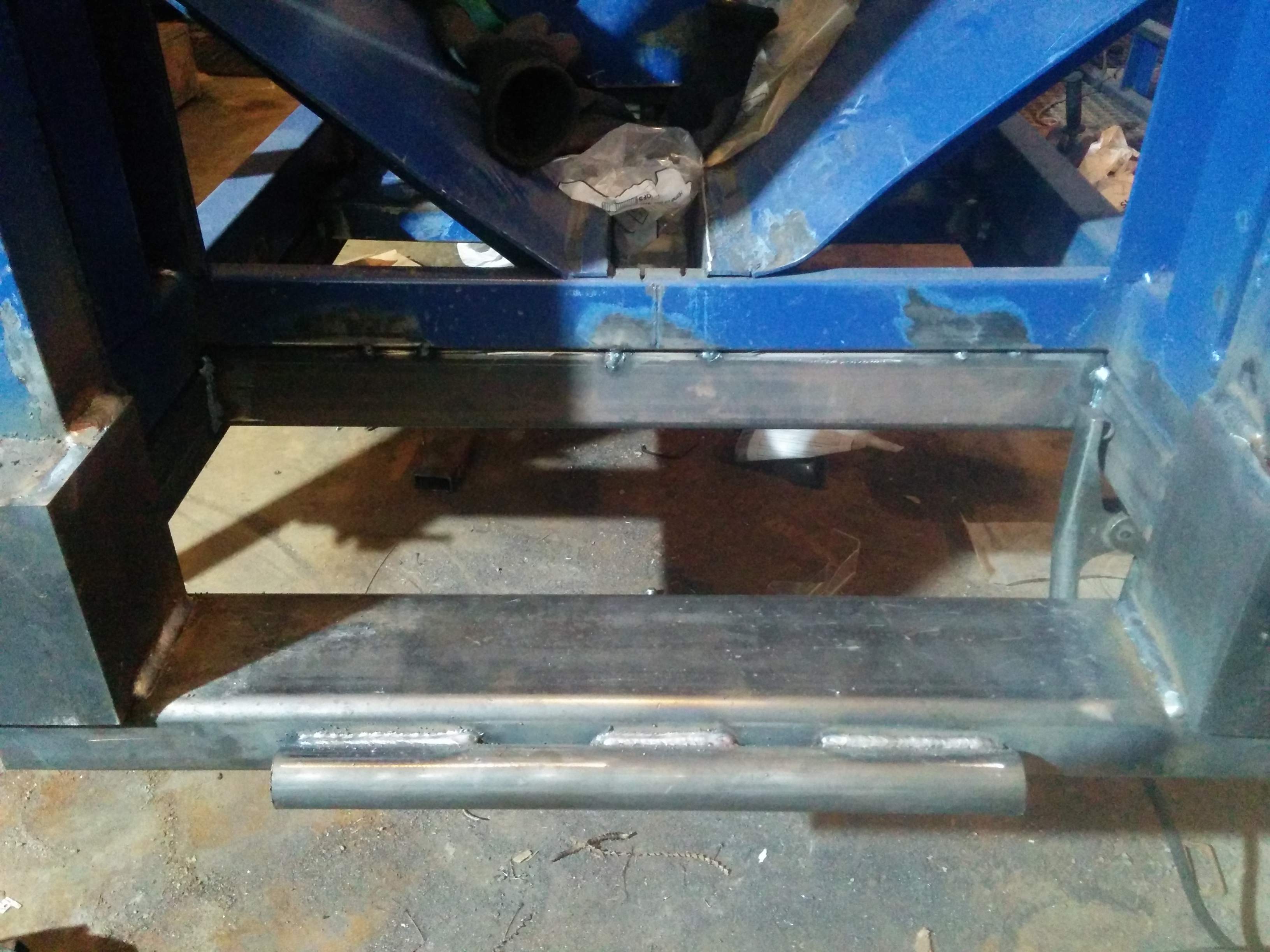

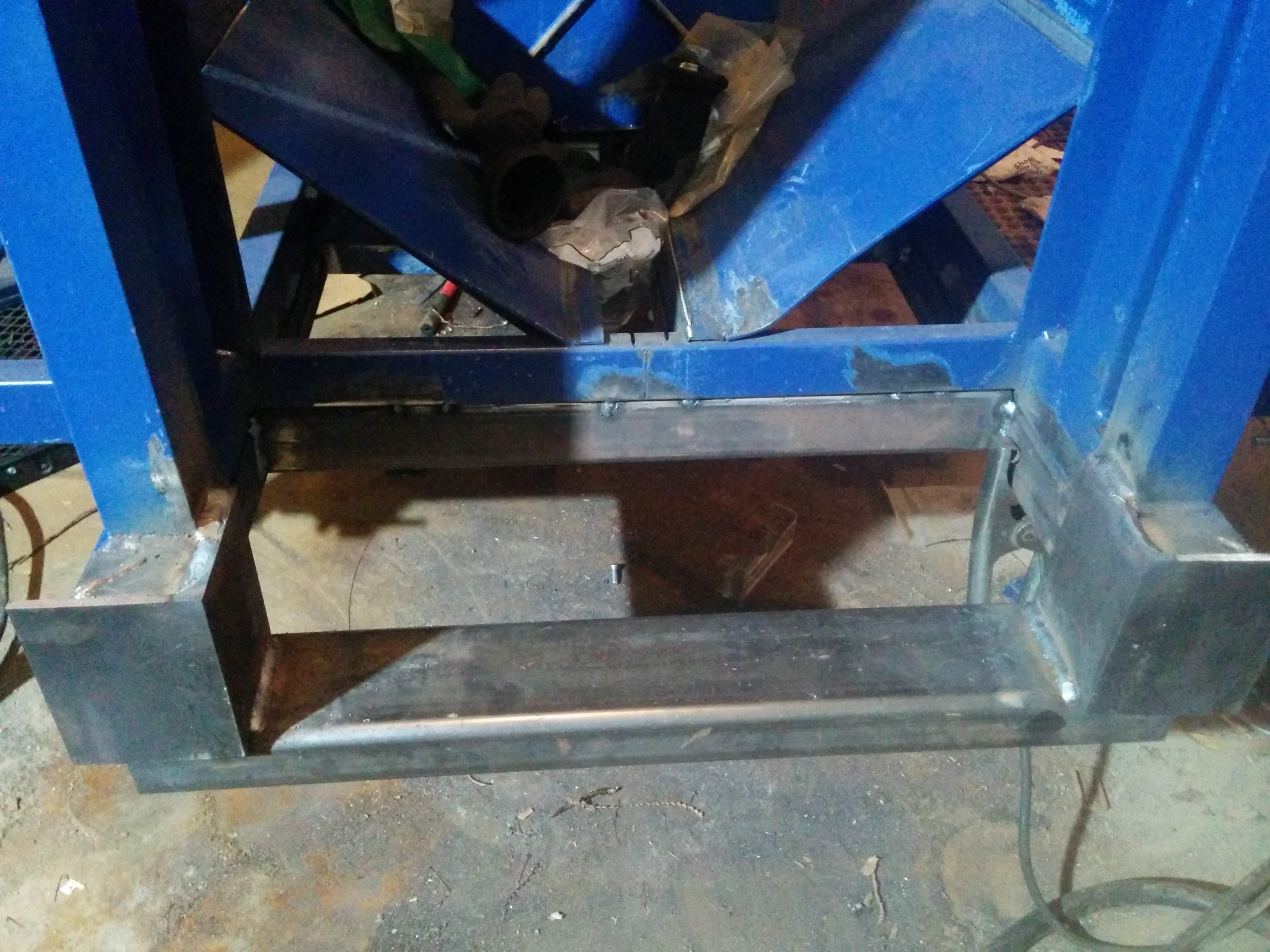

Last night I finished welding everything. I also added some 1/4" angle where I cut the back of the frame off the processor and lowered it. I did this for several reasons, to keep water out of the frame, to prevent wood from catching and ripping the frame but mostly to add strength.
Before:
After:

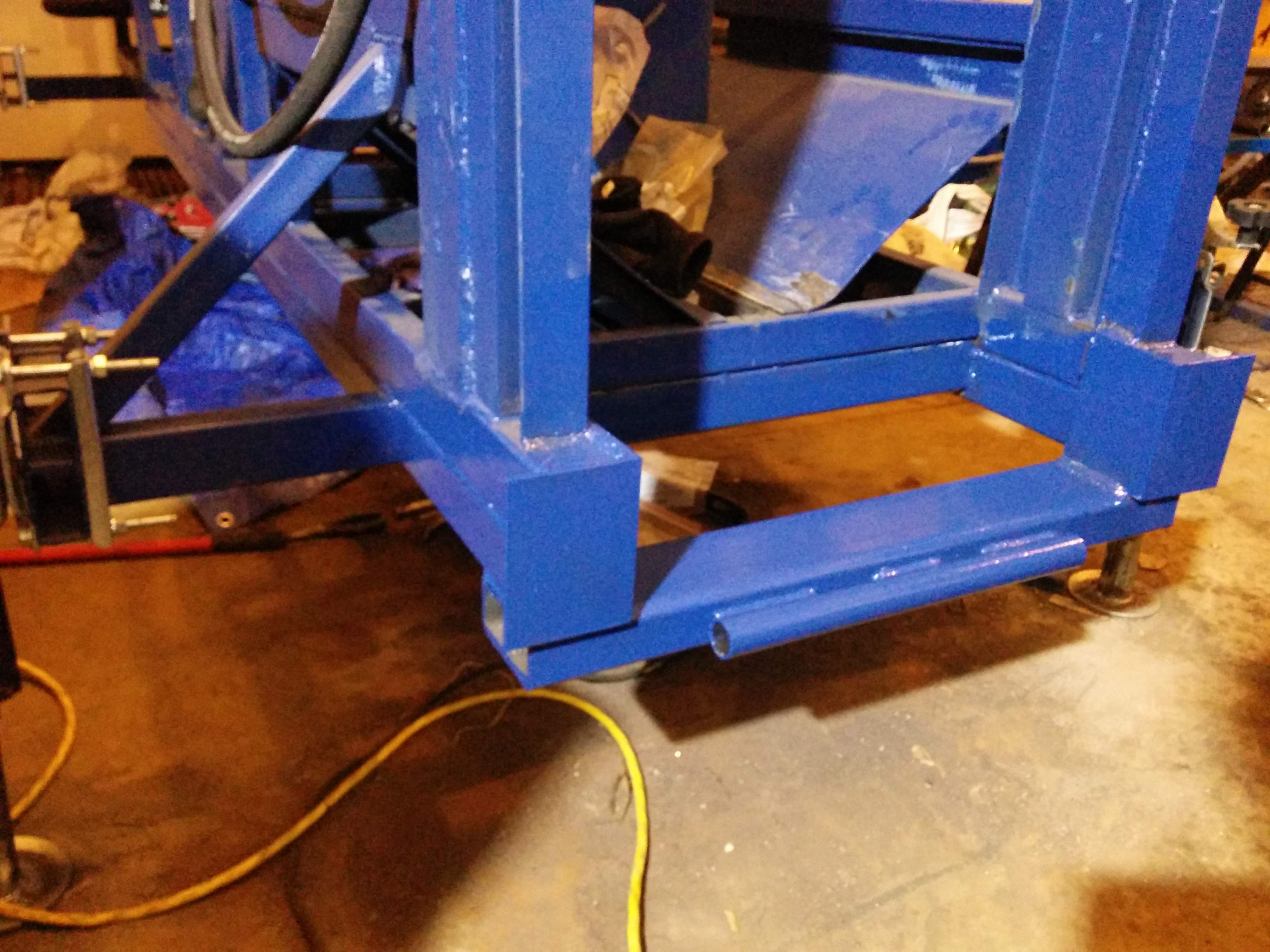

Thanks for the info on the chain, I'll let you know how it goes tonight. Last night was all about paint again. I decided to use a small sponge roller and brush with the blue DevGuard paint instead of trying to mask everything so I could spray it. That paint is supposed to be rolled/brushed on anyway. It was a good choice since a thick skin had dried on top of the remaining paint and I ended up with small chunks in the paint, there's no way it would have sprayed. I was able to do a much better job with a roller than I expected and I'm satisfied it will protect it till I can get back to it this summer.
Doesn't look much different, but it's all blue now.

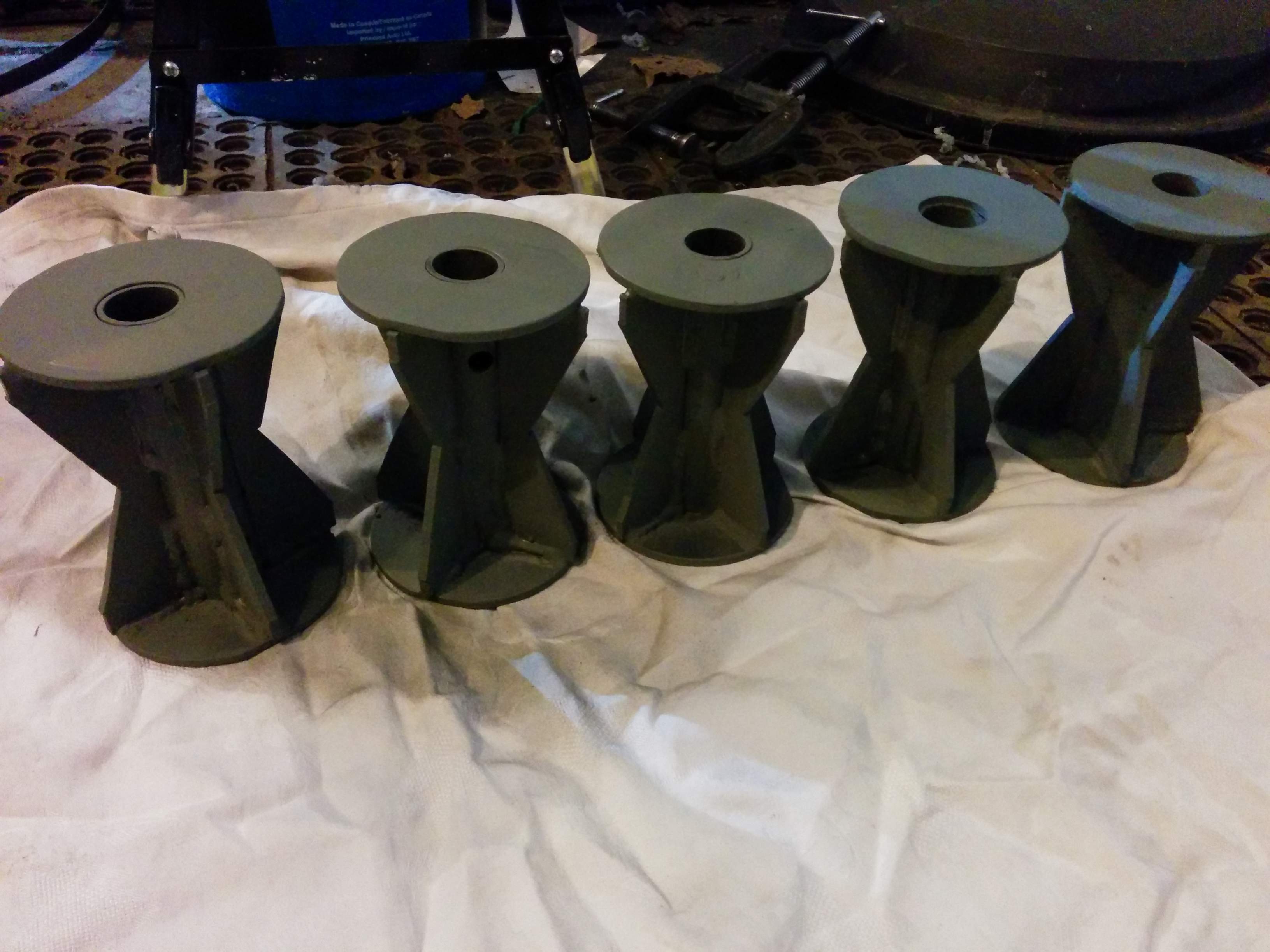

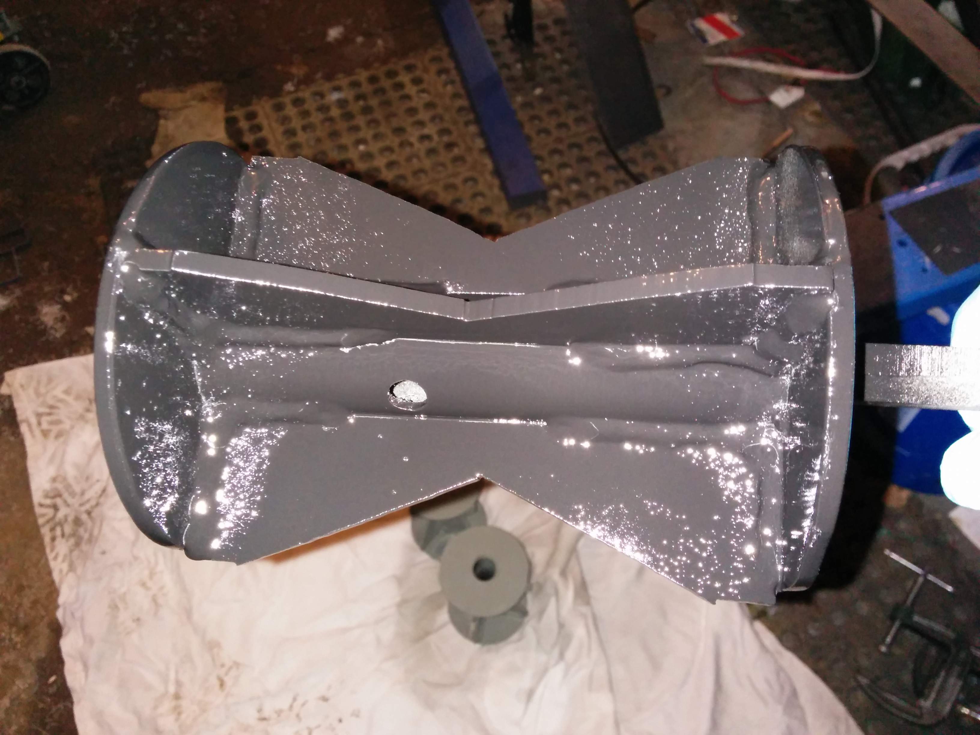

I primed the rollers.
I then sprayed them black. Yes, they are black in this picture, just bad light with LED flood lights. With so much blue, I wanted to use something to break it up. The rollers, hoses, cylinders, valve bodies, tank and parts of the engine are all black, so it helps to reduce the blueness factor. I tried to hit them with the wire wheel, but their shape made it pretty difficult to do much. I don't expect paint to stick that well to them, but it should give them some protection.
