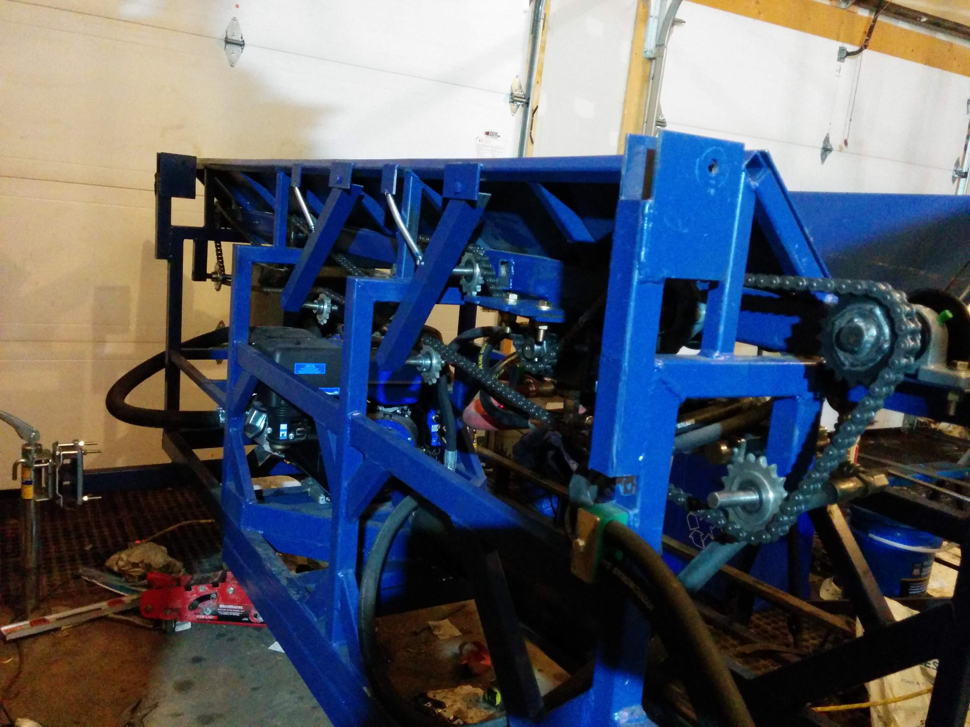

DOOOOOONNNNNNNNNNNNNNNEEEEEEEEE:cool2::dance1::drink::p:D:cool2:
This picture was taken at 1am last night..., errrr, this morning.

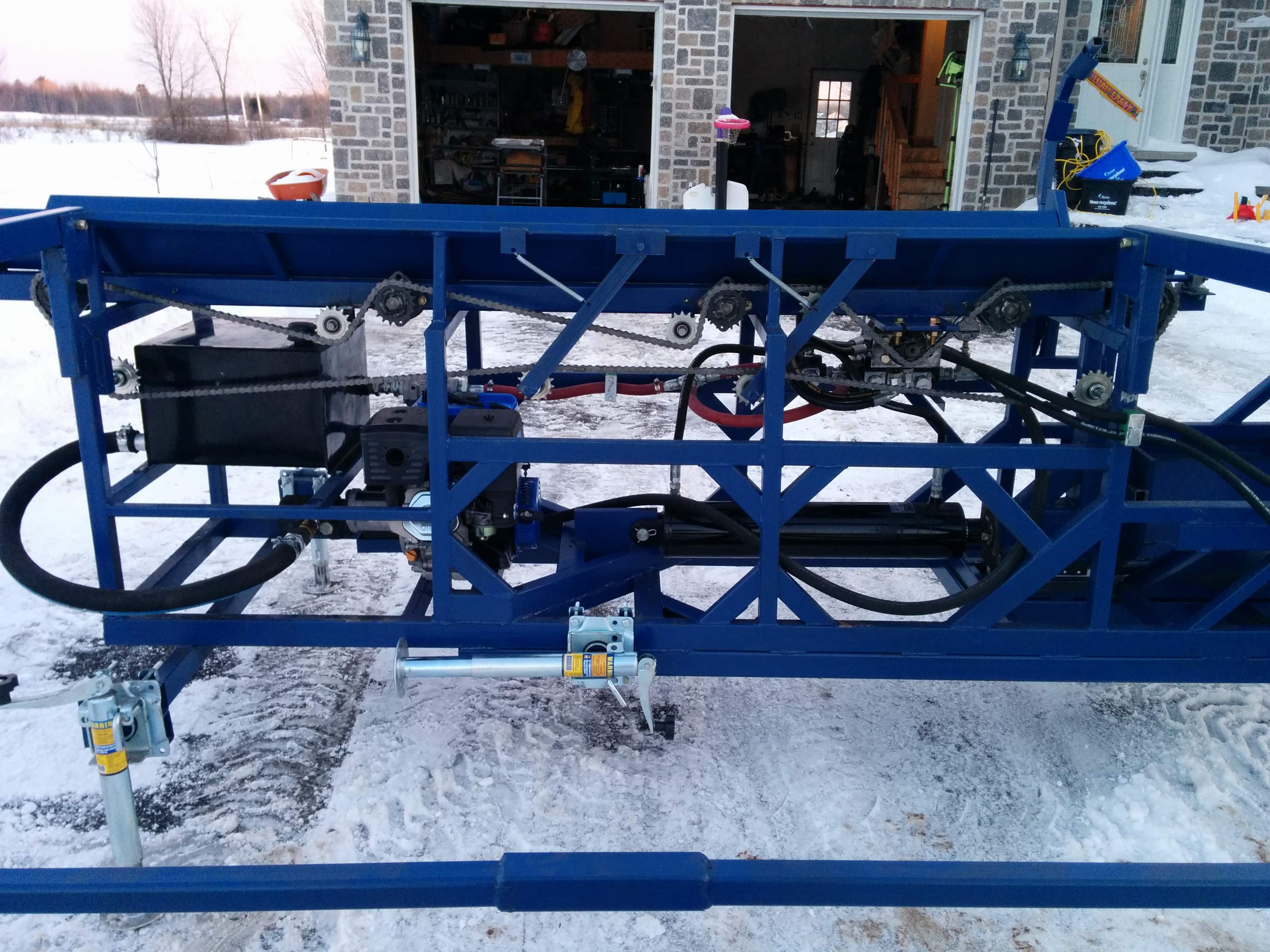

Thanks for the suggestions for breaking the chain, worked like a charm, but the pin was still hard to knock out, a lot harder than I would have guessed anyway.
Proof the rollers are actually black!
The chain is on!

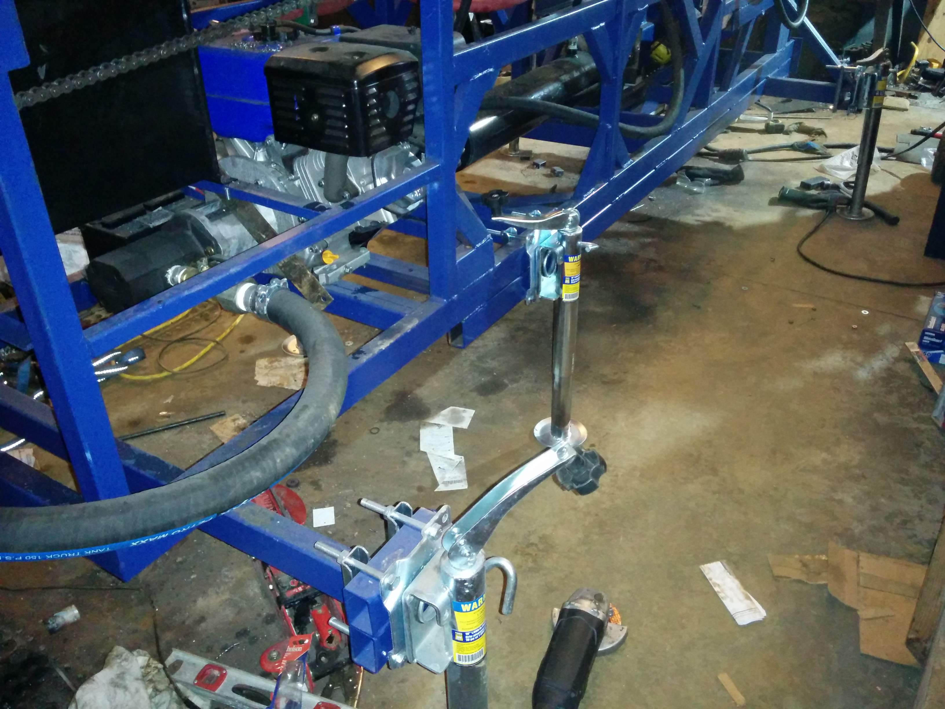

I also added two more trailer jacks to support the weight of the logs sitting on the in-feed rack.

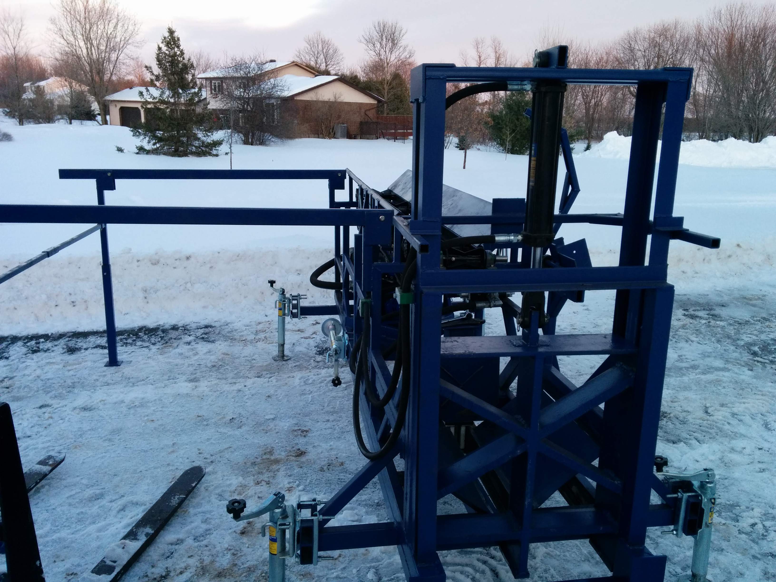

Well, I took it out of the garage after work last night. After giving it a quick test to make sure there were no new leaks and that the roller system and new pusher system works, I tried to take it to the back to set it up beside the wood pile. That's when I dropped it :eek:
As I mentioned yesterday, it snowed and I had to clean that up before moving the processor. Since I had the zamboni on the tractor, I had to either put the blower back on (really good ballast) or take the easy route and throw the scraper blade on (which does a nicer job with small amounts of snow). Not thinking about moving the processor afterwards, I chose the blade. So when I went to move the processor, I didn't have nearly enough ballast.
It was a lot worse sitting in the seat than it shows in the video. The snow bank broke the processors fall so it didn't damage the legs and stopped the tractor from going over. The only damage I can tell is the handle of the new jack I installed was destroyed.

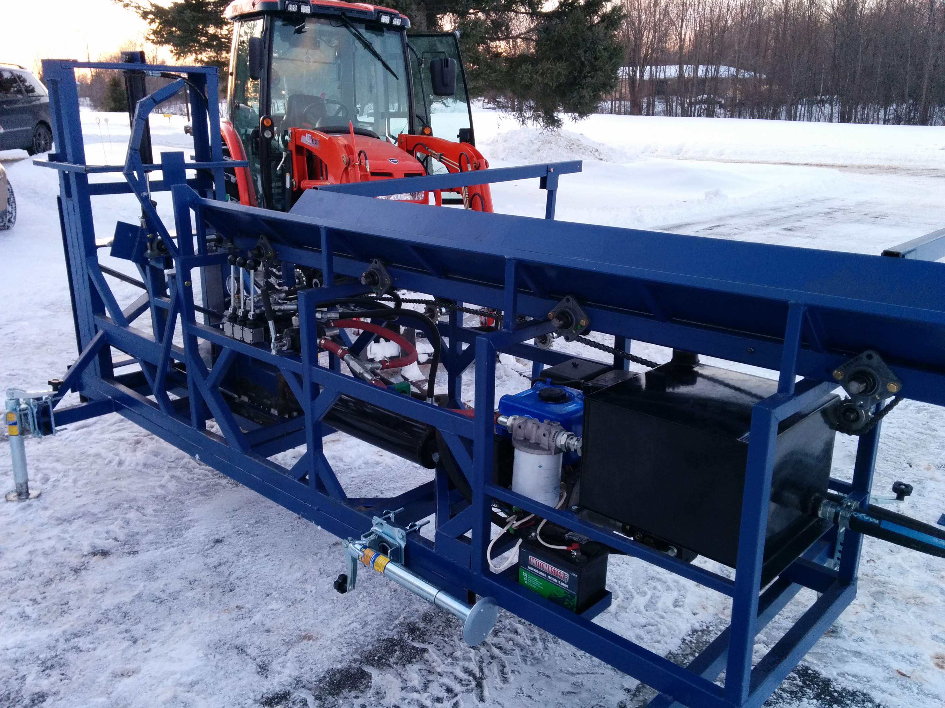

I left my phone in the tractor and it didn't do the best job filming the first test. The vibrations of the processors engine caused the camera's stabilization to make a mess of it. It was also getting pretty close to dark, so it's a little tough to see much.
I'm a little disappointed that the cylinder isn't a lot faster. I was hoping 28 gpm would give me really good cycle times. I don't think the 1/2" ports on the cylinder are big enough to take advantage of the full flow from the pump. Oh well, with a 6 way wedge, it's automatically 3 times faster than my log splitter with a 2 way.
