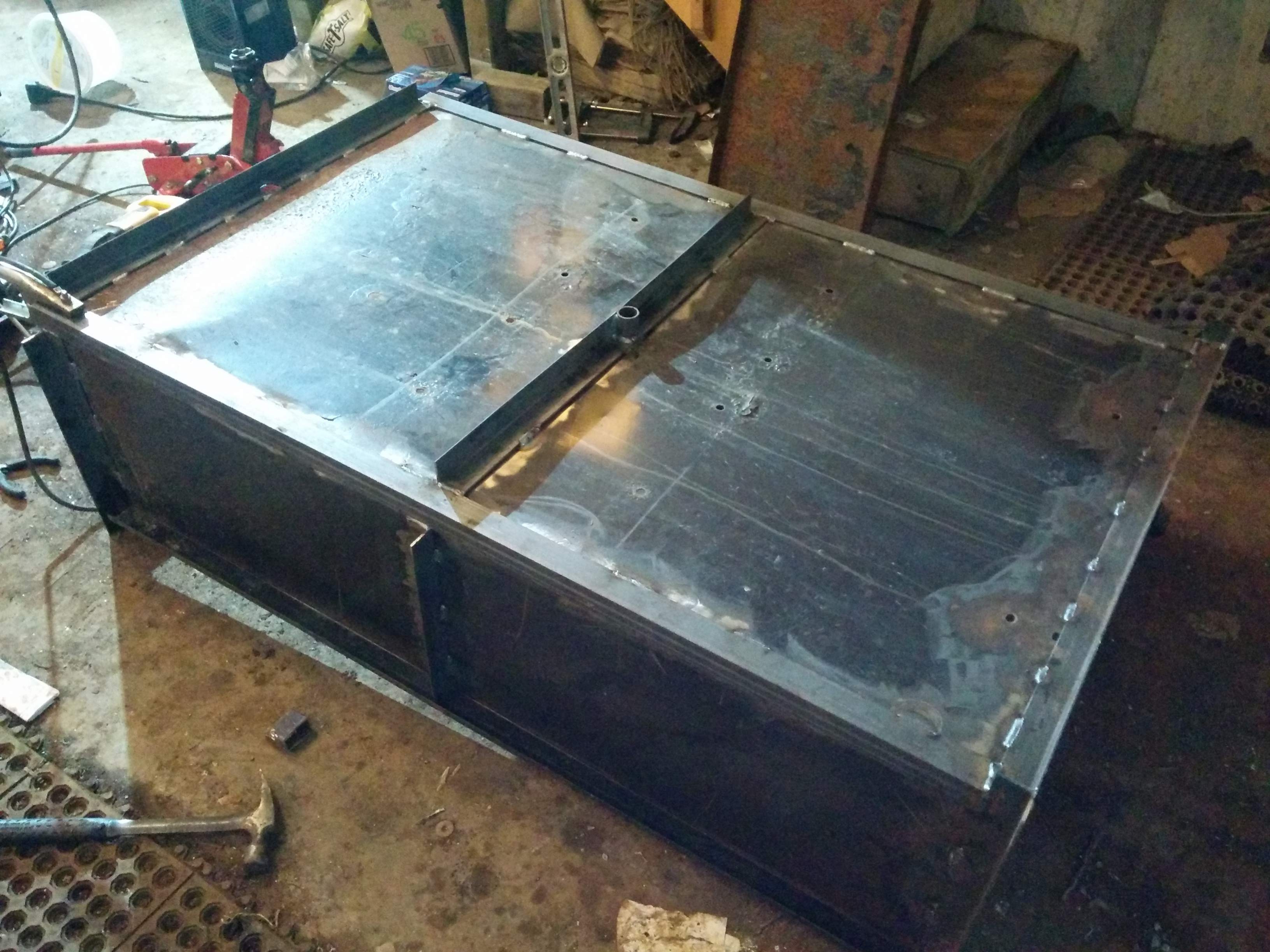

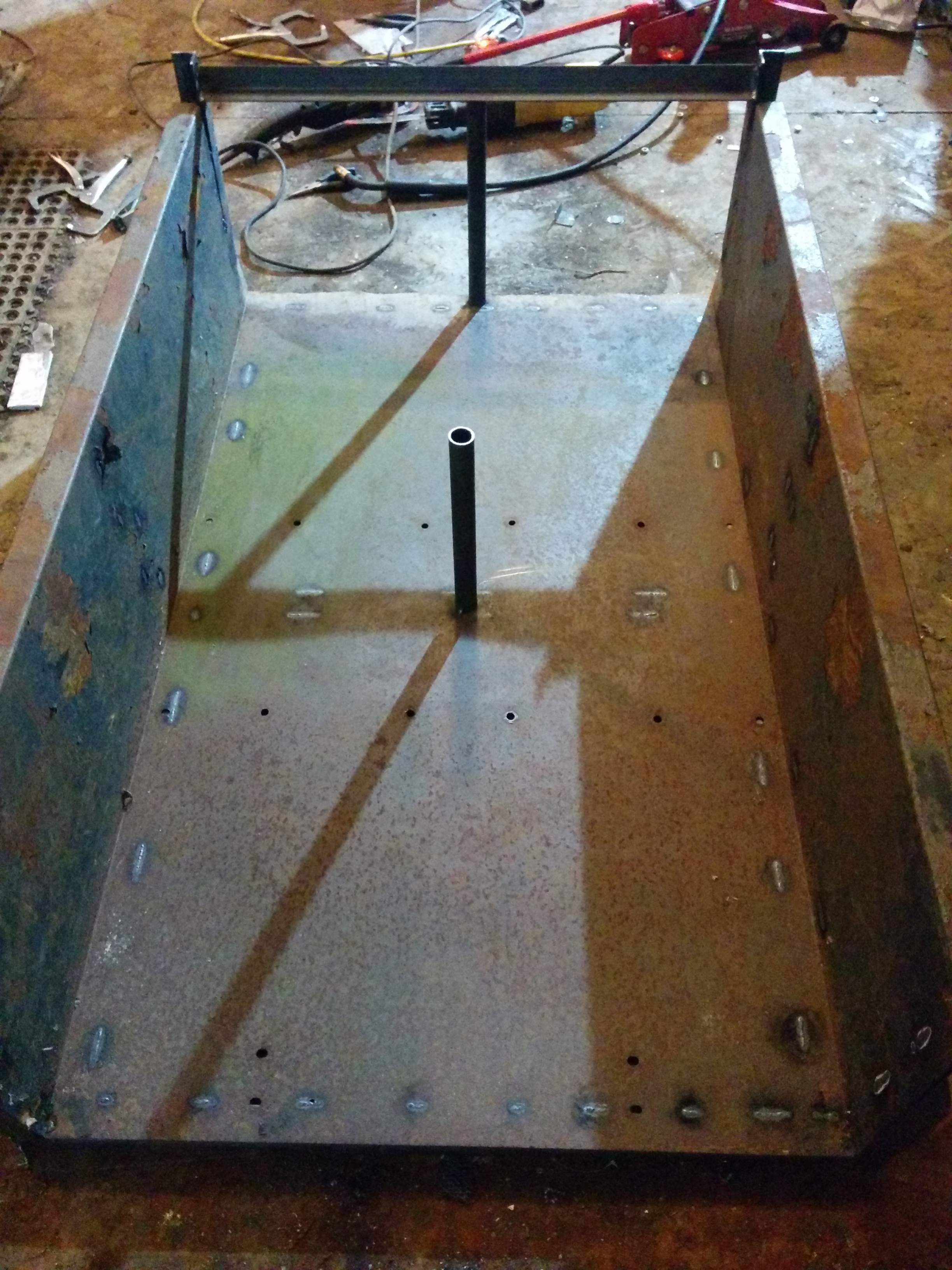

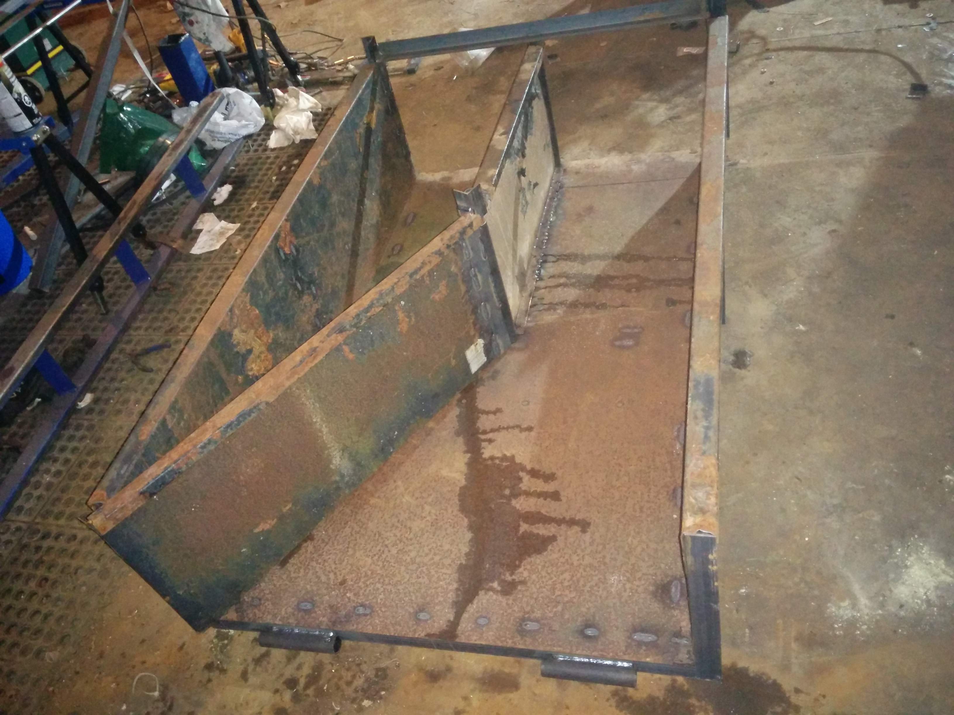

So I converted my old garden tractor dump trailer into an out shoot for the wood. I built a diverter flap and center divider so I could have it fill two bags without having to stop. I think I'll have to add a little extension to the end of it to really be able to fill two bags without stopping, but for now, I only have one frame and I just don't feel like building a second one right now.

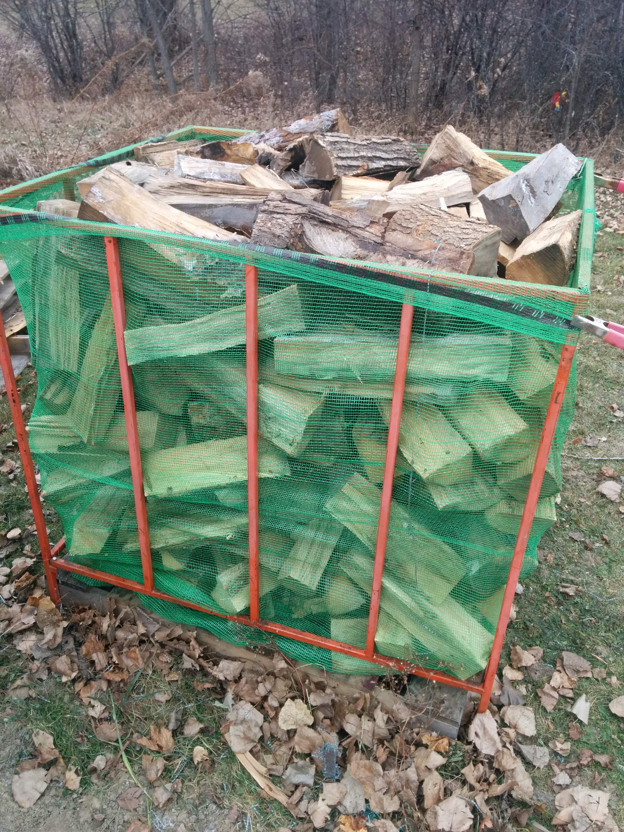

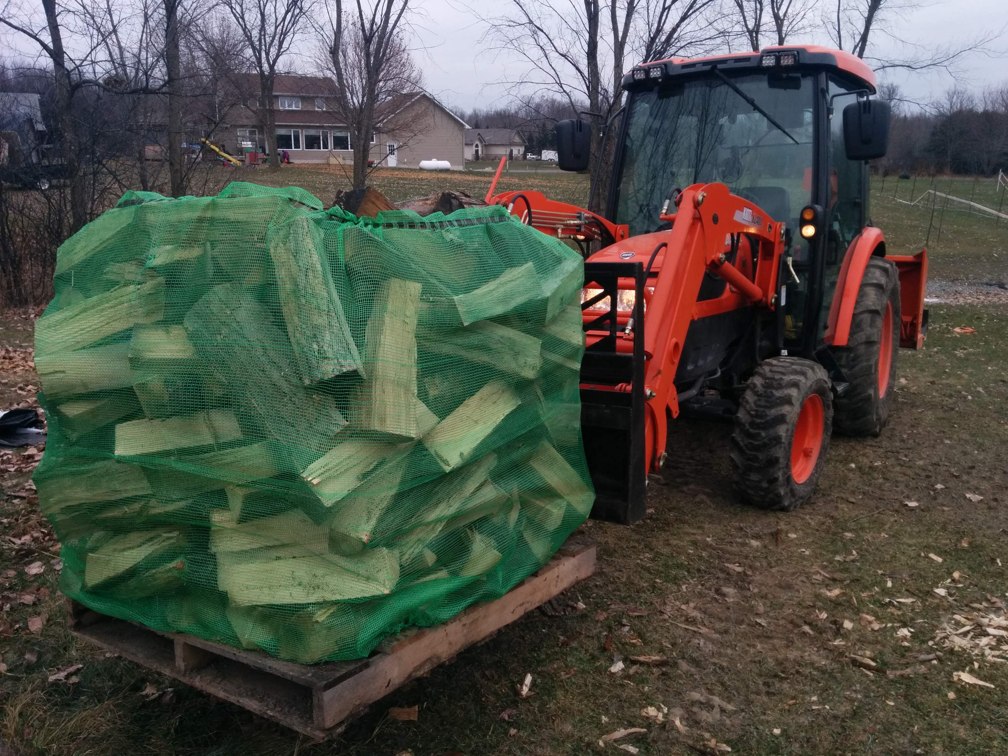

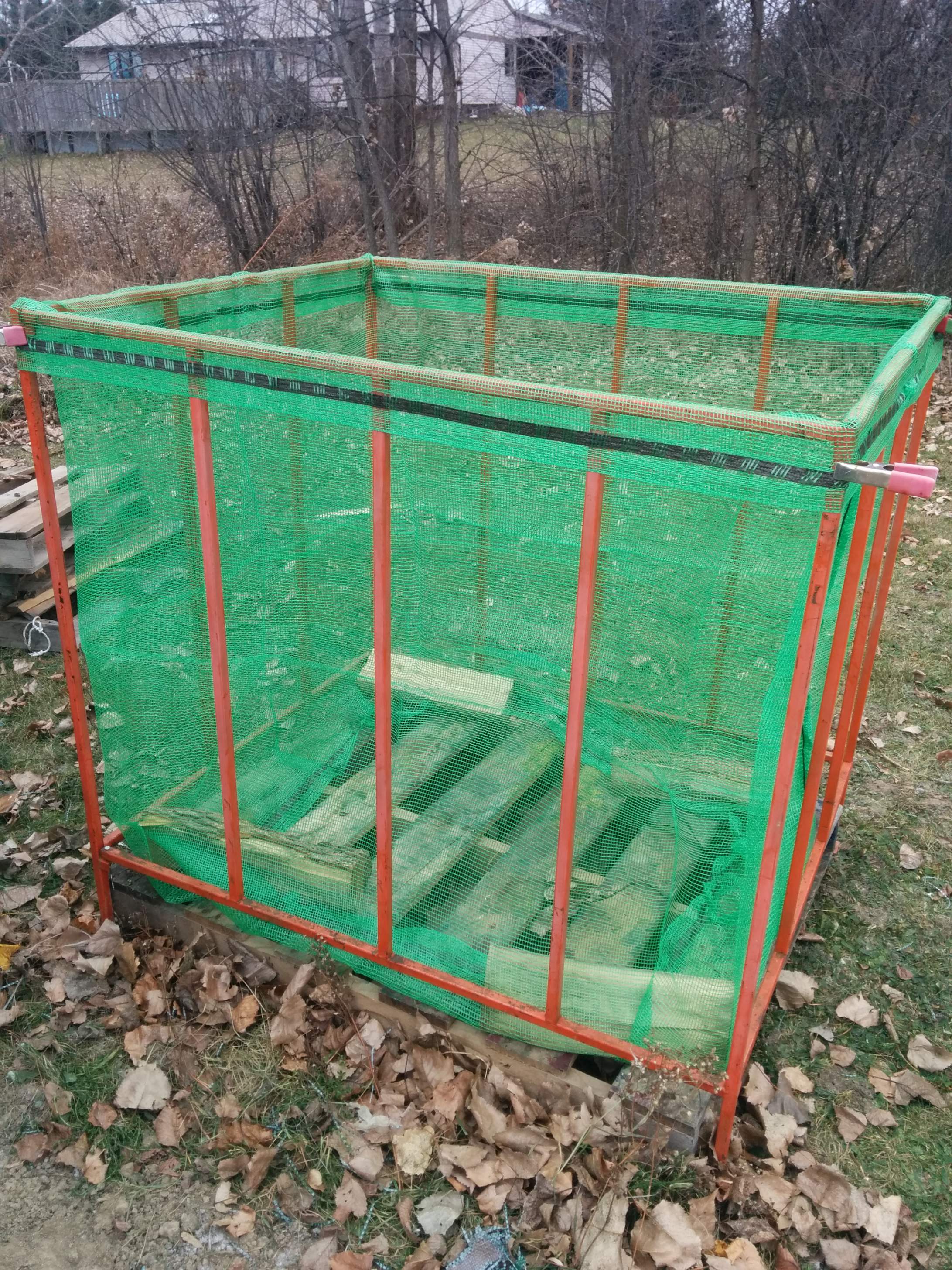

Don't know if I'd posted how I store firewood in this thread.

kiotiken;4070048]So I converted my old garden tractor dump trailer into an out shoot for the wood. I built a diverter flap and center divider so I could have it fill two bags without having to stop. I think I'll have to add a little extension to the end of it to really be able to fill two bags without stopping, but for now, I only have one frame and I just don't feel like building a second one right now.
I question the divider and diverting flap. Will the split wood log jam at the diverting flap then the next split start to destroy the diverting flap - center divider and out feed shoot???
Good job on the firewood processor build.
   / Firewood processor build thread
#340
I question the divider and diverting flap. Will the split wood log jam at the diverting flap then the next split start to destroy the diverting flap - center divider and out feed shoot??? Good job on the firewood processor build.[/QUOTE said:
LOL, this whole project has been a bit of try it out and see! I made the flap as long as I can, with as gentle an angle as possible, but it may well do exactly what you say, we'll have to see. I don't think it would work if I used the full width of the old dump trailer, it's too wide and don't think wood would have been pushed up the full length and into the bag.
