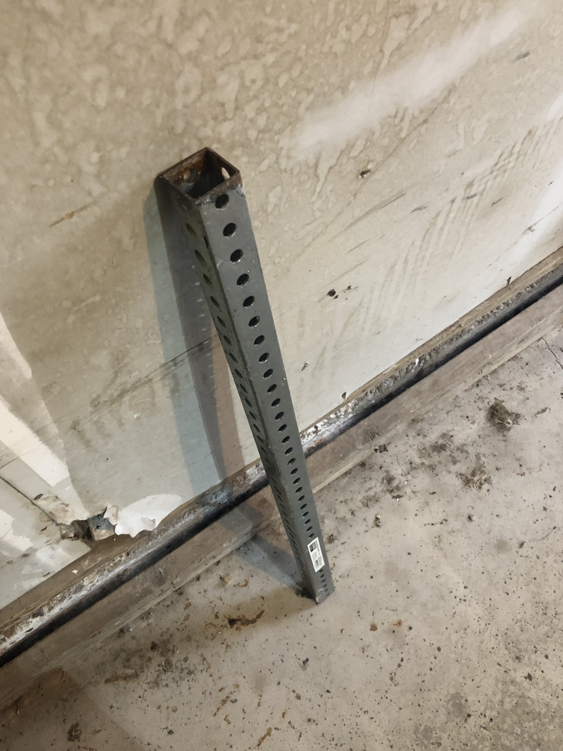

You don’t need a real breaker bar, just something that will fit over the wrench handle, and is long to give you leverage (4 to 5 feet is enough). A steel pipe, or something like that - look around your garage and see what’s laying around.
I use this:
