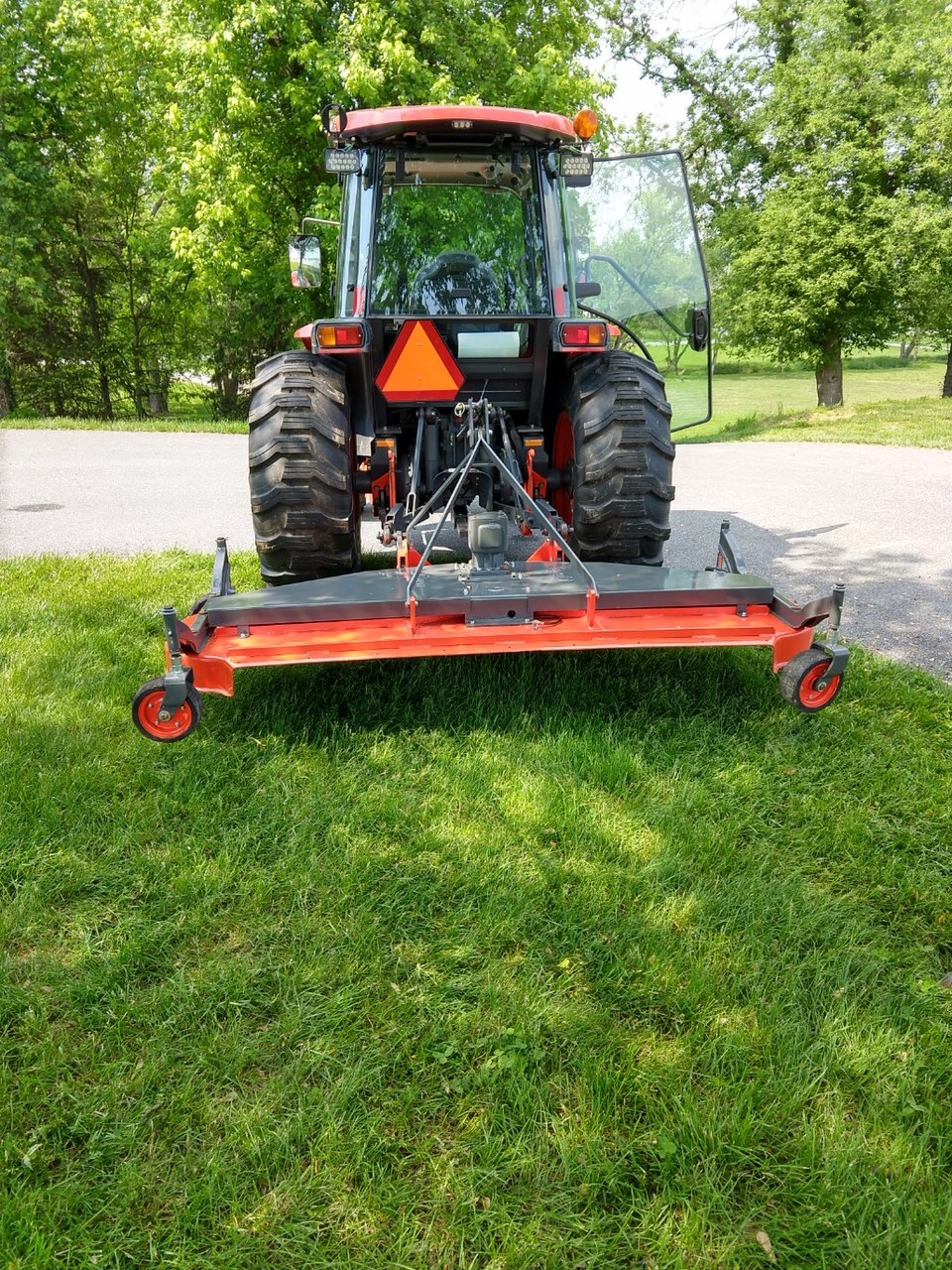

All good info. Lots of hours of experience in the previous posts. I will only add this: I opted for a craigslist find of a 3pt hitch finish mower [LandPride] and have never once missed the belly mower my previous Massey had. This mower has survived a couple tractors and is very easy to use/maintain. I have had little issues with maneuverability on my [currrent] Mahindra 2645. The mower is right side discharge. But I have always used a push mower to do trim work [I can use the walk]. COnsequently, I have NEVER taken the loader off for mowing.
