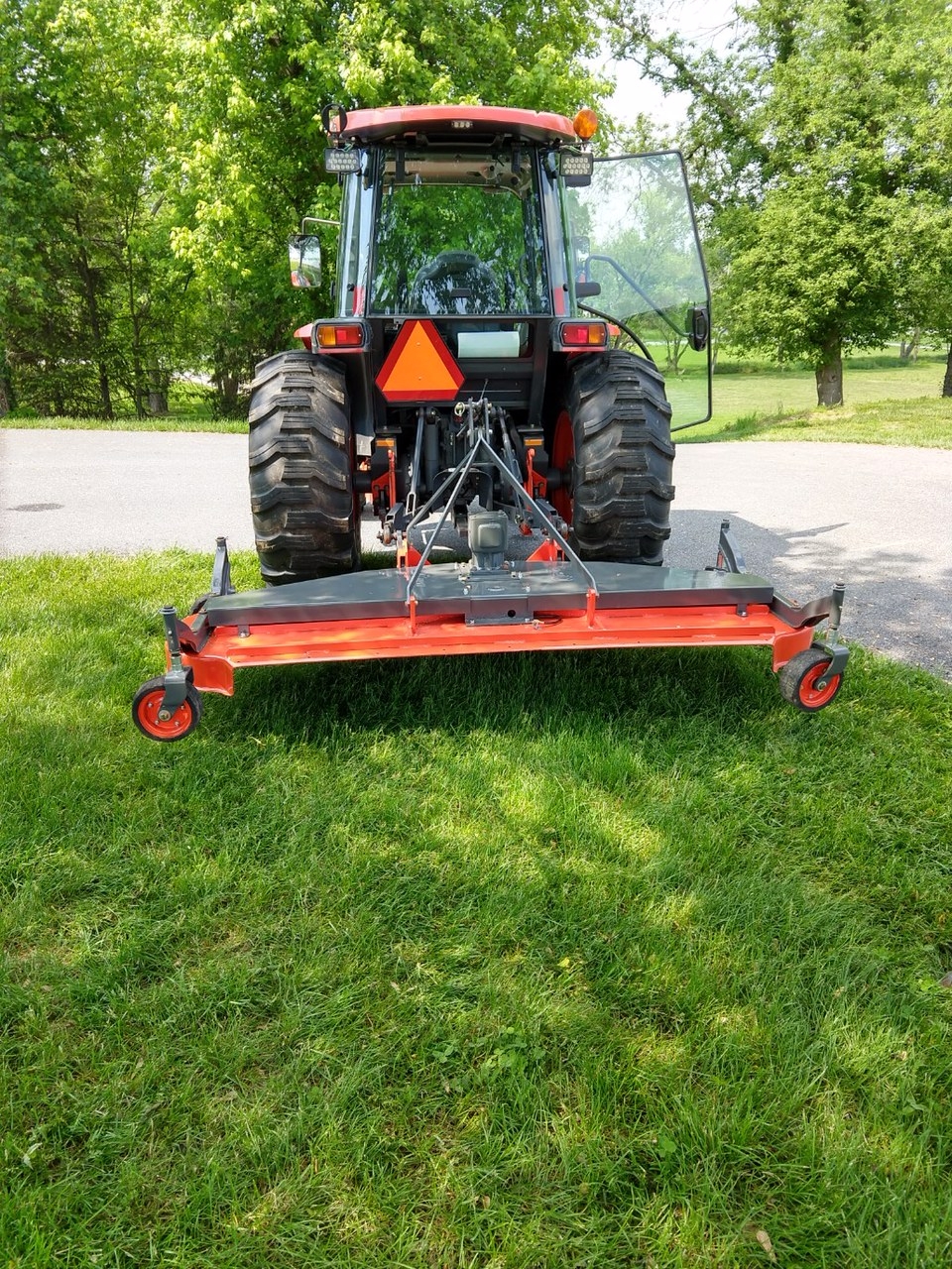

Here's a Google Earth pic of our place. 3-1/2 acres with trees, creek, sheds and a few other obstacles to mow around. Can do it comfortably in around 1-1/4 hours with a 90" rear discharge Caroni. The rear deflector has been removed and I never mow with the loader attached. I've had both side and rear discharge RFMs by LandPride and Caroni. This Caroni is a Facebook or Craigslist find that was bought cheap as a refurb project in early 2019.
The mowing pics were taken a year ago today and it rained a little while I was mowing, as you can see by the water droplets on the door glass of the one photo and wet tires in another. No clumps or windrows. The rear view of the RFM was taken about 6 months prior to the others.
