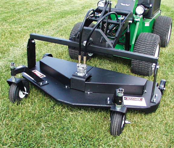

Could a finish mower be reversed and mounted on the of a tractor?
I know a driveshaft would have to be made to connect to my pto at rear of tractor.
If a winch was used to raise any lower it I would think it would follow the ground.
/ Finish Mower Mounted on Front? #2
If you have the hyd GPM's and pressure, you can drive a hyd motor driven deck.
You could also add a hyd motor to a gear box and move the 3pt finish mower to the front.
Here is a hyd driven deck, from Power-Trac.
8 GPM hyd flow.
Finish mower. --------- Rough cut mower.
8 GPM hyd flow.
JJ
What kind of power would be needed to provide 8gpm?
