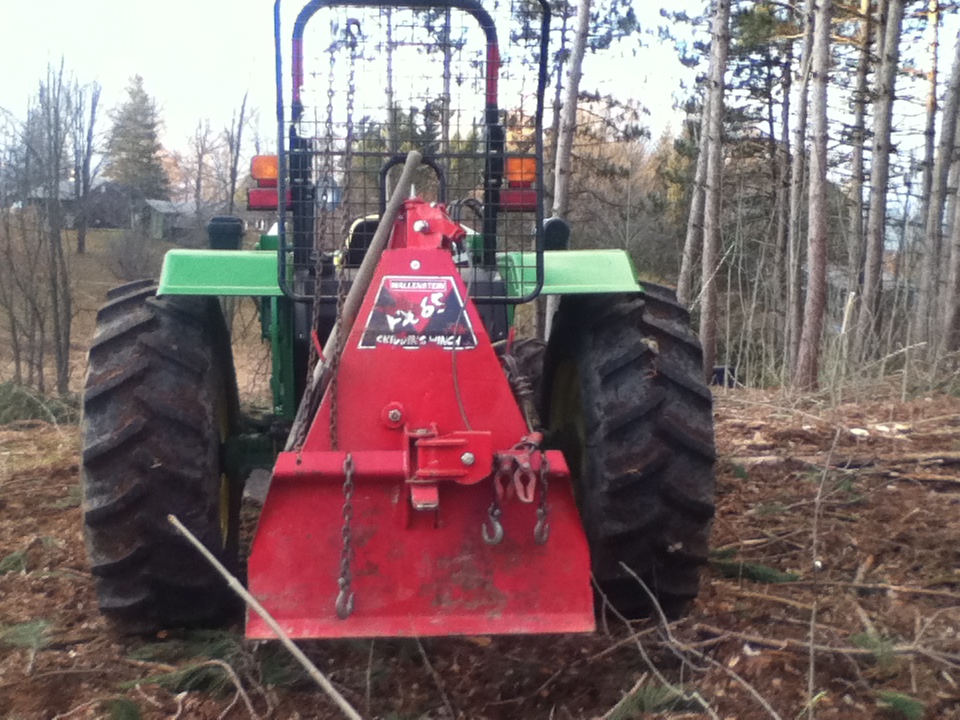

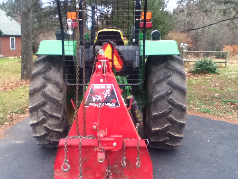

Here's before and after pics of widening the 5075 another 15+ inches
Feels like a totally different tractor.

Stability wise it is a lot better. I always try to run mine as wide as is reasonable for the jobs I do.

Quite a difference :thumbsup:
Did you have to turn the rims around and remount the tires or were you able to get that much w/o doing that ?

Did the same with my NH. HUGE difference. Should be done at the dealership before they are sold.

Do you notice the extra width in the woods? Going from a 4' atv to the 6' tractor has required alot of trail work at my place, but I need to run my tractor as wide as it goes for the hills.
Sort of, if you mean by swapping the left outer rim and tire to the right side and vise-versa. That keeps the tread direction the same and no bead busting required.
Yes, definitely noticeable squeezing through the barn door or on the paths, but a lot less pucker fatigue when working the FEL on a side hill to pick up branches and tips with stumps (surprise!). Which are going to get even sneakier bidding under snow.
