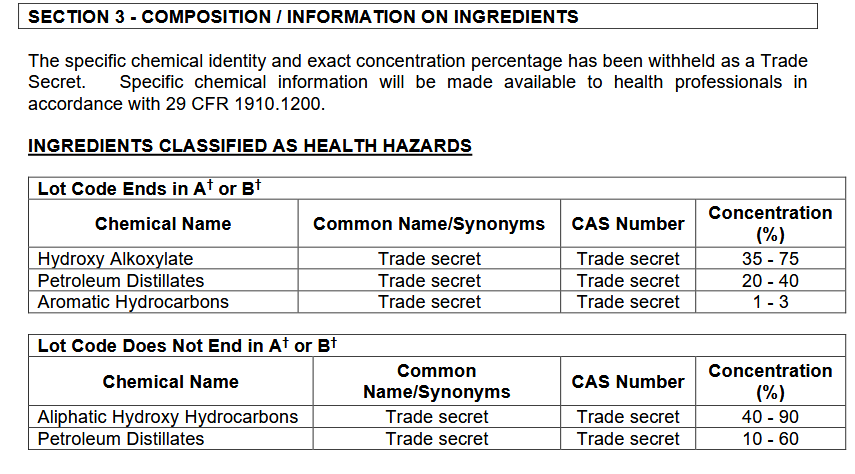

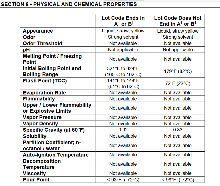

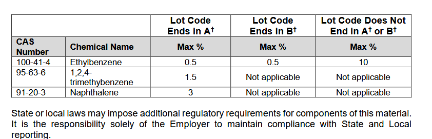

When using Power Serve 911, just think of gasoline with maybe a bit of lubricity added;
There are actually 3 variations of 911.
from the SDS;
/ Winter fuel
#48
/ Winter fuel #49
It's very light hydrocarbons, highly solvents and easy ignition. A great many years ago a touch of gasoline would be used in a pinch, certainly not recommended.
But either will eventually dissolve the paraffin particles that are what has dropped out of suspension in the diesel fuel.
