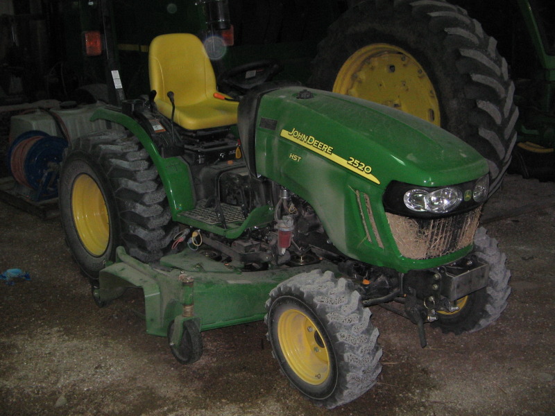

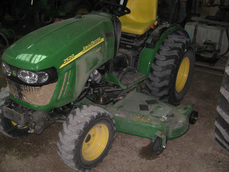

My 855 didn't collect grass near as bad as this one. I think the fan must pull more air on this one, plus this is the driest year we've had since the mid 1980's. I'd clean the inside screens on the 855 a couple time a year, this one seems to catch most on the outside.

I finished mowing yesterday and cleaned it all up. I moved the gauge wheels up an inch, that really helped when mowing uneven places. I didn't have to worry about getting hung up again. It'll probably sit a month now since it won't rain here. There's small chances next week, I hope we get it or I just as well use it to mow down my corn fields.
/ Finally got my 2520!!!! #26
You mowed another acre without cleaning that front grill? Apparently you have never overheated one. It happens quick and is **** on the machine.
Keep the front grill breathing heavy!
/ Finally got my 2520!!!! #27
John Deere sells a "Blow Out Kit" for their mowers. It is two thin metal strips that attaches to the bottom front of the mowing deck. You may want to discuss purchasing this option with your dealer's parts department. Installation of the "Blow Out Kit" will not completely stop the grille clogging but will greatly reduce the amount of debris being sucked up by the fan.
No, I brushed the grille off before I mowed, I waited till I was done before I washed the rest of it.
I wonder if they have pics of that on the parts site. Maybe I can make them. I don't think it would be as bad if we weren't in a drought.
/ Finally got my 2520!!!! #31
Based on comments in other threads, the Blow Out Kit is no panacea. In certain circumstances, with your deck at a certain height, it may reduce some of the material that "escapes" from the left side or front of the deck. It seems to be mostly recommended for folks that mulch or bag. I ONLY mow in mulching mode, and never have an issue with any material not staying under the deck.
Your principle issue at this point is most likely the extremely dry conditions. Once the rains come, the ground gets wet again, and you're able to drop your deck down, the issue should go away.
/ Finally got my 2520!!!! #32
I don't know if this applies to all decks. I have a 54" deck on my X748. I got the anti blow out kit to prevent clogging the air intakes. It did nothing for me. I took it off again becasue it made the mower harder to clean.
