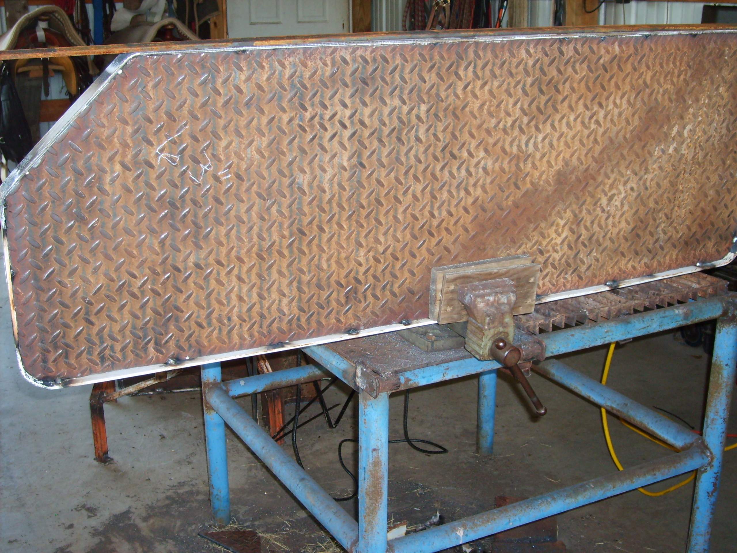

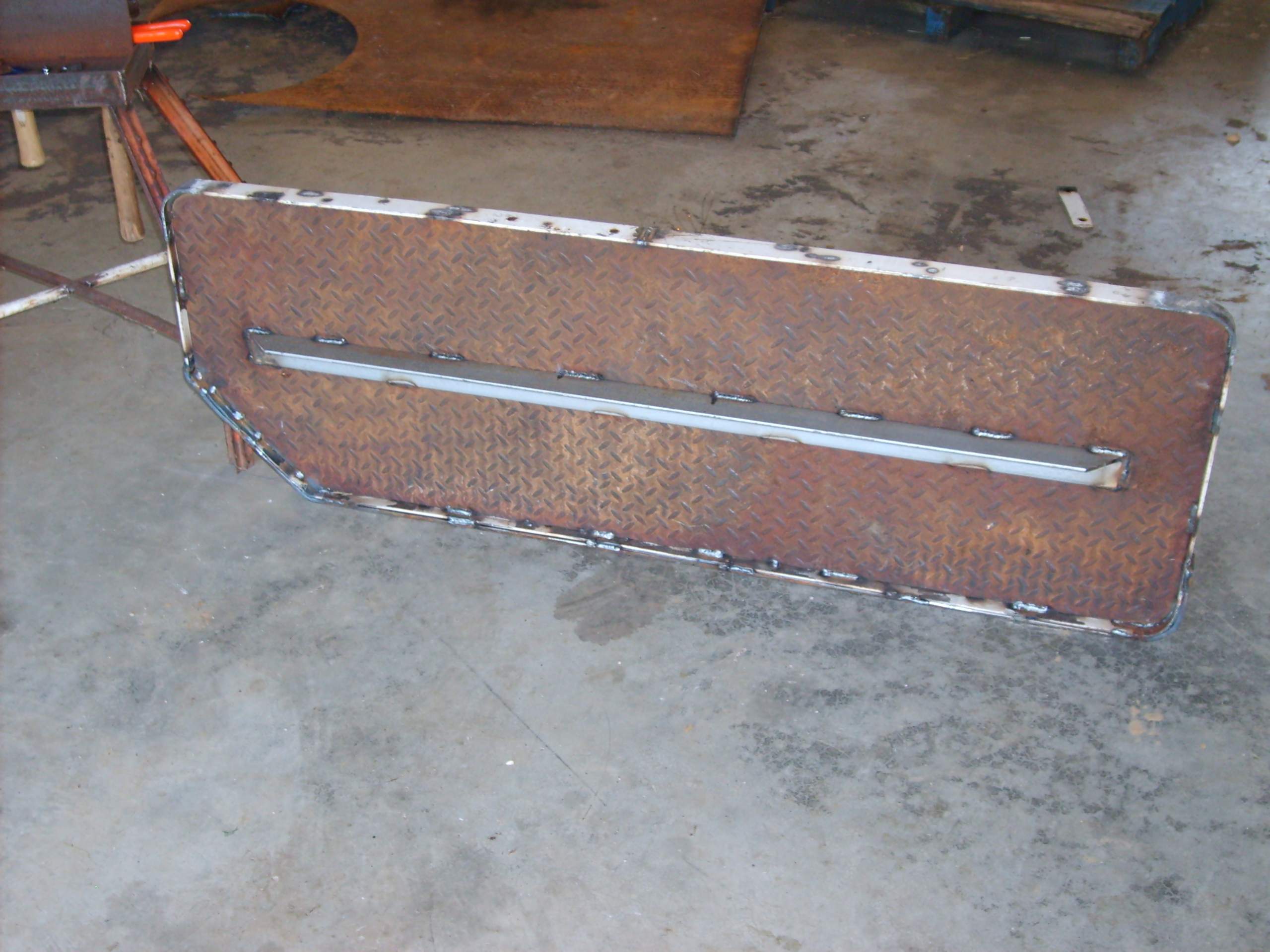

Very nice grader. You got exactly the results I'm looking for. I've had my side pans fabricated for a while now and the job took to the back burner for the fall season. I'm still trying to get my blades. I'm going to try another source. My plans are to build mine very similar to yours. So far I have $0 in them.:D I used 1/4" plate so I added a 2X2 angle to the side of the pans to give it a little spine.

Jay, looks like you have a good start. I had my first pan done for quite a while before I really got busy on the rest. It really wasn't that hard once I decided to get it done. You might try the State or County road maintenance crews if you are interested in the motor grader blades. They change them out regularly, and most of the used ones still have quite a bit of material left. I bet if you talk to the right person, you could get a couple of useable blades for free. I did.
