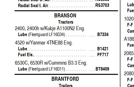

There should be lots of online cross reference guides; Baldwin Filters comes to mind as a great source. If all else fails, I have printed books that have all applications for drive belts, bearings and seals, as well as a bunch of filter and spark plug books from different brands.

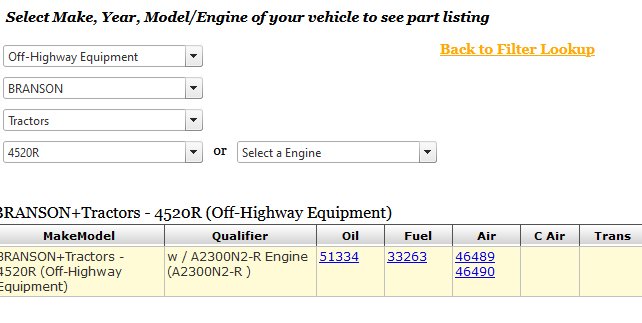

To get something from the local auto parts store, you'll probably have to go the back way, by finding filters on an industrial supplier site like Baldwin or Wix, then finding the common brand equivalent of them that the store would carry.
Neither site would deep link to the specific page, but they do have the relevant filters.
