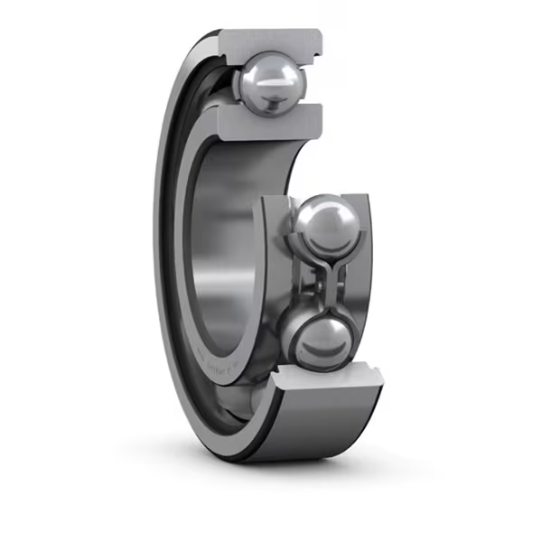

I see the 6208 & 6209 look like this, more or less:
they supposedly "accommodate radial and axial loads in both directions"

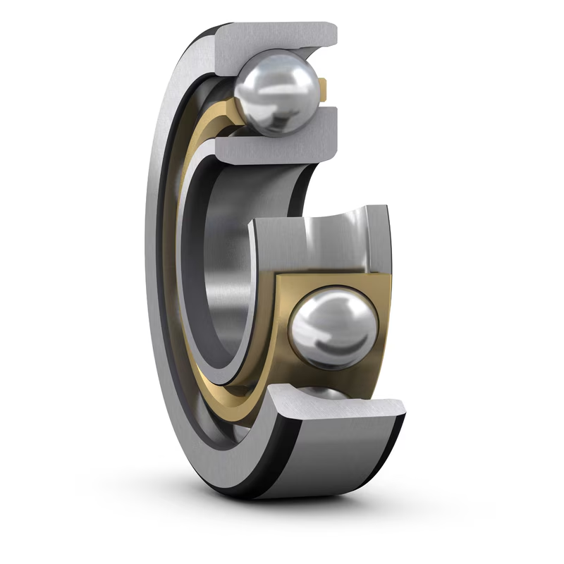

A particular "single row angular contact ball bearing" looks like
here there's obviously more of a shoulder on one side, which to my inexperienced eye looks like in this orientation it's going to support an axle trying to dip to the left (left down, right up)?
I'm curious why in the 6208 there's a slight dip top & bottom, while in this angular contact bearing there's a big shoulder on one side and absolutely nothing on the other, the cage

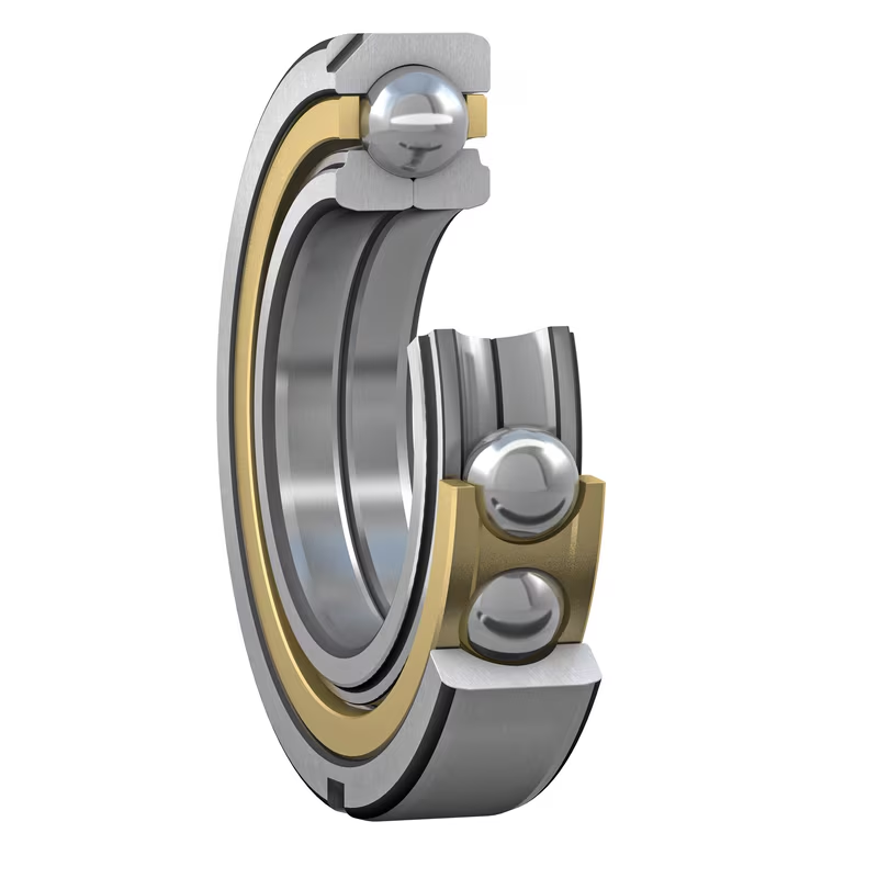

Then there's "four-point contact ball bearings"
these look to me like the recess in the outer ring is very similar to the 6208, and the inner ring recess is also similar though it may be two-part. How are these "4-point" different than the 6208?
Think about angular contact bearings just like the tapered roller bearings that you have on a trailer hub. You have two "facing each other" to hold the wheel in place. The tapered roller bearings, since it has rollers, will have much higher capacities.
The angular contact ball bearings, provide an angular ball contact area so the supports higher side loads, hence the name. These, much like the tapered roller bearings, needs two bearings working "against" each other to support the loads. As a single bearing, it will only support side load in one direction. They will literally fall apart if side load is applied in the opposite direction.
The regular ball bearings provide more contact area on "top" to handle high radial loads. These can handle a little bit of side loads but definitely not as much as the other options.
Those 4 point contact ball bearings, have a split inner race that allows them to support side loads in both directions. Essentially built like an angular contact bearing but can support loads in both directions.
Is the inner race split so that it can be deep enough for the side load support and still be able to assemble it?
/ 3625 /(20) front hub leak #12
Yes. That's exactly it.
