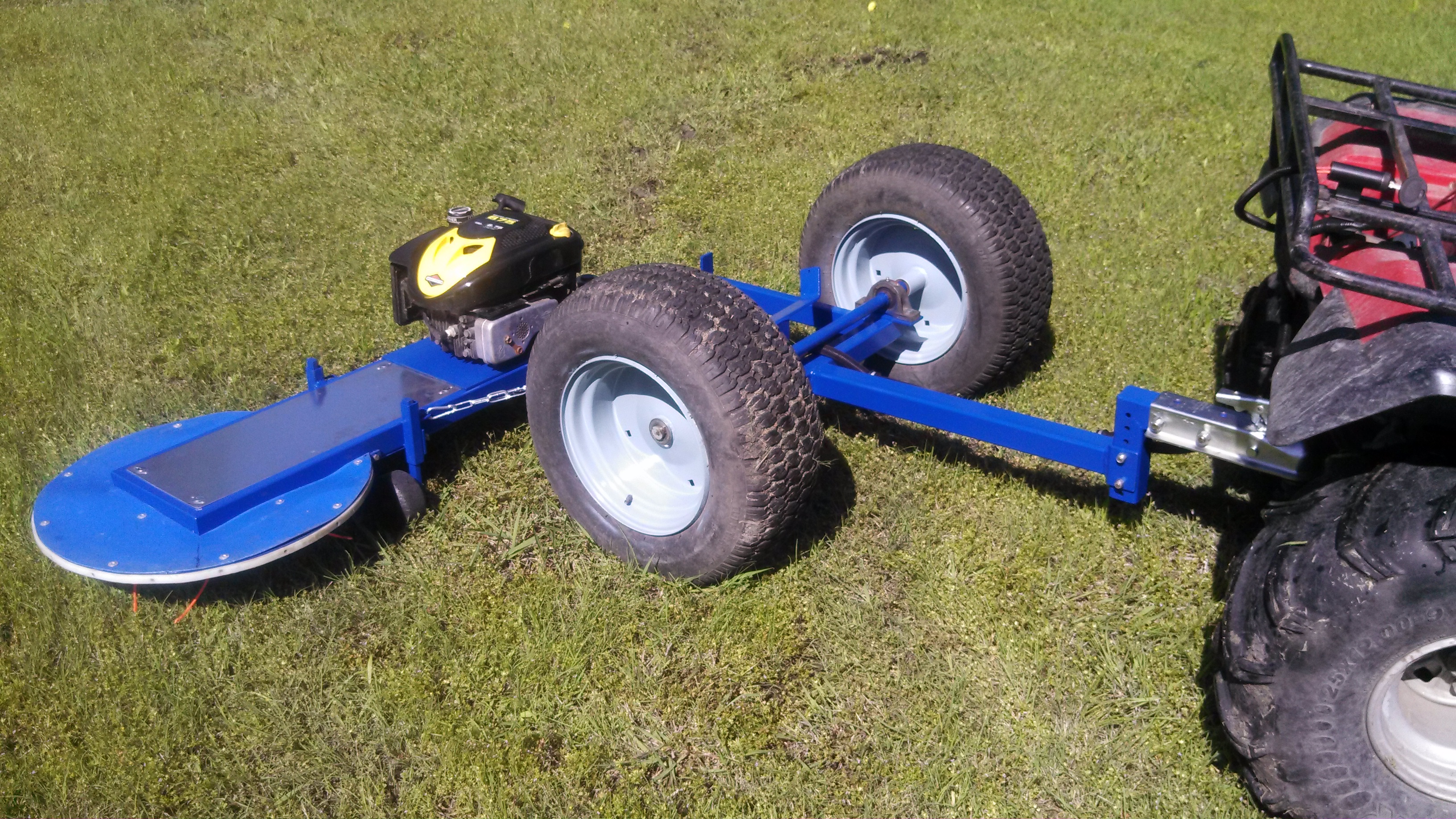

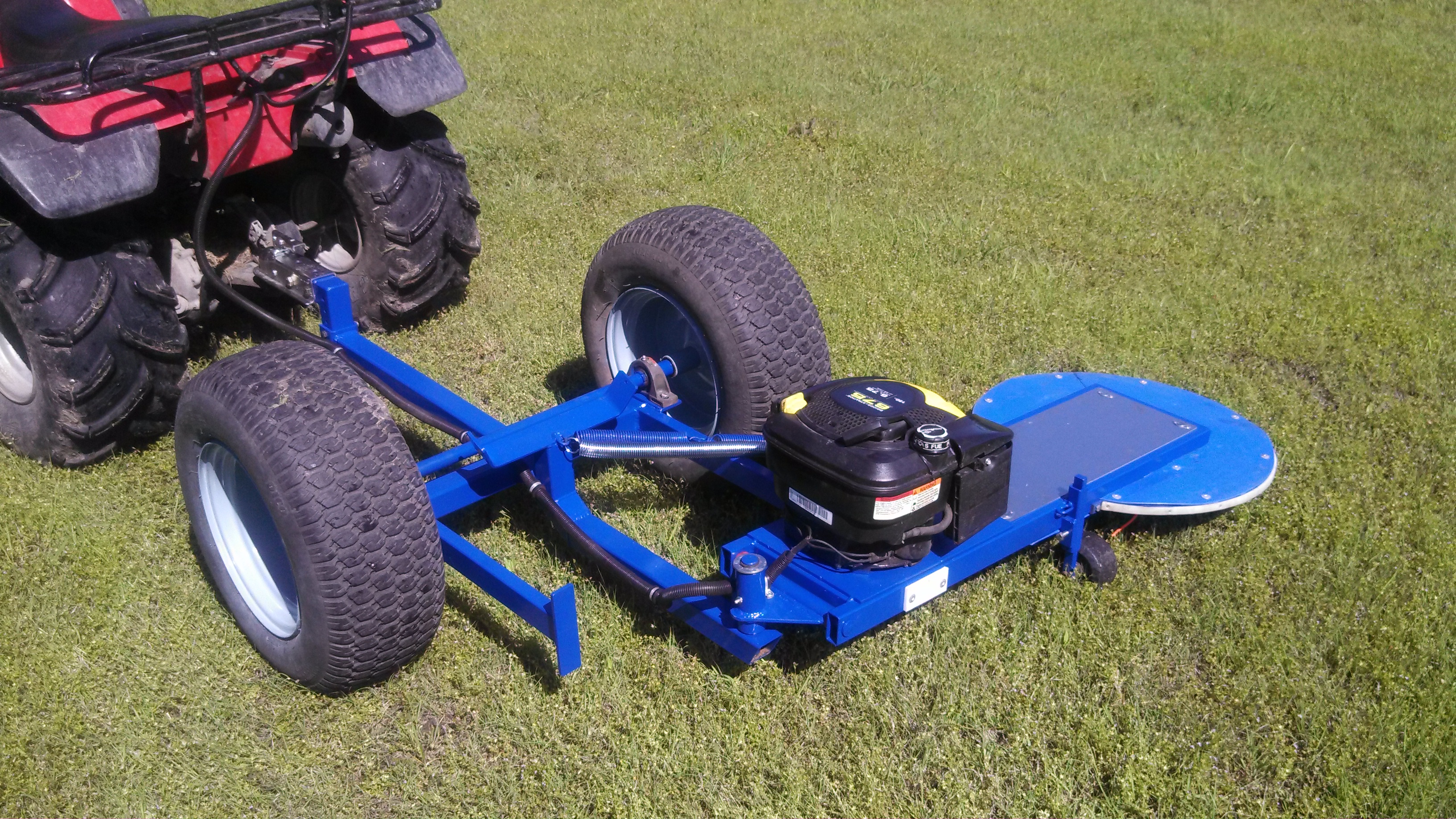

After running it for a few hours I made a couple of little changes then shot some paint and wired up the electric start.
So some photos of the end result, the last time it will be clean.
Looking again at your design, you have a vertical shaft around which the mower swings. I would have added a horizontal shaft that would allow the mower to move up and down to follow the ground contour. The weight of the engine would be enough to keep the small outboard wheels planted firmly on the ground.
Good luck.

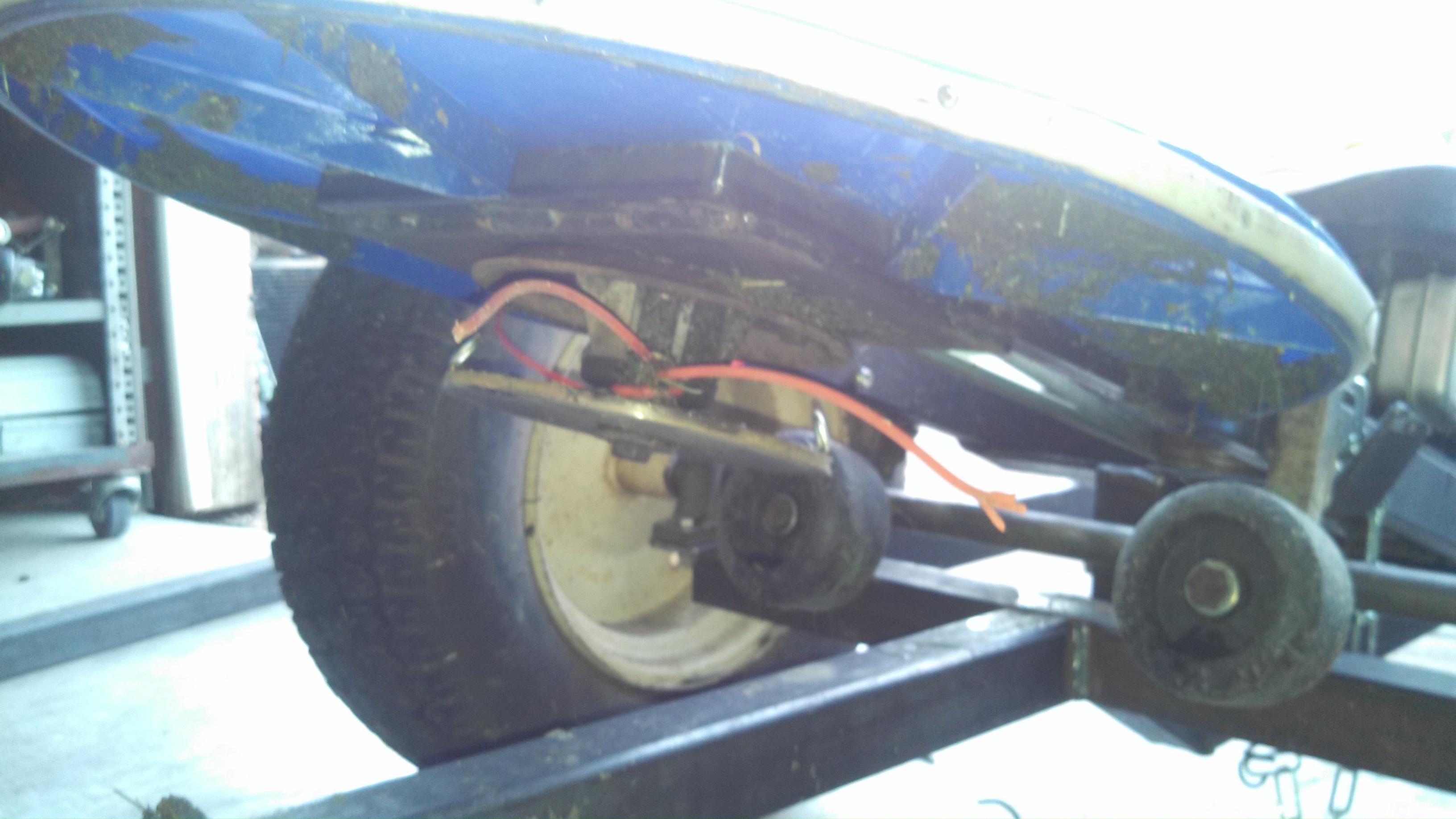

Flusher, look closer - next to the vertical shaft there's another pivot point, that's how JW gets the whole thing over the tires to swing out - then there's 2 small wheels it rides on as you suggested, plus a "rebound" spring so it can retract when hitting a post.
VERY cool design JW... Steve

Yes the vertical shaft is 1" and has bronze bushings for rotary motion the vertical movement is in the same part the 1x2 tubing is a clevis and polyu bushings I had.

I like your set up, does the cutter "slam" back when going around the post, first I do not have a 4 wheeler, or a small tractor, so I would need a little larger unit, but like the simplicity and lightness, of the design.
any problems with the little wheels digging into he dirt, I would think with my sandy soils they would be dug in to the dirt all the time,
/ Fence line trimmer #26
It does, cut 19" and loop it around a link of chain, welded to the hub. The two I have use two strings but I welded 4 links to this one (only used two of them) to the head to see how it worked.

I used a spindle, pulley and cut the blade down so I had drive splines that connected to the shaft. All of those came off an old MTD riding mower deck I had at the farm. The "cutter" is just a round disk with bent chain links welled to it and then welded to the "keyed" section of mower blade.
