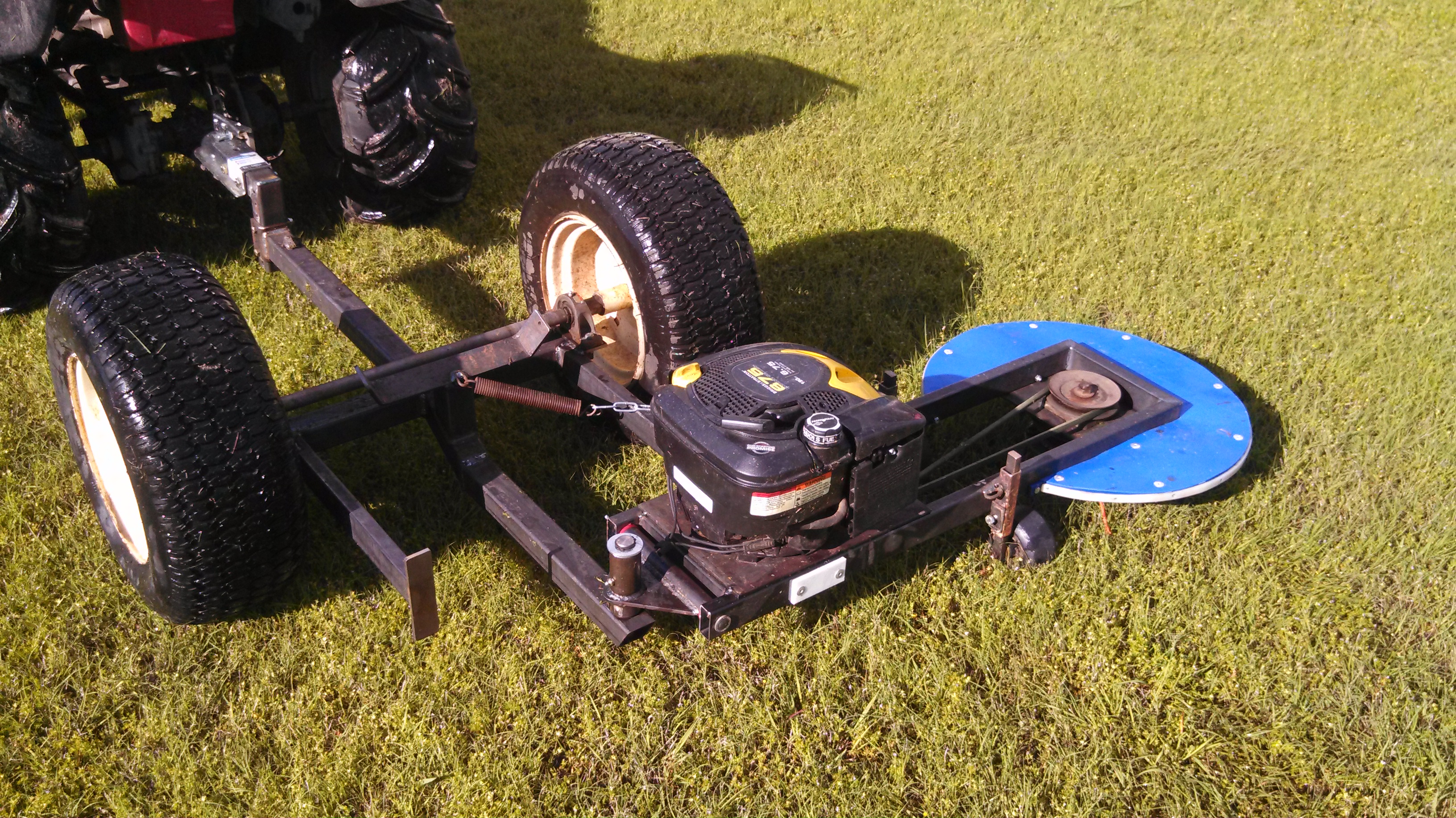

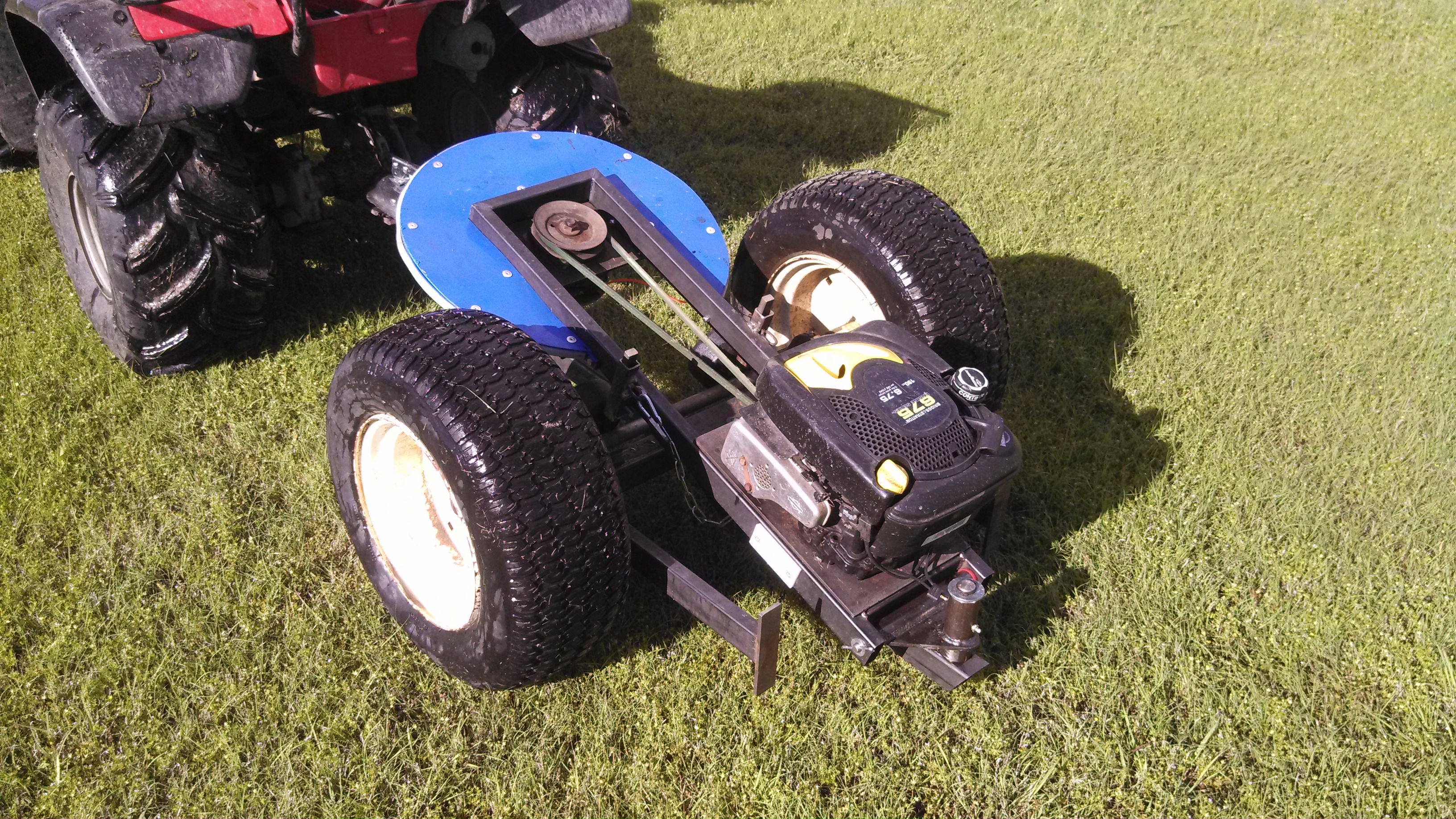

After the last try helping my Father out with trimming under electric fence I built another that could work for both of us.
Works like the 22" string line trimmers I already have but I can trim 20 yards in 16 seconds while driving the 4 wheeler.
I had to buy a $22 belt and picked up the electric start motor from craigslist for $25, the rest was stuff I had.
Still have a little more work to do but the test run looks like it works OK.

That is cool. Does it use trimmer line and how does it attach?
I have miles of electric fence and this would cut down on manual trimming. I currently use a Stihl FS130 and Shindawa something-r-other with steel blades and two high school age guys.
/ Fence line trimmer

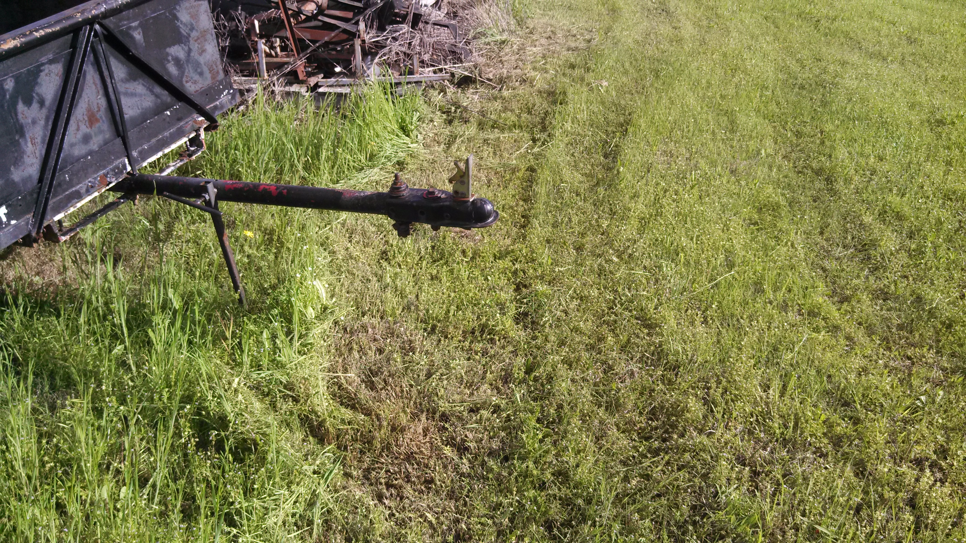

It does, cut 19" and loop it around a link of chain, welded to the hub. The two I have use two strings but I welded 4 links to this one (only used two of them) to the head to see how it worked.
I have a video of it in action but its too large. This is an example of how far it will cut under an object, as you drive by.
I really wanted it on the front but it was less work to make it attach to the other things we have via 2" ball vs custom mounts on everything.

That is one really nifty trimmer. I don't trim long stretches of fence line - the neighbors cows take care of most of that. I have a Stihl FS350 and just about every darn "head" they have ever made for it. My uses for a trimmer eat even the heaviest line like a kid eating candy. Finally I developed a solution for mine. I have a "head" that uses three, free swinging nylon blades. I took one of the nylon blades to the local welding shop and they made me several blades out of high carbon steel - exactly the size & shape of the nylon ones. These blades will cut anything - except rebar, as I found - up to one inch saplings.

The cutter head is the drop from the 1/4" plate when I cut the hole for the engine 7" in diameter. Then bent 4 links of chain into "L" to give more area to weld. Then welded a cut down stub of an old mower blade to it as it is a spline attachment for the drive.

This is a better photo, I actually used silicon bronze rod and TIG'ed the two together.
