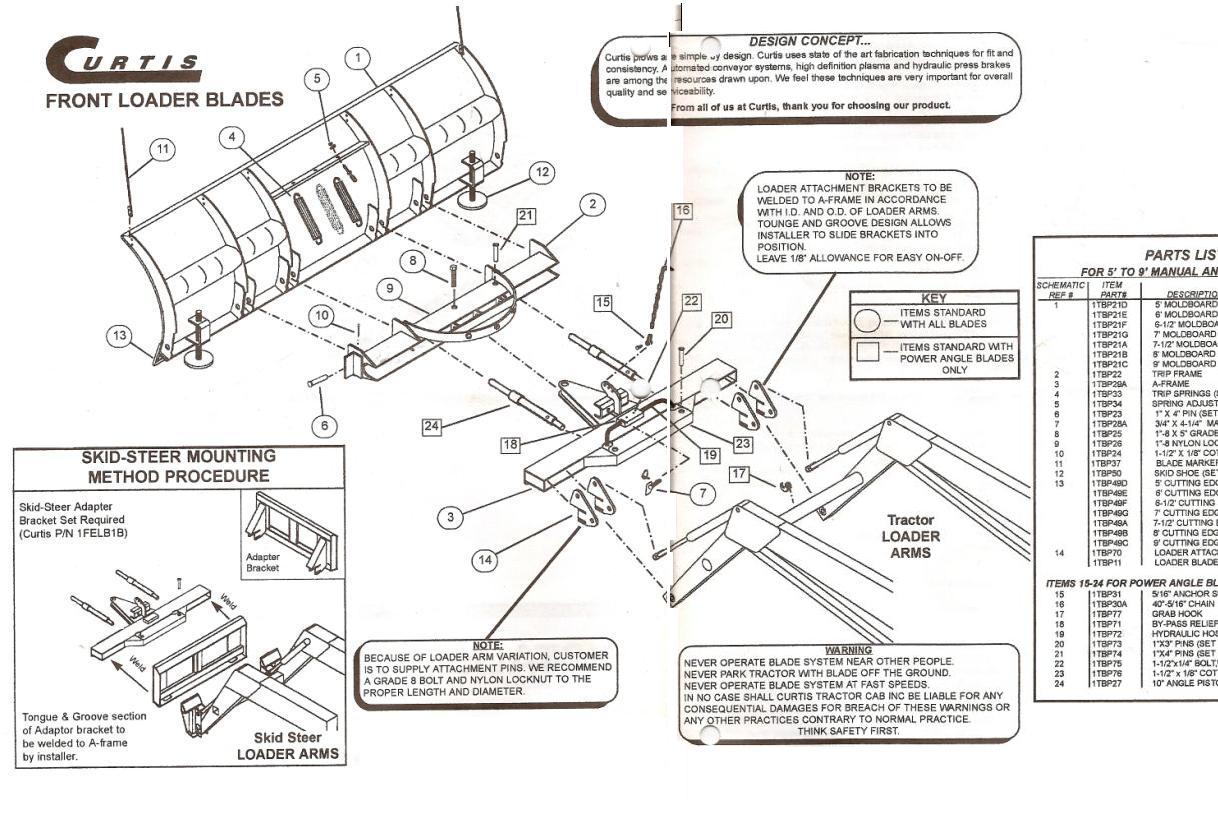

I recently purchased a used FEL mounted Curtis snowplow for my Kubota B7500. I have it all hooked up and did a little testing, granted it was on my dry asphalt driveway, but I am a little concerned. When I was pushing along I got a lot of chatter from the blade, made the whole tractor shake. Not sure if this behavior will go away once I have the weight of pushing snow and also the lubricating factor of the snow. Also with the plow weighing around 400lb and the weight of the loader arms when in the float position I have to be close to 1000lb pushing down on the blade. I'm considering building a ladder sub-frame that would either attach to the MMM pins on the FEL frame and a bracket that would be fabricated off the front frame of the tractor and then attached similarly to how it would be mounted on a pickup, or should I stay with the FEL mounted setup? If I go with the ladder on the FEL frame would you use the MMM mounts which are welded on behind the FEL frame or would you weld new ears to the front of the frame, the existing MMM ears look pretty stout but I don't want to bend or break them. Let me know your comments for either setup, I don't want to be going through my first snow storm and be unhappy with my setup and start fabricating the frame in the middle of December.

I saw your other post with the diagram of the Curtis blade. If I understand that drawing, you should be able to lift the weight off the FEL arms slightly, while allowing the chain on the blade to still hang loose. That takes most of the weight off the blade and still enable it to float independent of the FEL arms. You might have to roll the bucket a little to find the sweet spot. It would also help you retain front wheel traction by putting more weight from the loader back on the front axle.
/ FEL snow plow vs frame mounted
The way it's currently set up the chain is not used, the bracket #14 in the drawing connects to the loader and bucket mounts and makes it rigid with no floating action except the loader arms, no hinging action for the blade. I can't see how you would set up the chain? BTW this came off the exact same model tractor that I have but that owner had never used it so he was not able to comment on how well it performed.

I see what you mean now. I looked closer at the frame area. I have seen others use a chain to hold the blade and allow it to flex upwards, but that style frame looks solid. Sorry for the confusion.

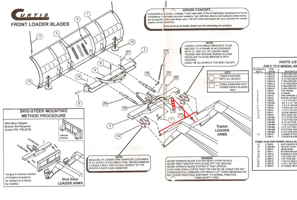

I was doing more thinking about this and what if you mounted a "T" lever on the FEL torque tube, cut off the tilt ears on the plow mount, connect the tilt cylinders to the "T" and then have a chain on the end to lift the plow. See illistration. Opinions?

I have had one of these blades for 4 years on my B2410.
I don't agree with your assessment of how much downforce you have on the blade when you are in float but I do agree that the blade is a handful for a CUT. The other issue is that there is no vertical pivot from side to side.
I wound up placing all of the washers from the skid shoes on the left side, when the blade was angled.

It looks like this plow has adjustable skid shoes. What I did when I had the Kub hyd angle plow on my B7610 was to lower the skid shoes so that the blade was about 1/4" above the pavement. When you start to push snow, it seems to push the blade down enough to get a good clean scrape. No chatter and no problems.
I realize the Curtis and loader arm arrangement is different than the Kubota Quick Hitch set up. But the skid shoe adjustment still may be the easier way to a smooth operating plow.
