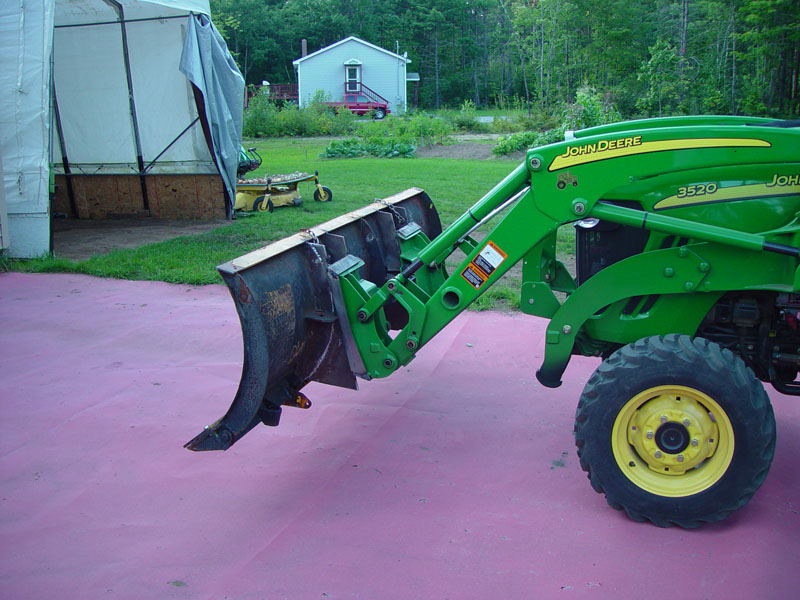

The blade will be something like this one. Just down sized a little.:)

No ability to angle it? Wouldn't you want that for plowing snow?
   / FEL Snow Blade Build
It would be nice to angle it, but to be able to do that I would have to bring the blade out at least 1 foot infront of the loader arms. Iam a little woried about putting sideways pressure on the arms, I don't want to tweak them. I figured this set-up is not any different then using a bucket, so it should'nt put anymore pressure on the arms the the bucket. What do you think???:confused:
   / FEL Snow Blade Build #8
You will regret not being able to angle your plow.Set up like that is not that much different than just the bucket.
   / FEL Snow Blade Build #9
You definitely want to angle it. It will not stress the loader arms that much. I fear you will regret not doing this from the start.
   / FEL Snow Blade Build #11
If u don't want to angle it just build a "snow pusher" which is basically an oversized blade with wings.

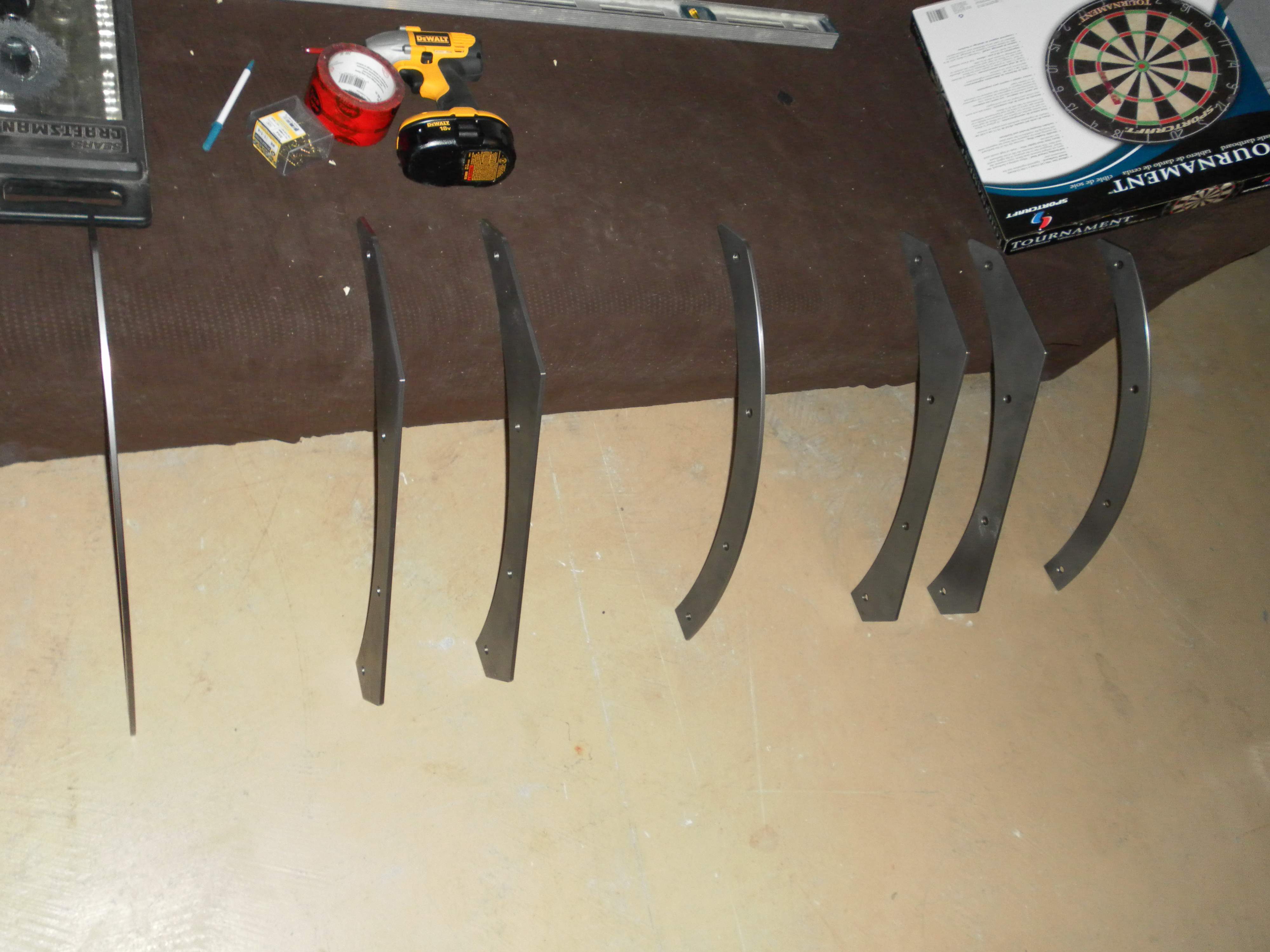

I will see if I can give some advice here without getting jump on again. You need to come up with a way to float the blade. Using the loader float position is no good because the weight of the FEL is to great. Look at how the blades are on the P/U trucks, hooked with a chain so they will float and bounce over obstruction they can not move and ones buried in the snow that they can not see.

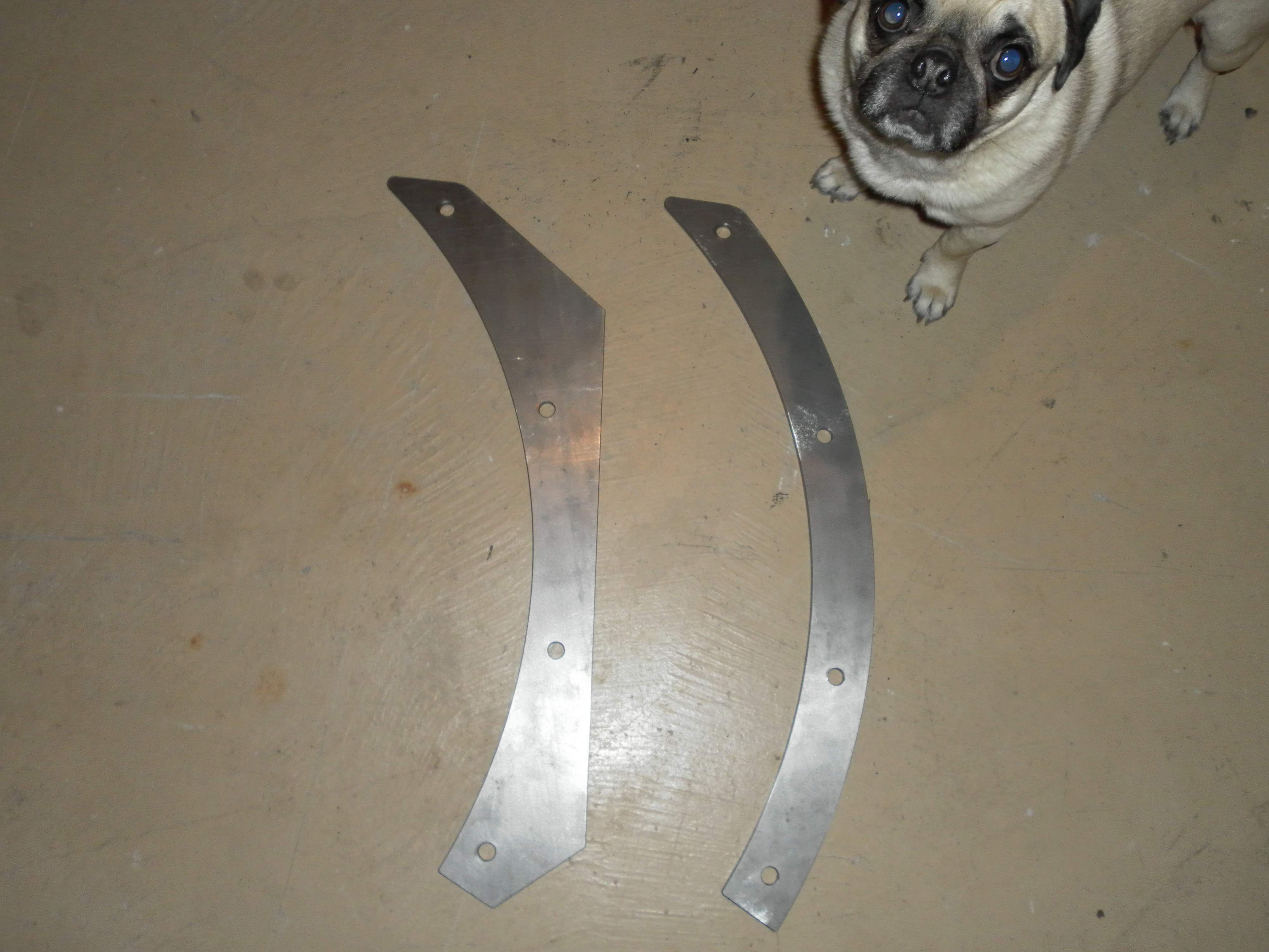

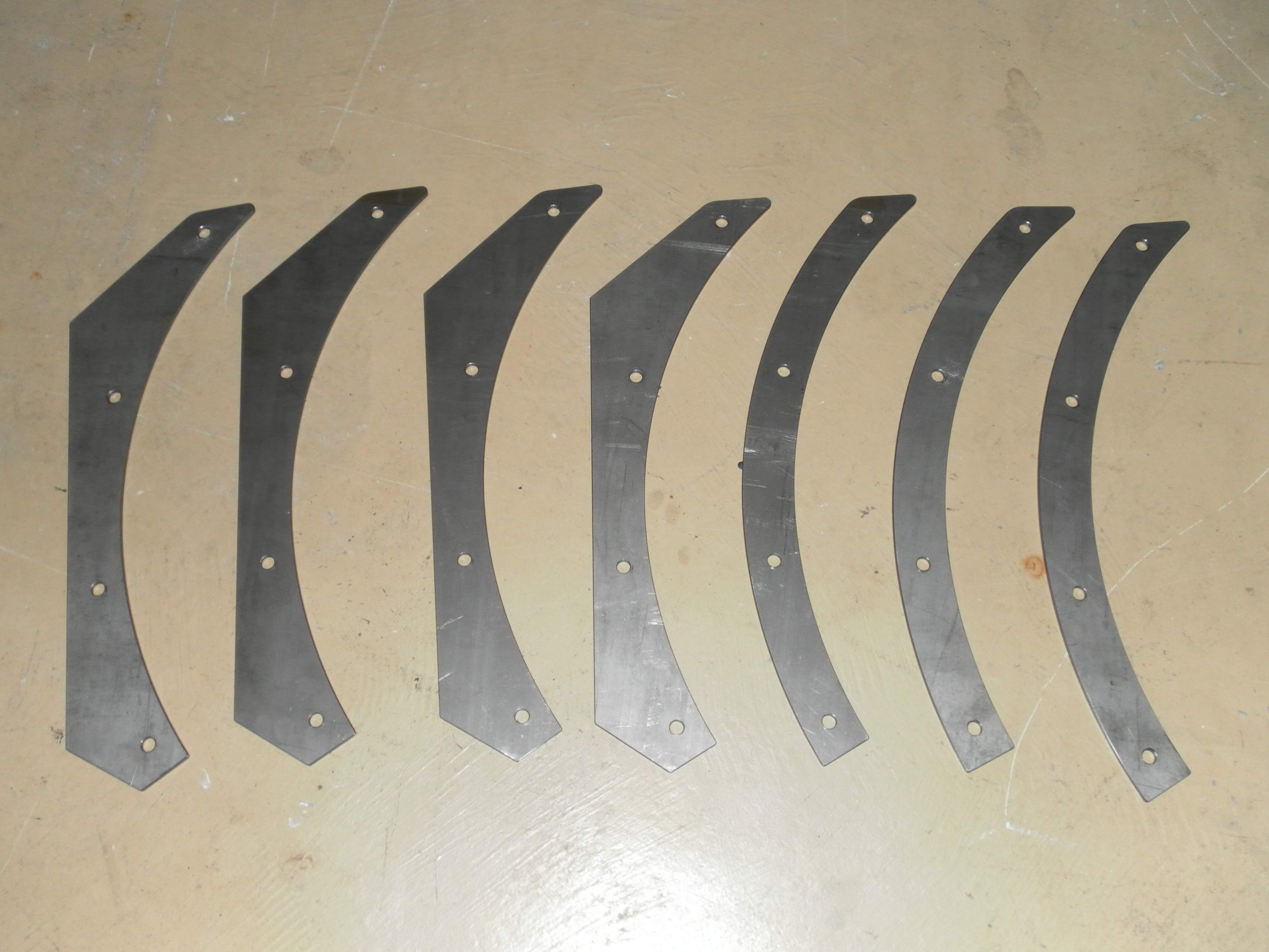

Here are a few pics of the blade supports. Actual blade is being fabricated as we speak should have it early next week.
Yah I totally get what your saying...If I would be doing unknown territory then I would definitely do what your saying but since I only doing my laneway and maybe a couple of neighbours I decided to make it solid mount. I think a turtle move faster then me when I'm plowing unknown areas.:laughing:
