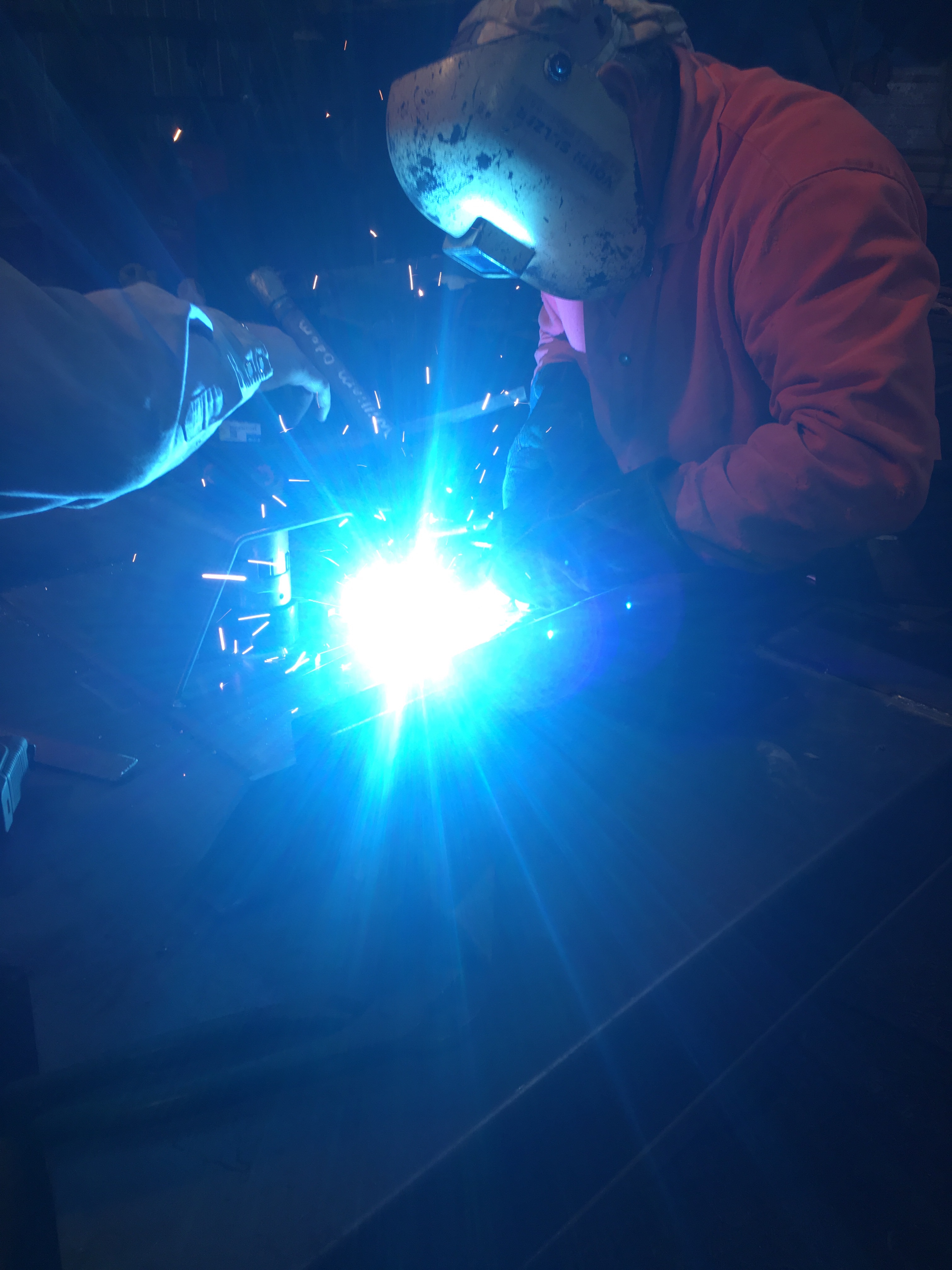

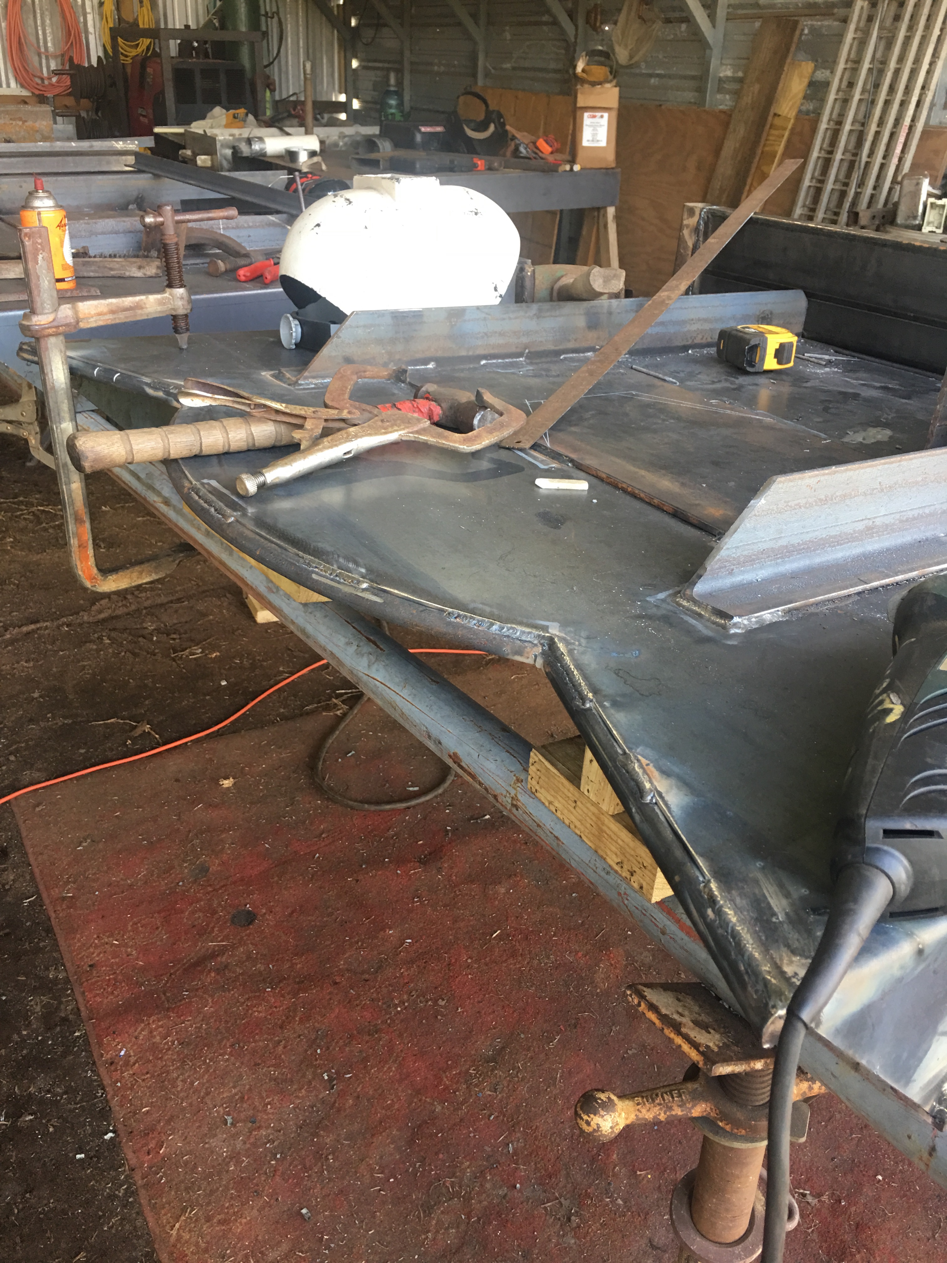

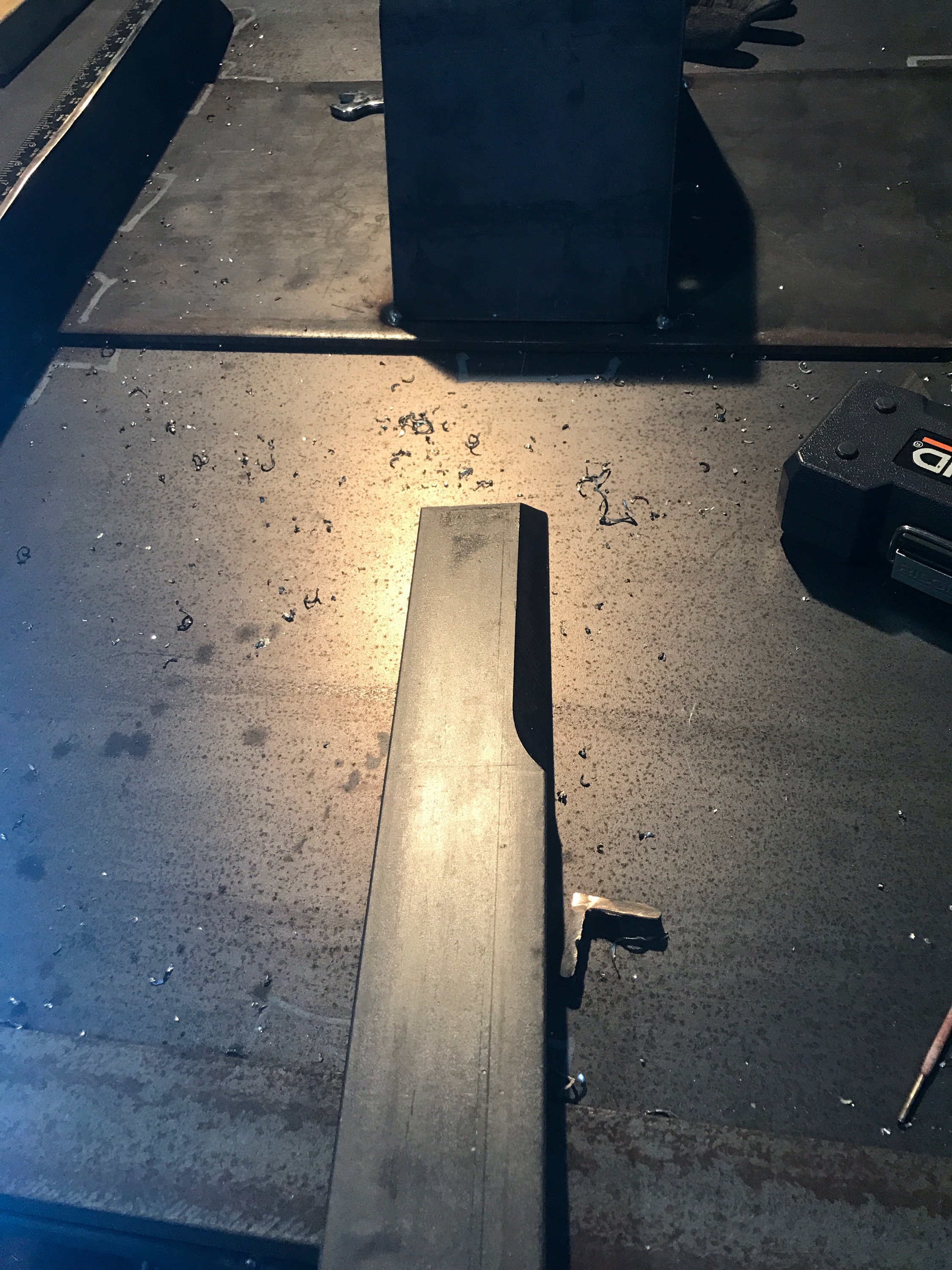

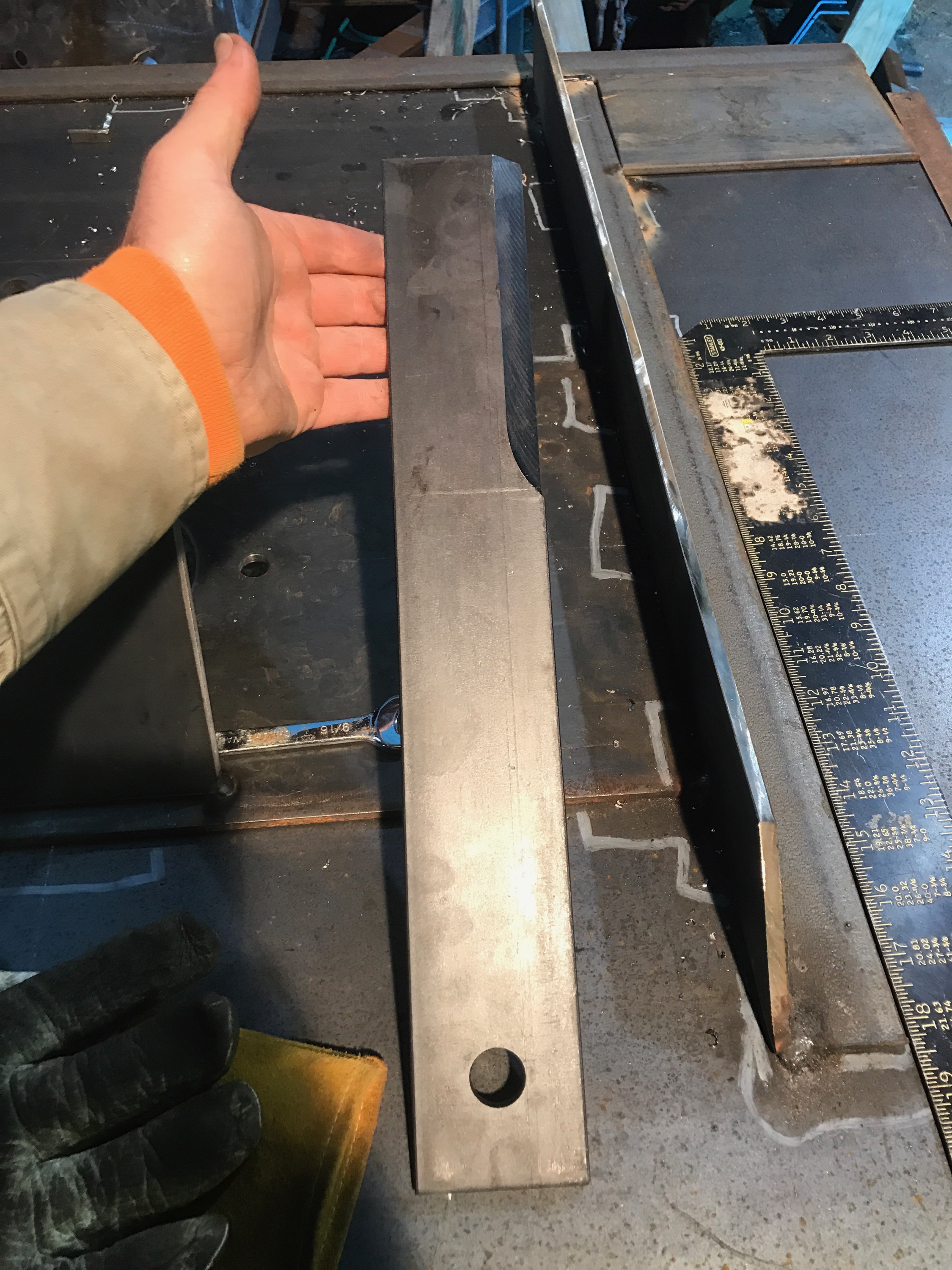

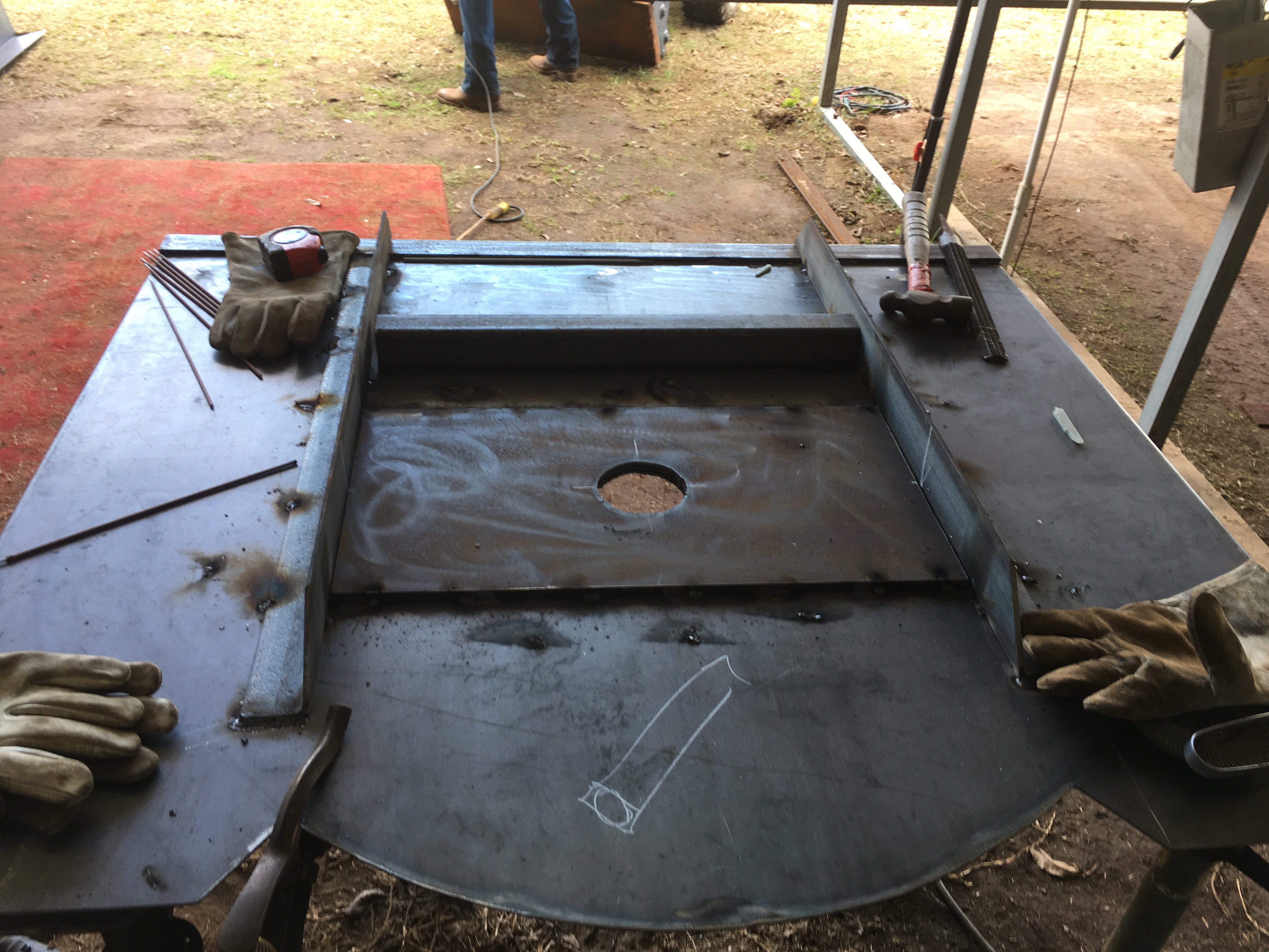

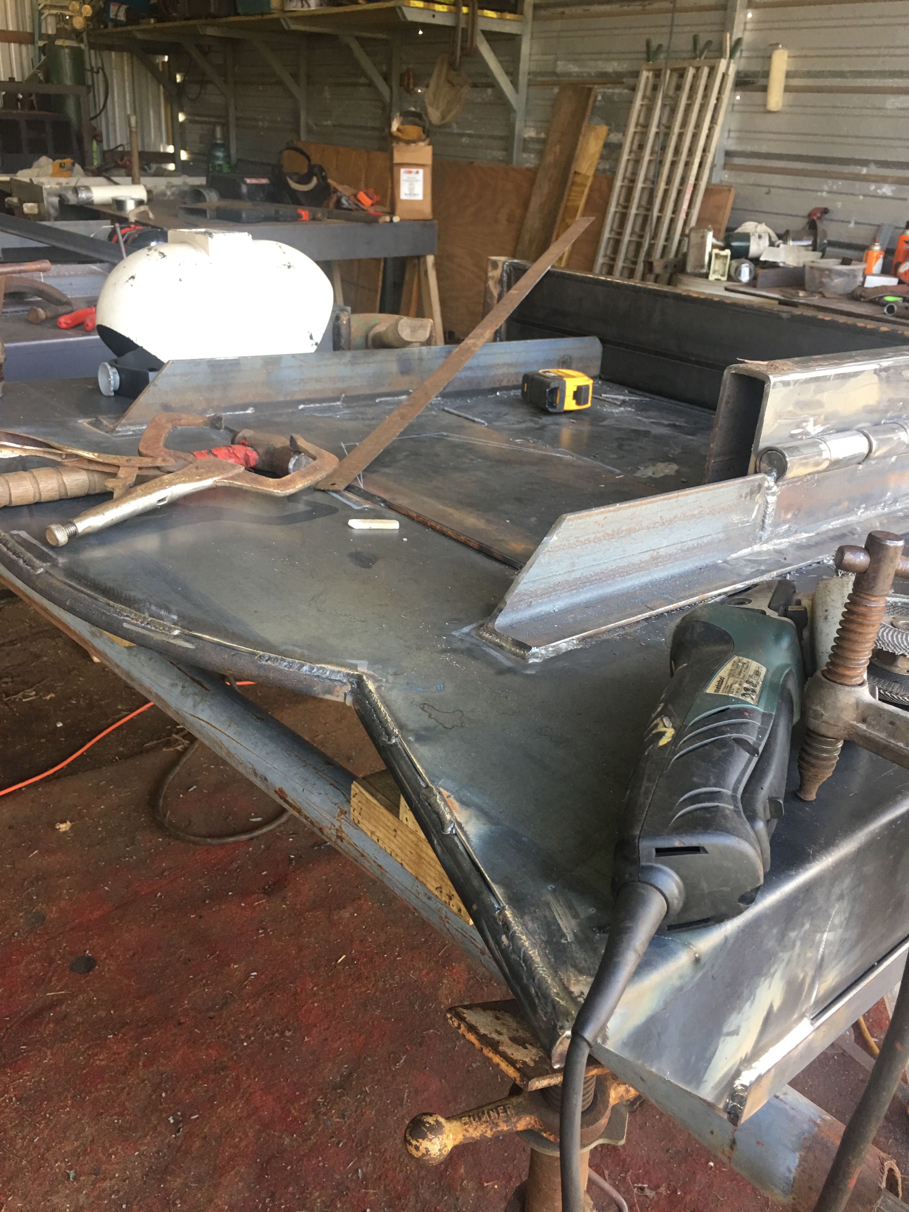

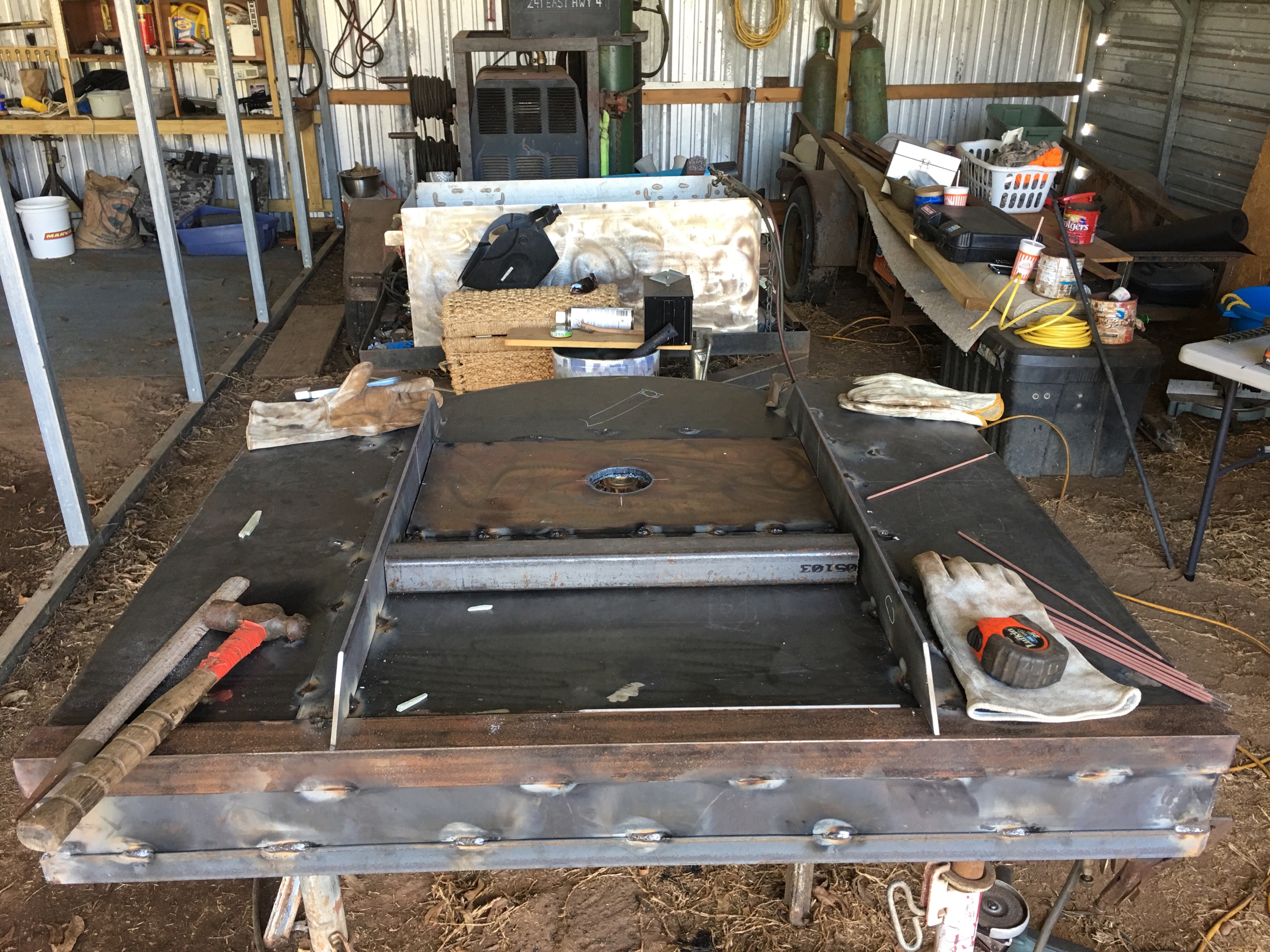

Here are some pictures and a video of our custom 5/16" SSQA plates being cut.

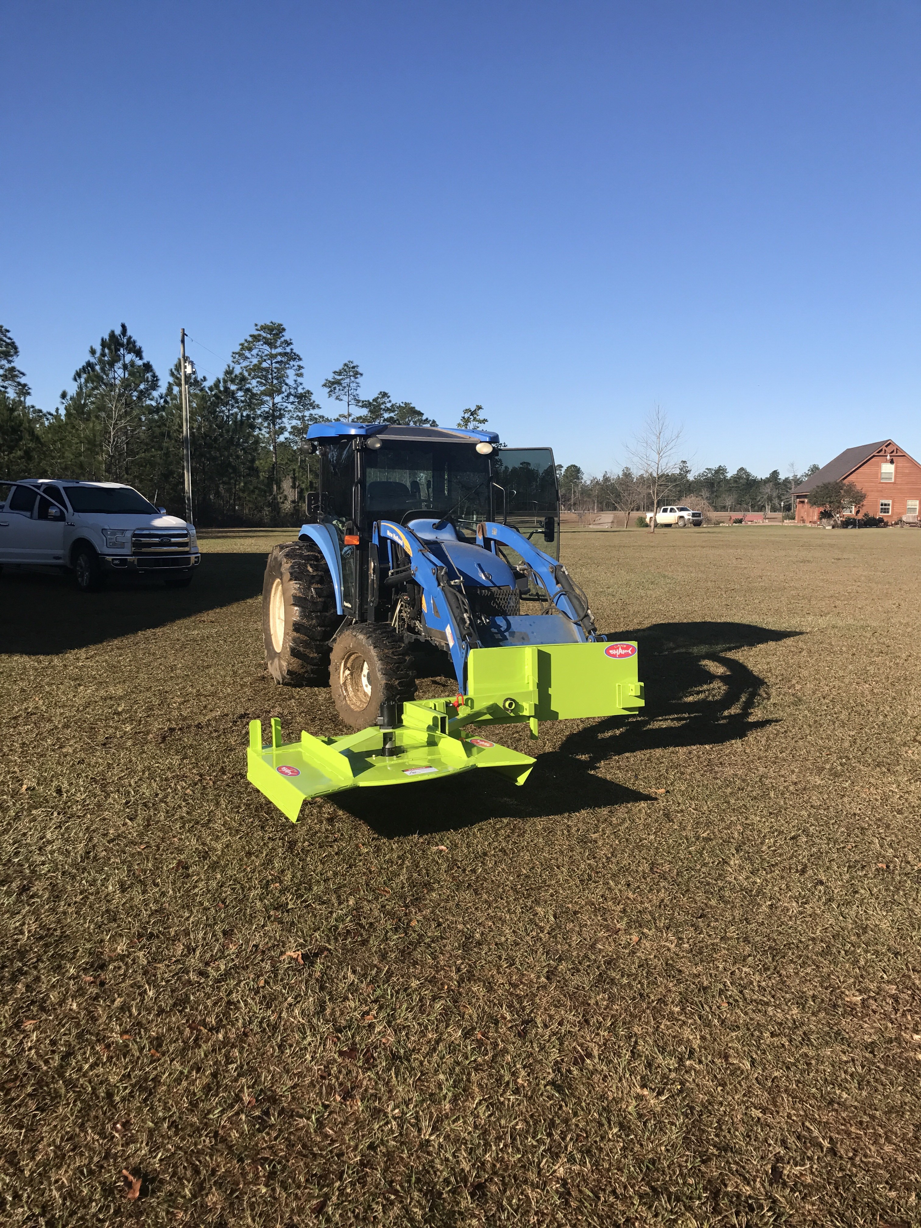

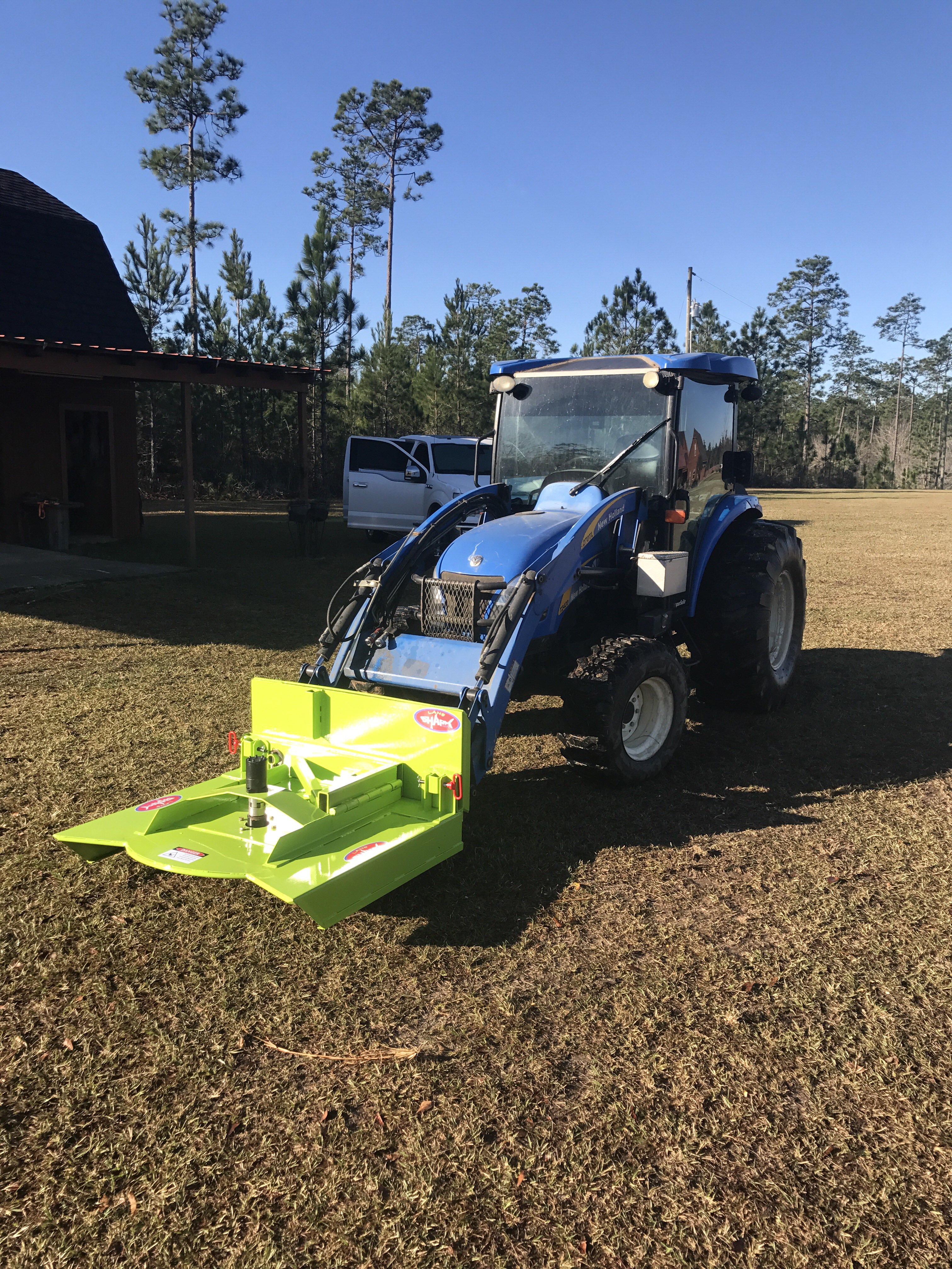

The deck is not thicker because it is built to hang off the side of your FEL while it is up in the air. Too much weight that high up in the air is not a good idea.
That would be my main concern. Could cause the tractor to flip.

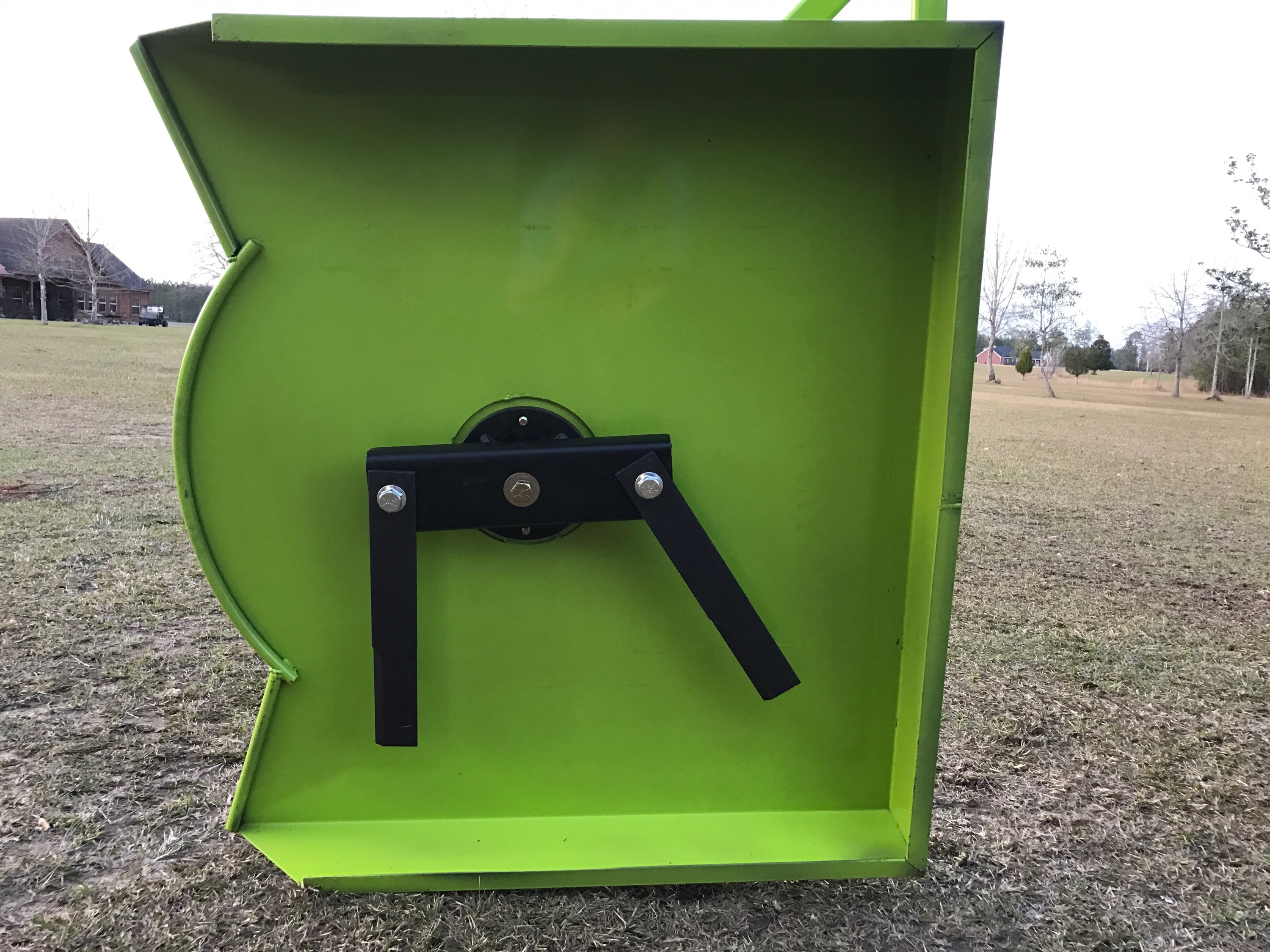

Duerwood, Do you have any pictures of the blades? And the fastening method, are they easily replaced/sharpened?
I do not currently have a picture available of the complete blade set, here is a picture of the current blade carrier and the fasteners. They are bolts and lock nuts. I will get you some pictures of the blades. I have yet to have to sharpen or switch the blades over. _storage_3435-3635_My cutter_20160911_190401.jpg
I apologize for not having any available at the moment.

Duerwood, thanks for the blade and carrier picture. One of the questions I asked you about in a phone conversation was will the hydraulic motor run in either direction, I don't remember the answer? lt190b

I can see a huge benefit in cutting tree branches on wood roads, atv/snowmobile trails, but to run this model, probably a 40 hp tractor should be used. For a tractor 25-35 hp, a smaller version somewhere around 2-300 lb. with 25-30" cutter would be better. For my tractor I'd be comfortable with 300 lb hanging off my loader. I do like the color tho, wonder what tractor that matches.
No it will not, the carrier will bind against the spindle because it will tighten the carrier bolt once contact is made with brush. I will also have the other answers for you tomorrow by mid day on freight.

So to be a little more specific on weight, the first one we built was from a 4' bush hog with a busted gear box, it was given to me for free. I went to pick it up and discovered I had just taken ownership of an heavy duty unit, the thing was a beast, 1/4" plate. We proceed with it to see if our theory would work. I was extremely nervous and filled my rear left tire with 80% water to balance my tractor. Today I would guess that the bucket mounted model is 200 +/- 20 pounds, the SSQA model is probably 250 +/- 20 pounds excluding the SSQA plate and arm. I guess long story made short is the majority of the weight is center boom, I feel comfortable that the weight on either model is well below 300 pounds offset to the right side. I plan to get an actual weight, I have to have the weight for a freight quote. I will share once I have the weight.

Let's see if this video works. We were struggling to keep enough SSQA plates in stock. Both manufacturers we were buying them from were on back order, we reached out to the local fab shop and had a dozen made, we were able to have them modified reducing some time for our assembly.

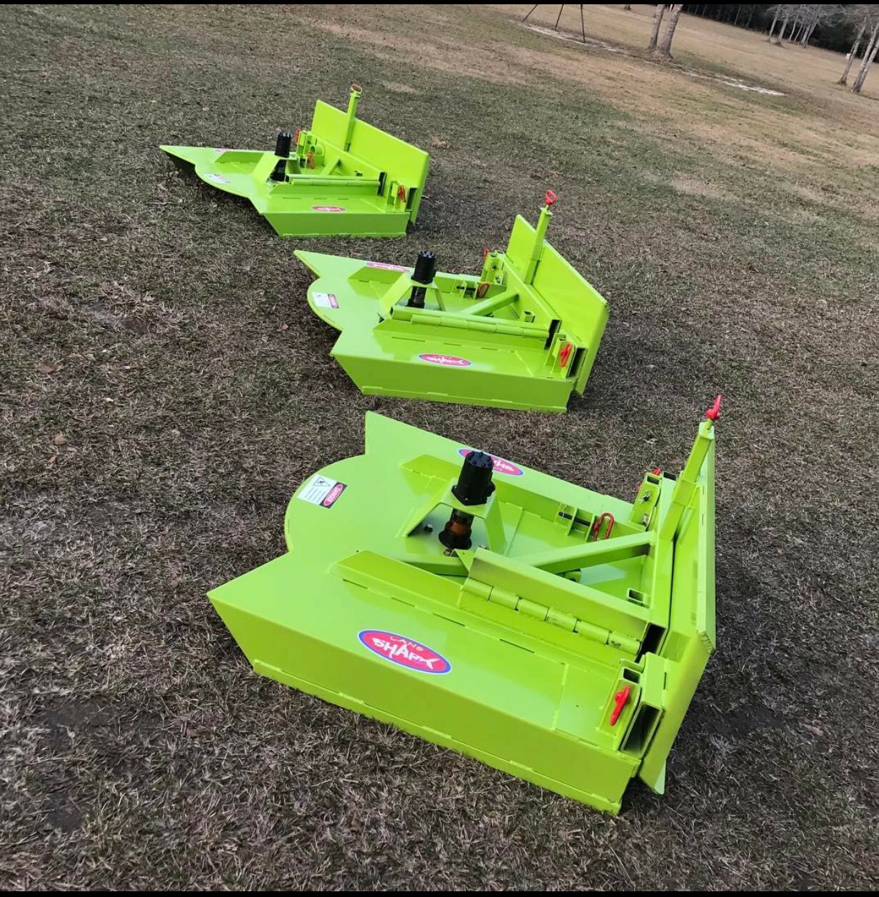

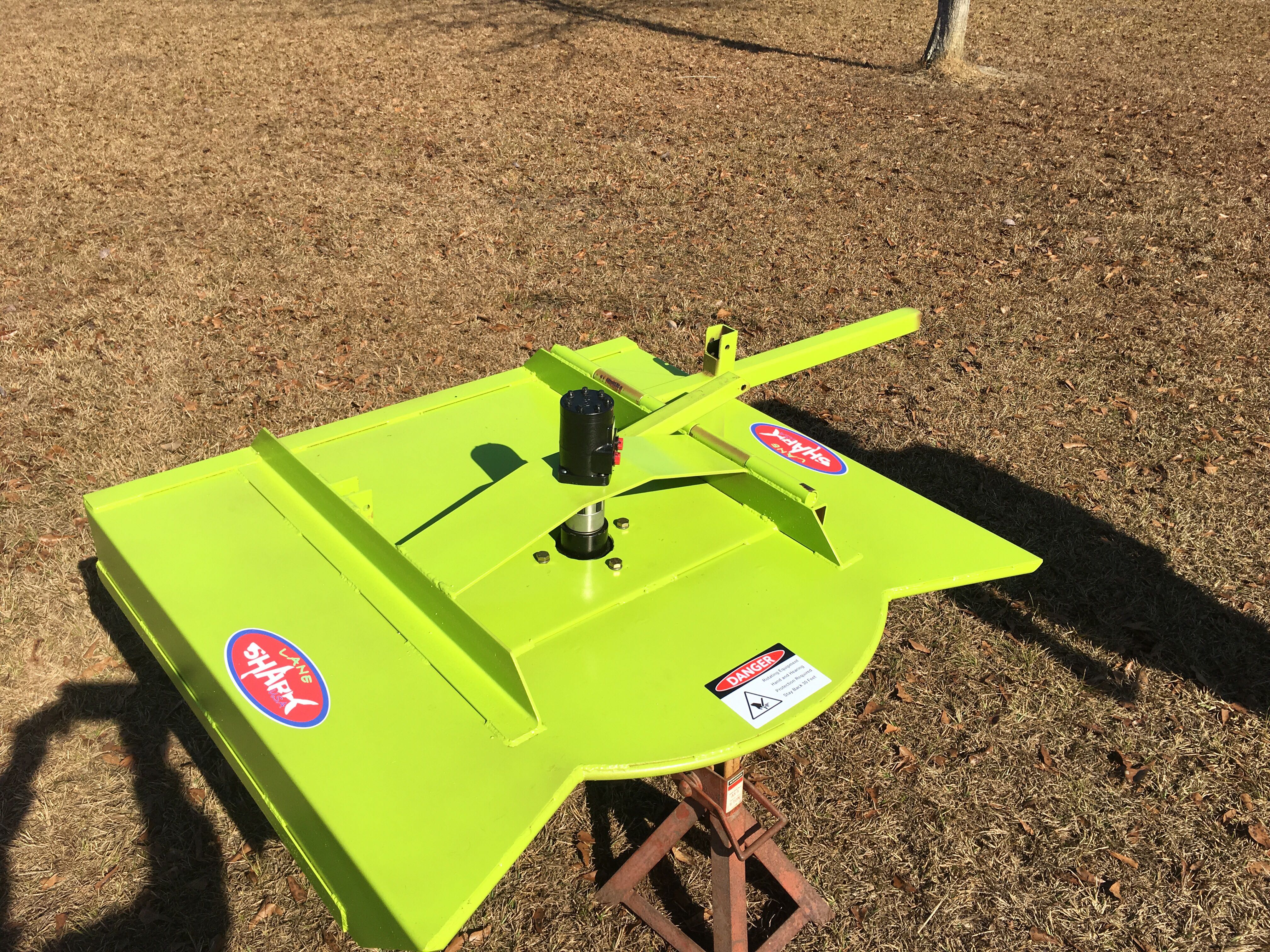

Finally a better picture of the blades for those that have inquired. For those that purchased units here is a picture of yours. Hope to have all shipping by end of the week.
/ FEL Road Maintenance Cutter #38
I like the fact you kept the bottom "clean" so there is not a place for junk to build up. Looks great
/ FEL Road Maintenance Cutter #39
Thanks! We built those three over the weekend, we have five decks ready to go, just have to finish the SSQA and the mechanical part (very time consuming).
