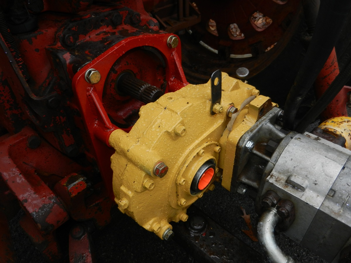

I've got a 15' flexwing mower behind my IH. The mower is hydraulically powered. Rather than use the tractor hydraulics it's got a PTO pump. That pump however, has a "speed multiplier" sandwiched between the PTO and the pump. The multiplier takes the 540 PTO and takes it up 4x speed so now, the pump is rocking & rolling.
So, if you can get something to work, all I'm trying to wonder out loud is if something like this could be beneficial to your situation?
Multiplier is the yellow part and the pump is hanging off the back.
(tractor has dual PTO, so you see the 1,000 shaft on top)
Richard . . . thanks for the advice. Many of the cutters I have looked at have the option for an external or auxiliary hydraulics tank that mounts to the 3pt. While added cost, it makes the cutter more self-contained and a much simpler tool.

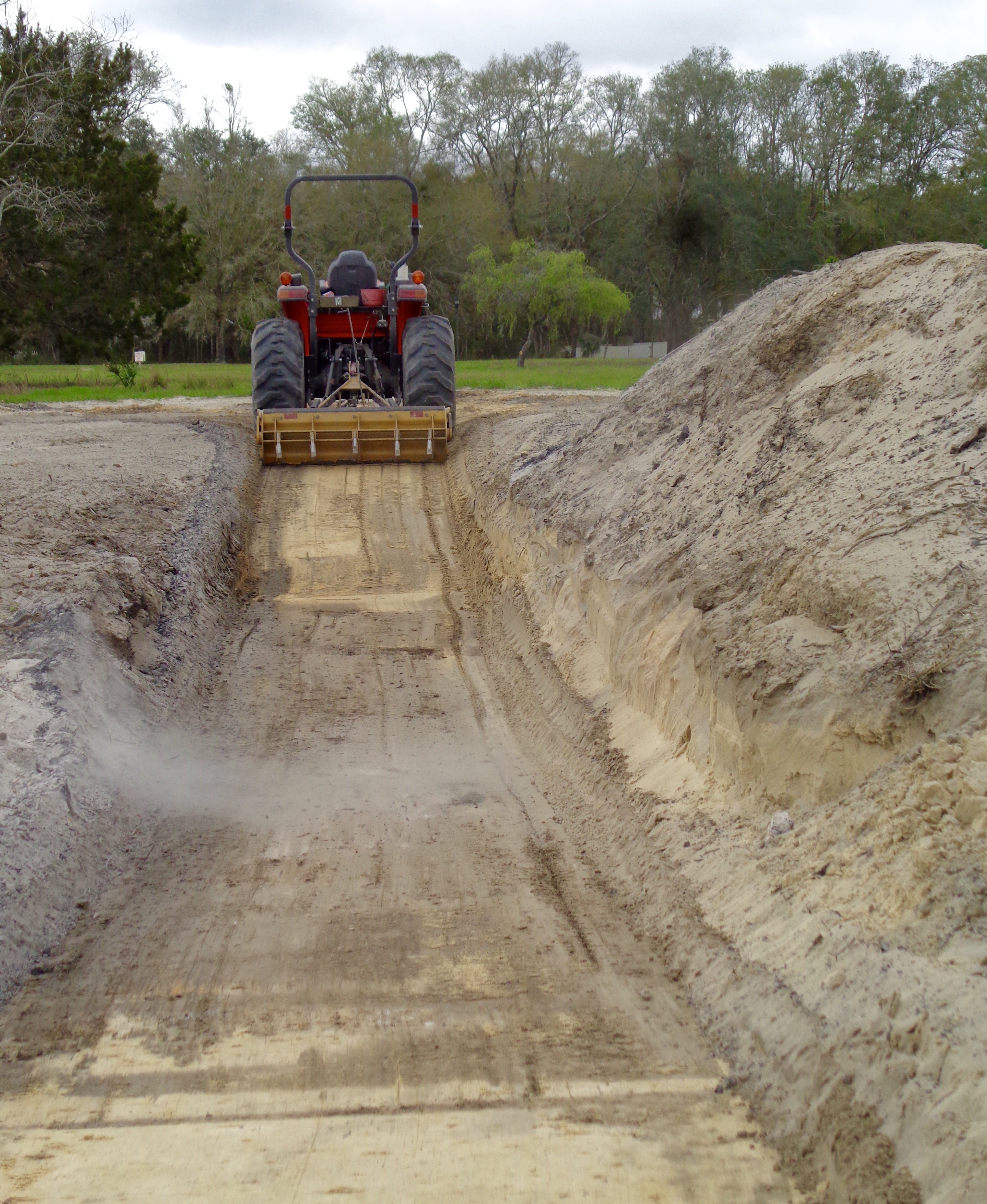

I can burn in Lane county, until they close the season which is around this time of year.
While I do burn, I hate it. I have two spots and when I start burning I have enough fuel to burn all day and into the night. I don't like having open flames at night so I stop feeding it early in the evening.
Start with a burn pit.
The burn pit in the photo is about 40" deep. The berm is about 8'.
What is removed from the pit goes on the berm.
Grass grows continuously on the far side of the berm. Intermittently on the fire side of the berm. Grass roots prevent berm from sliding into the
pit.
