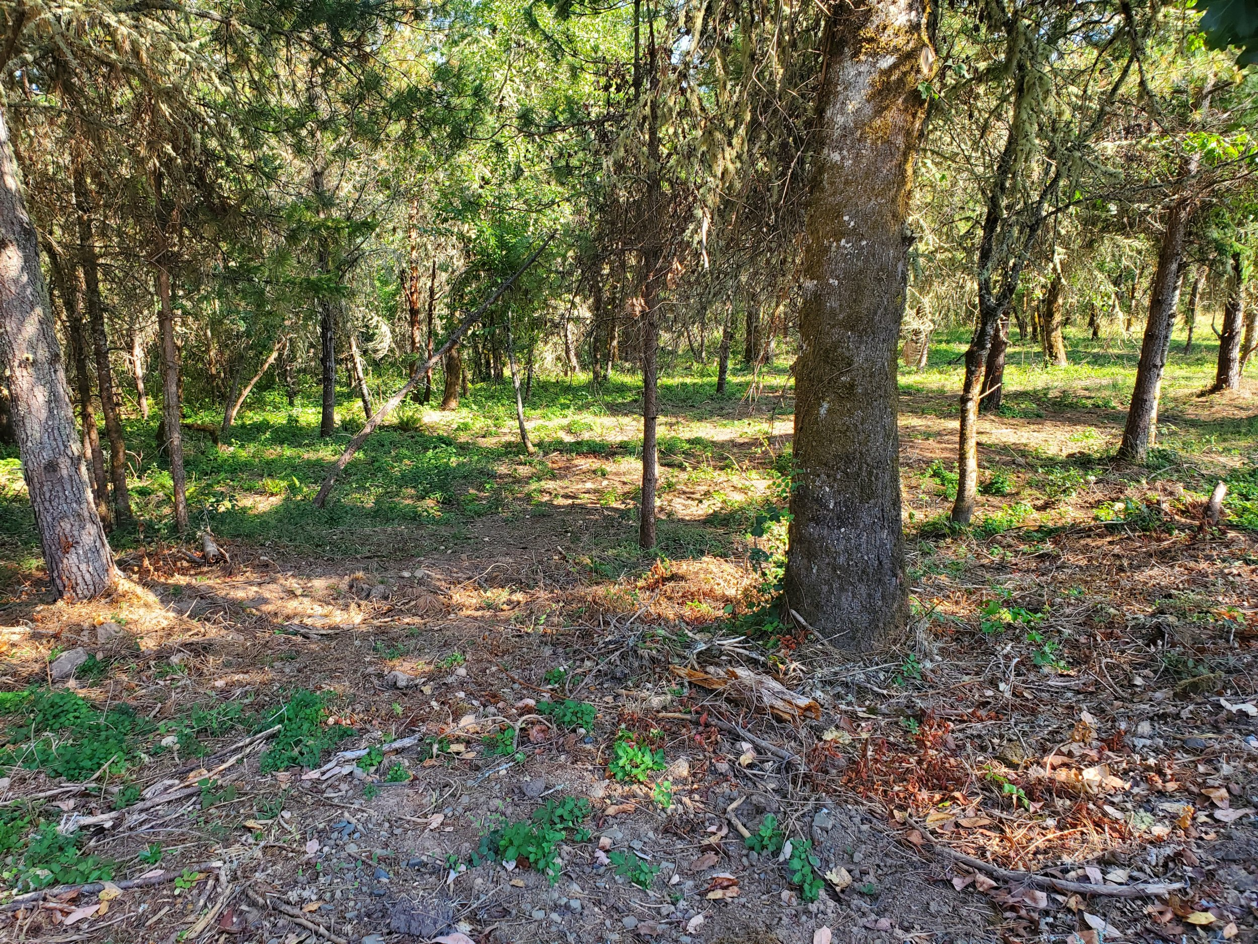

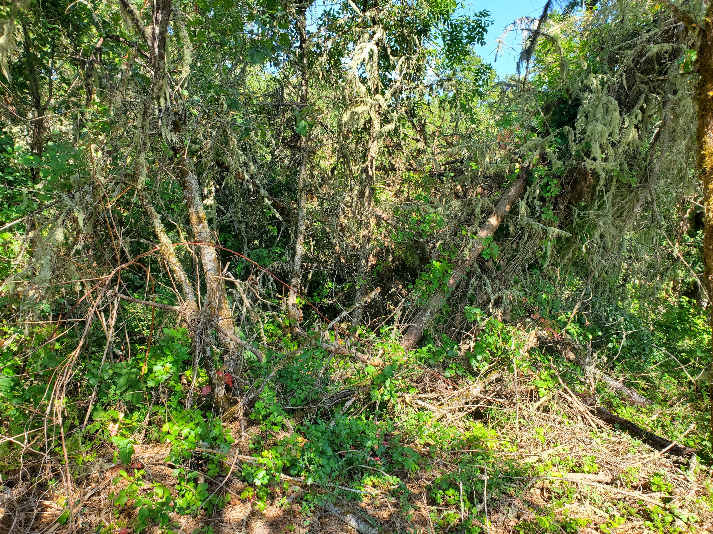

I appreciate EVERYONE's feedback and advice on this topic. Like most things in life, we all have different experiences that helps us form opinions about what we like and dislike. In situations like I'm in, I keep an open mind so I can learn from all your experience, evaluate it and then hopefully apply it to my situation successfully. To that end, here is more information, pictures and current thoughts . . .
The attached pictures are before and after shots. The dense woods you see is vines, ferns, poison oak, ivy, morning glory that climbs to the upper reaches of trees, invasive scotch broom, scrub brush that reaches 12-18' high with a dozen or more 1-2" trunks coming off it (I don't know what this brush is called), and then there's the 3+ inch trees (young fir, oaks, madrone, cedar, pine). There is also lots of downed timber from multiple years of wind storms, dying trees, etc. My land is flat in some areas but also has gentle to steep slopes so I do have challenges when it comes to using my tractor only.
After considerable thought, where I stand now is considering a FEL mounted cutter like the Lane Shark (or similar) or the FEL mounted FORAX HP40. I know these will not do everything I need to do nor will they be fast but all things considered (time, money, property topography, etc), I think one of these two choices to be best. For the sake of argument, I also considered a 3.5 ton excavator since the HP40 can mount to both a JD FEL and excavator, as long as I order both mounting attachments. That would definitely give me some flexibility in use, but 1) I'd have to buy a (used) excavator and 2) I understand excavators are not good on slopes so at the end of the day, what do I gain over just having the HP40 on my tractor? I have ruled out all 3pt implements as I just don't want to be backing into material or driving over it first and paying someone to clear for me is cost prohibitive (unfortunately). Last and certainly not least, I get to own the equipment the entire time, which I prefer since I don't like to rent or borrow, which in turn will help me to SLOW DOWN so I don't break something. Unfortunately I do this all to often when rushed.
Now I just need to determine whether the cutter like the Lane Shark or the FORAX mulcher will give me the best finished product that will allow me to easily manage new growth after clearing is done (i.e. I can easily drive around the property mowing it down because everything was cleared to the ground level). I'm hopeful either one will allow me to operate it somewhat vertically to trim tree branches as well as clear brush.
I hope I have answered everyone's questions and this new info helps your understanding of my situation. Like I said earlier . . . it ALL helps with my decision process because many, if not all, of you have "been there, done that"!

In my neck of the woods... 80 acres would have me calling a competent dozer operator to clean it and grade it smooth. (Ribbons around the big trees I'd want to keep.) Then I would call the seed man to seed it with a good pasture blend. I think I could do this for about the same money as a big tractor attachment, and then the area would be good for mowing.
Good luck.

That's true. There are so many and such a wide variety of tools that fit the skid-steer compatible mounts. Both the JDQA and the Global type fit less than 10% of the available goodies on the market compared to the SSQA. Knowing now that you are in this for a long term effort that's even more reason to go with the skid-steer compatible interface. Being in it for the long haul there is just no good reason to limit your tool options to some small % of the available stuff.
Yes, I see those pictures. None of these tractor mounted devices will really clear those woods. I visuallize endless chain saw days there ! Certainly the Lane Shark will be a great tool for the overhanging limbs and general trimming. It may be that over time you will need to hire a dozer to do the heaviest stuff, just a day or two here and there, things you can't clear with the tractor or your own means.
A big mulcher with the PTO driven pump feeding it seems appropriate too but those things, the serious ones, are expensive. I suggest a gradual approach with the Lane Shark , a good bush hog and a grapple for your FEL to start. Then add as needed after building on your experience with those basics.

Thanks JWR. After even further consideration, I think I have convinced myself (and my banker...aka: wife) that the limited versatility and potential abuse to my tractor warrants not going the route of a FEL mounted device but instead searching for a tracked skid steer and rotary cutter. Yes, much more expensive option but I'm hopeful I can get the job done lickity-split and then sell the skid steer.
