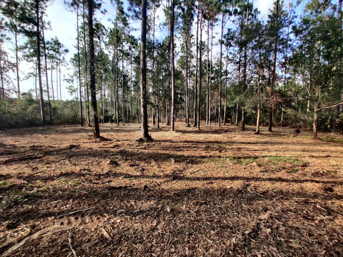

. . . We have those trails, then about a 20 foot thick privacy buffer of shrubs, and the middle is clear, but wooded . . . View attachment 681717
You are trying to cultivate a "privacy hedgerow" and want to preserve the 20' depth (thickness) you already have. Given 2 miles (inside and outside) a polesaw variant is the least expensive tool I would consider. As farmeratheart suggested, IF your tractor will support it, you could probably rationalize the Laneshark. A boom-mounted flail mower or rotary deck such as public highway departments use and the French call an "epareuse" requires a bigger, heavier tractor and probably a counterweight that would break the budget Environnement routier et Valorisation.

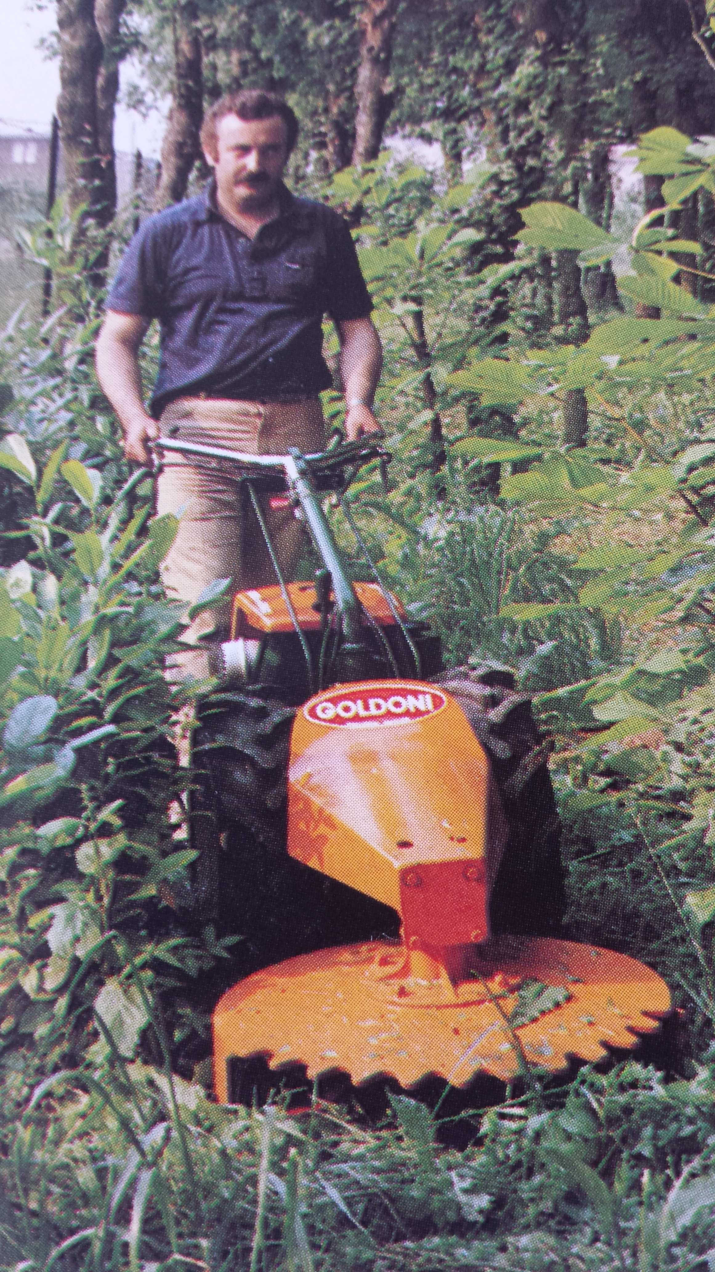

To continue pipe dreams, check out Home | Jarraff Industries and Trimming trees by power line with helicopter - YouTube. On a smaller (and cheaper) scale Gravely and some Italian 2-wheel tractors used to make partially shrouded (or unshrouded) saw-blade brush cutters. 63 L8 gravely and buzz saw attachment - YouTube
Perhaps a local "gyro-gearloose" fabricator could adapt such a cutter to mount vertically on your tractor.

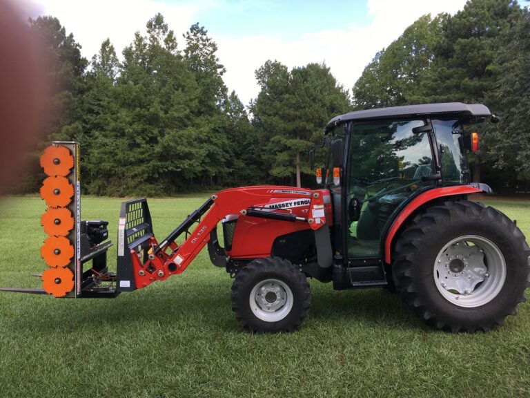

If I increase my budget to 3k, the Stout Trailblazer (pallet fork mount) falls into the mix.
I searched here and on google and have not found much on the device other than what the manufacturer posted.
TRAILBLAZER-HD for TB-22 – STOUT DESIGNS, LLC
stock photo on a tractor larger than mine:
The size brush they show is easily within the size around my property, so if it works as advertised, it should be fine for me on first appearances. While seemingly not heavy duty, it does seem heavier duty than the Samurai Cutter and does not require additional hydraulics. It would also be much lighter than the LaneShark type attachments for my CUT.
TRAILBLAZER - HD - Fork Skid Mount - Customer Video from LA - YouTube
thoughts, comments?
