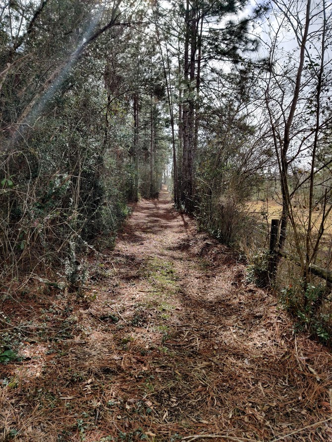

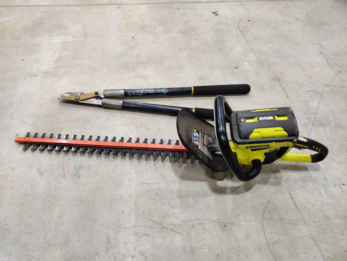

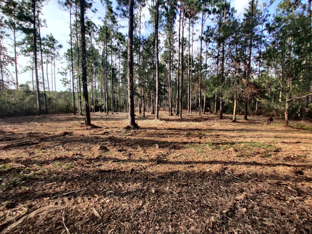

We live on a wooded lot of just over 6 acres. We have paths cut along the fence line for maintenance. We've mostly kept them up with just a battery operated hedge trimmer and a pair of manual loppers, but as time goes on, it gets harder and harder for us to maintain, and it usually takes a couple weeks for us to get it completed.. The paths we maintain (left and right side of each path, and along 4 sides of the property) are a bit over a mile combined. We service them about twice a year. About once every 10 years we have a forestry mulcher come in and widen the paths that have enclosed a bit over time.
Would a sickle bar such as the Samurai Cutter SABRE SAMURAI CUTTER | Cutthat.com - Your Cutting Edge Technology Expert work well in this situation? The near $2k investment is about all I'd like to spend, I see things like the laneshark LANE SHARK PRODUCTS – Lane Shark USA at near double the cost, and I don't think I'd pull the trigger on that due to the price.
Are there better options within the price range that I am missing?

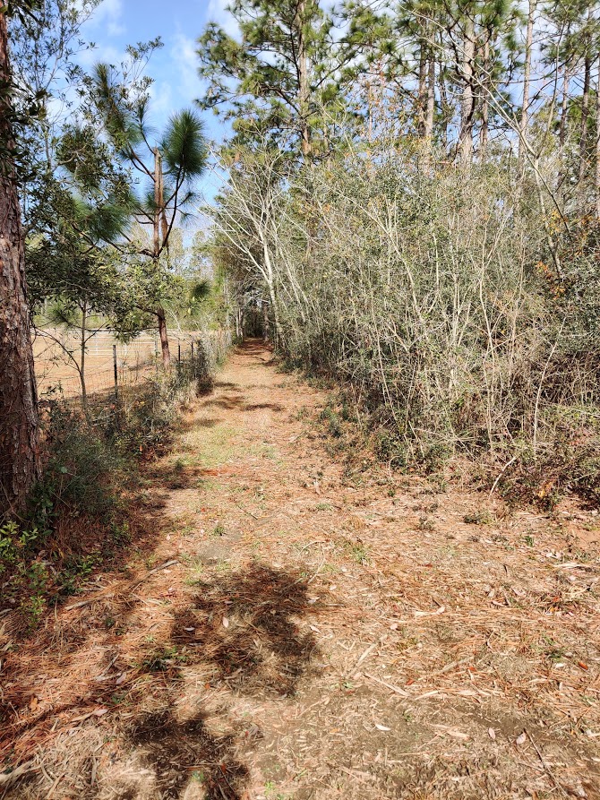

a little more info. The paths are about 10 feet wide, my tractor and bucket are both 5 1/2 feet wide, and I do have a 5 foot rotary cutter. My main concern is with the growth encroaching on the path from the sides, not what lands on the ground from cutting, or grows up in the middle of the paths. I'd like to keep the branches from growing into the pathway, not so much worried about saplings trunks coming up from the ground, just new branches, vines and shrubbery. I can keep the ground level clear, but the branches grow to close off the pathway.
And yes, we have cut accidentally fencing even with the manual hedge trimmer lol

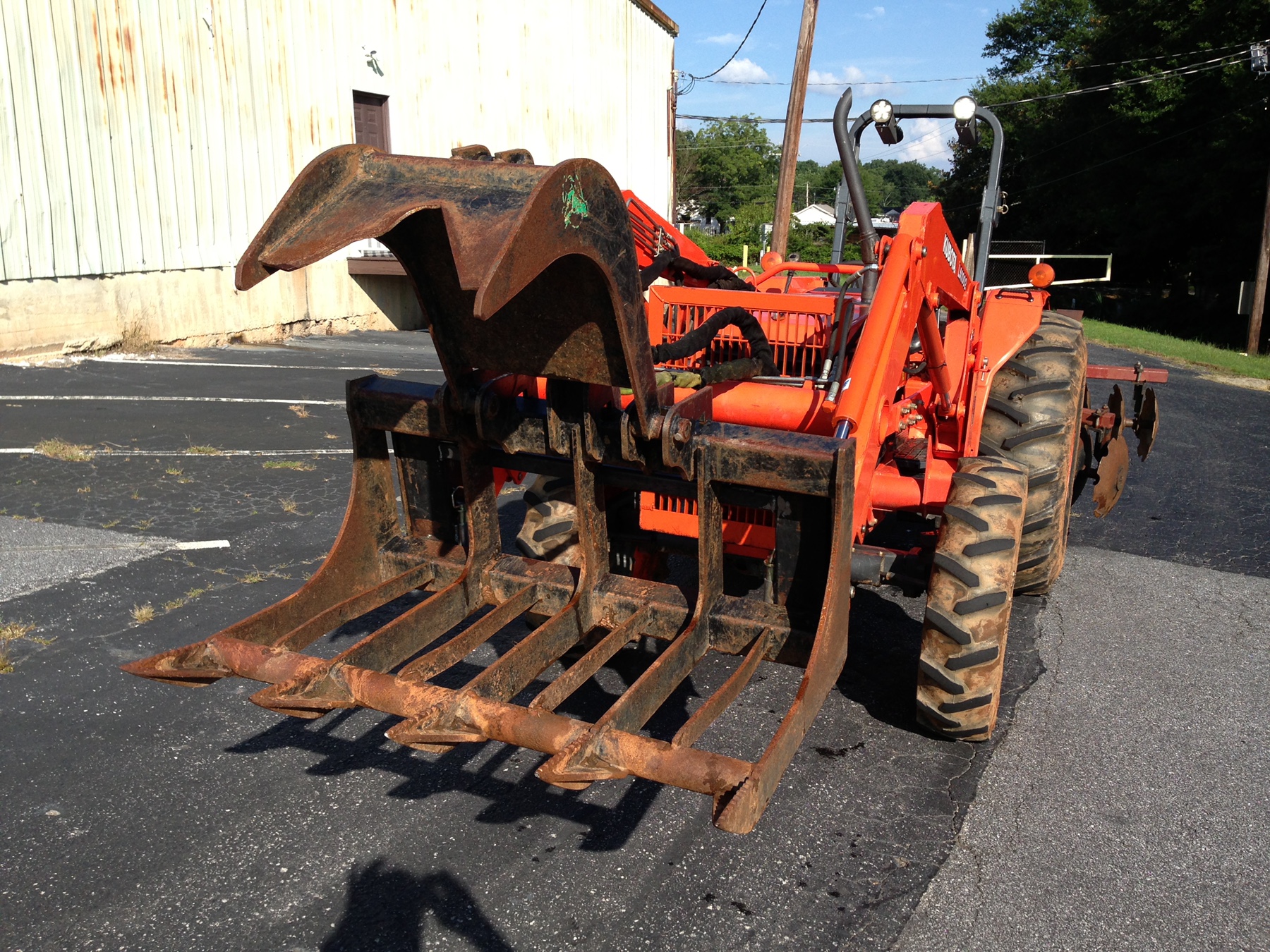

I maintain miles like that. I use a Stihl Kombi chainsaw. I walk along the path cutting the saplings at ground level and any overhanging branches. I let them fall into the path preferably perpendicular. Be aggressive in cutting. Don’t trim branches but cut the whole tree. Or you’ll be doing the same tree each year. Then I come back with my tractor and grapple skimming the ground collecting all the debris and push it into piles. Having a box blade on the back helps to grab any branches that I miss. Having two people-one cutting and one on the tractor makes quick work of it. I try never to touch the limbs. Just let them fall.
Of course the fence line would take more care to avoid the wire. I would keep it sprayed to minimize growth there. Using your loppers is crazy. No wonder you’re tired. A Kombi chainsaw will be a hundred times faster.

I would also use my grapple to widen it where possible. Rip out all that small growth if the big trees don’t prevent that. IMG_0746.JPG

can't do that. We have those trails, then about a 20 foot thick privacy buffer of shrubs, and the middle is clear, but wooded.
You can see that here, on the left side, you can see that 20 foot privacy buffer, and just beyond that is the path and the fence.
