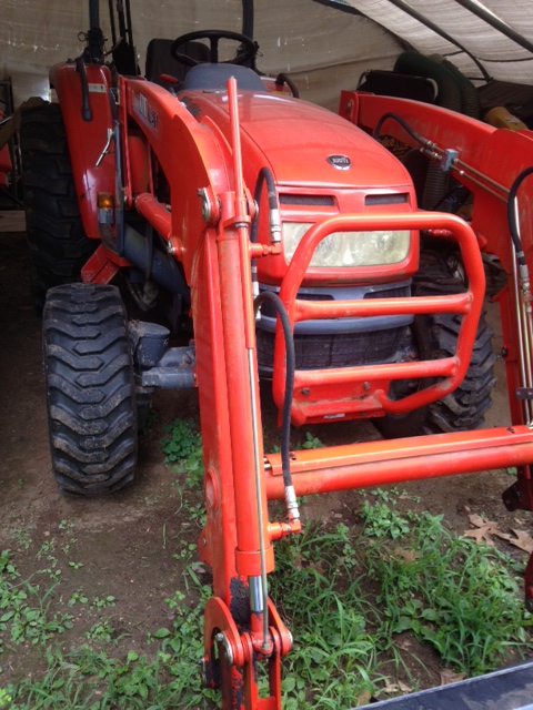

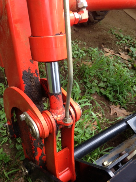

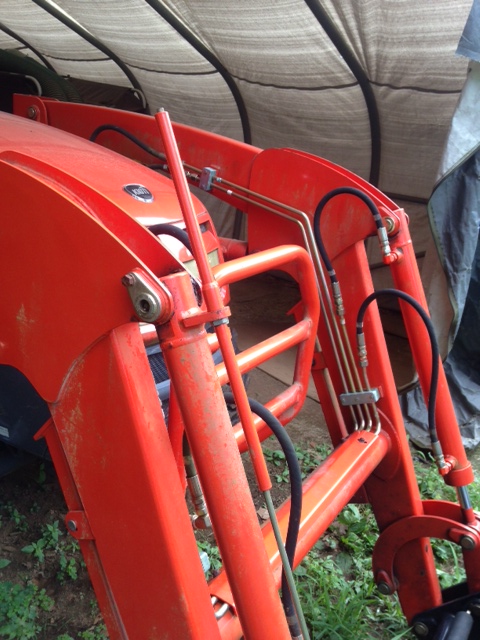

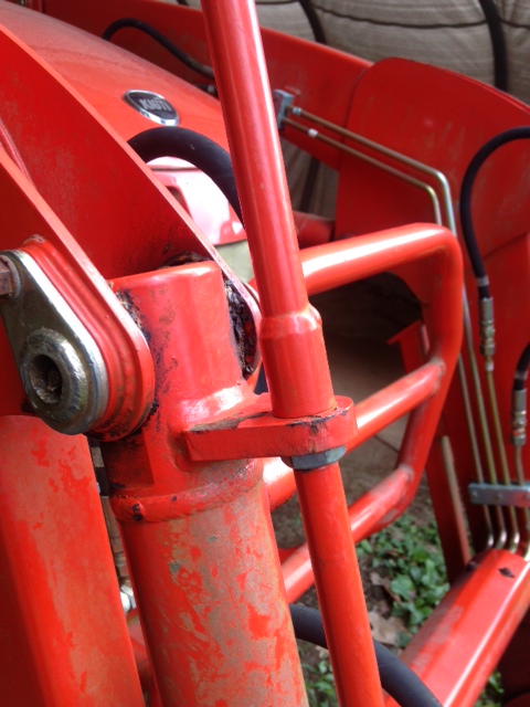

Hello all,
One of my wants is to add a bucket level indicator rod to my recently purchased DK50. Can one of you e-me some pictures of what it looks like on a FEL that came that way. I'm most interested in the connection point and any linkage or whatever. No need for me to re engineer something that simple and I want to just make a quick retrofit so I have a usable indicator. Just PM me and I can provide an Email address to send picture to. Thx

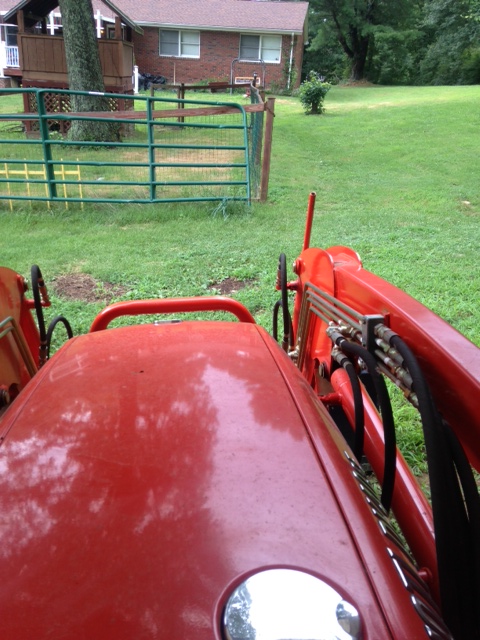

Here you go. This is on my DK 40. In my opinion bucket level indicator is very useful. I use it all the time. When rod is even with the top of the tube then the bucket is level. I'm sure that you could find or fabricate clamps to hold the rod and tube brackets to the hydraulic cylinder if you didn't want to weld like the factory indicator is done.
