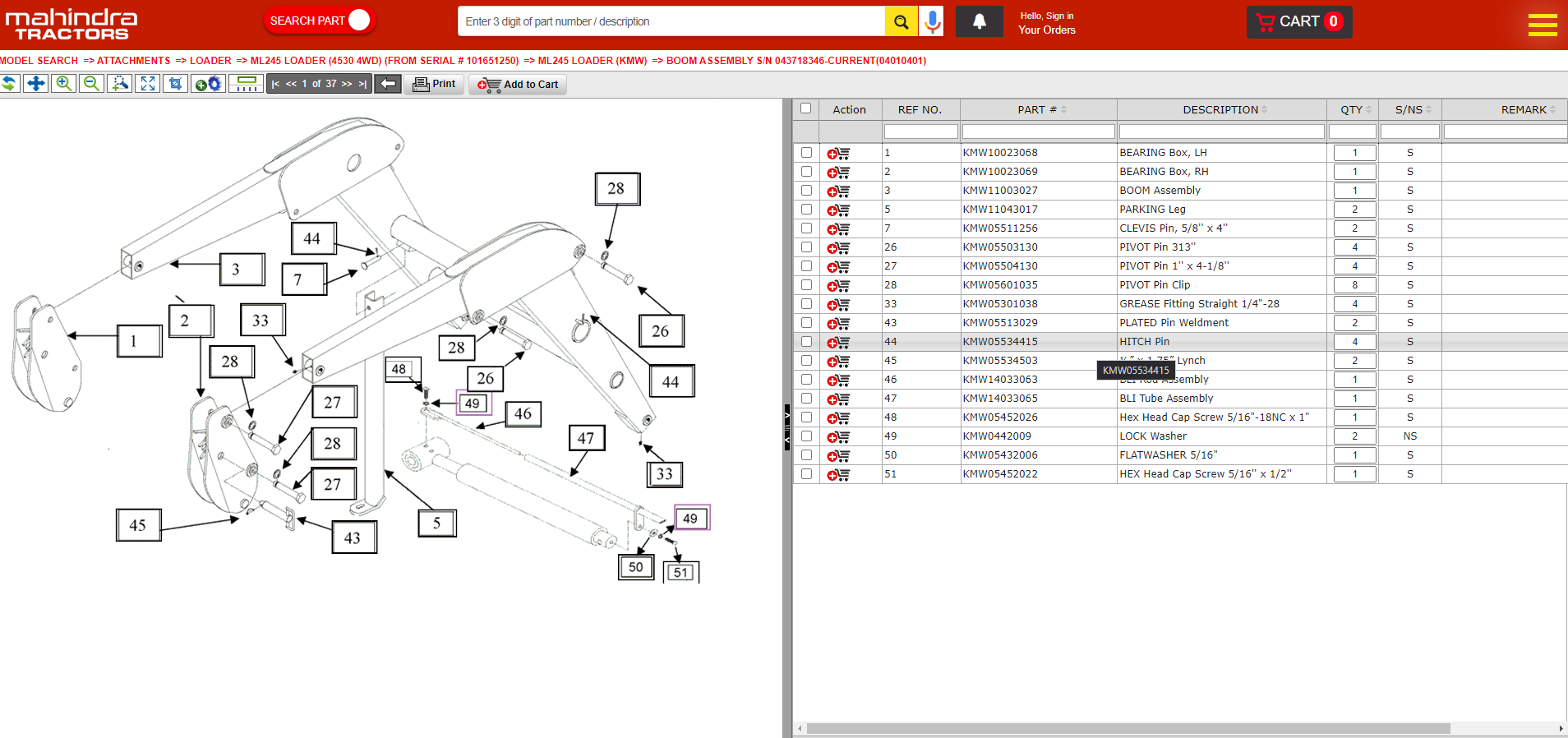

If you have a ML245 loader, this is the way to mount it. One end bolts in the back of the curl cylinder and the other on the top of the rod end of the cylinder.
Parts #46 and 47 are the bucket level indicator.

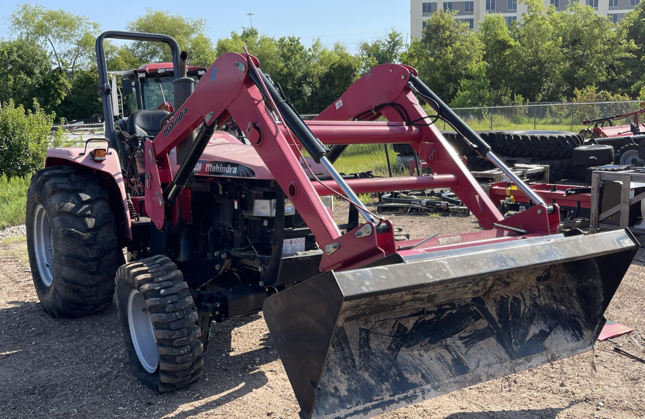

So, you were avoiding bending the bucket level indicator like this, right? :)
