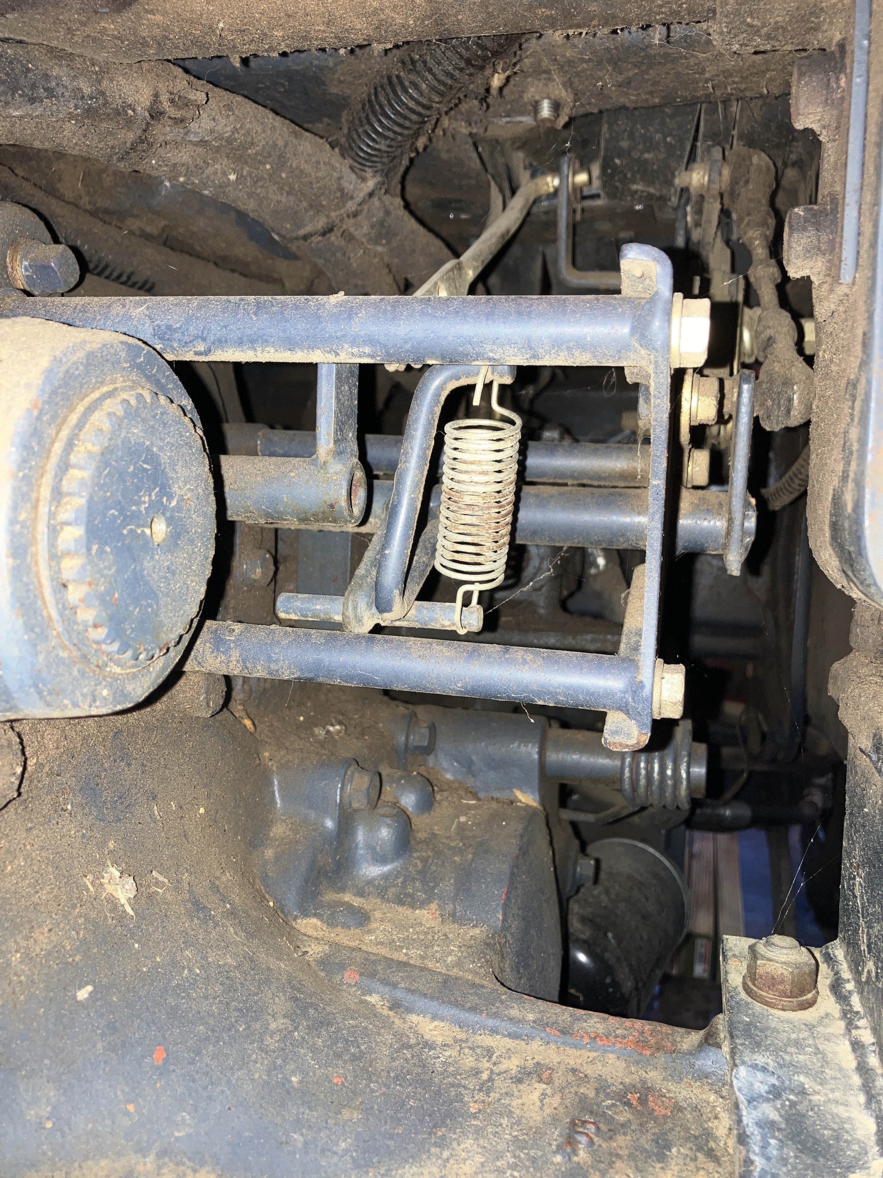

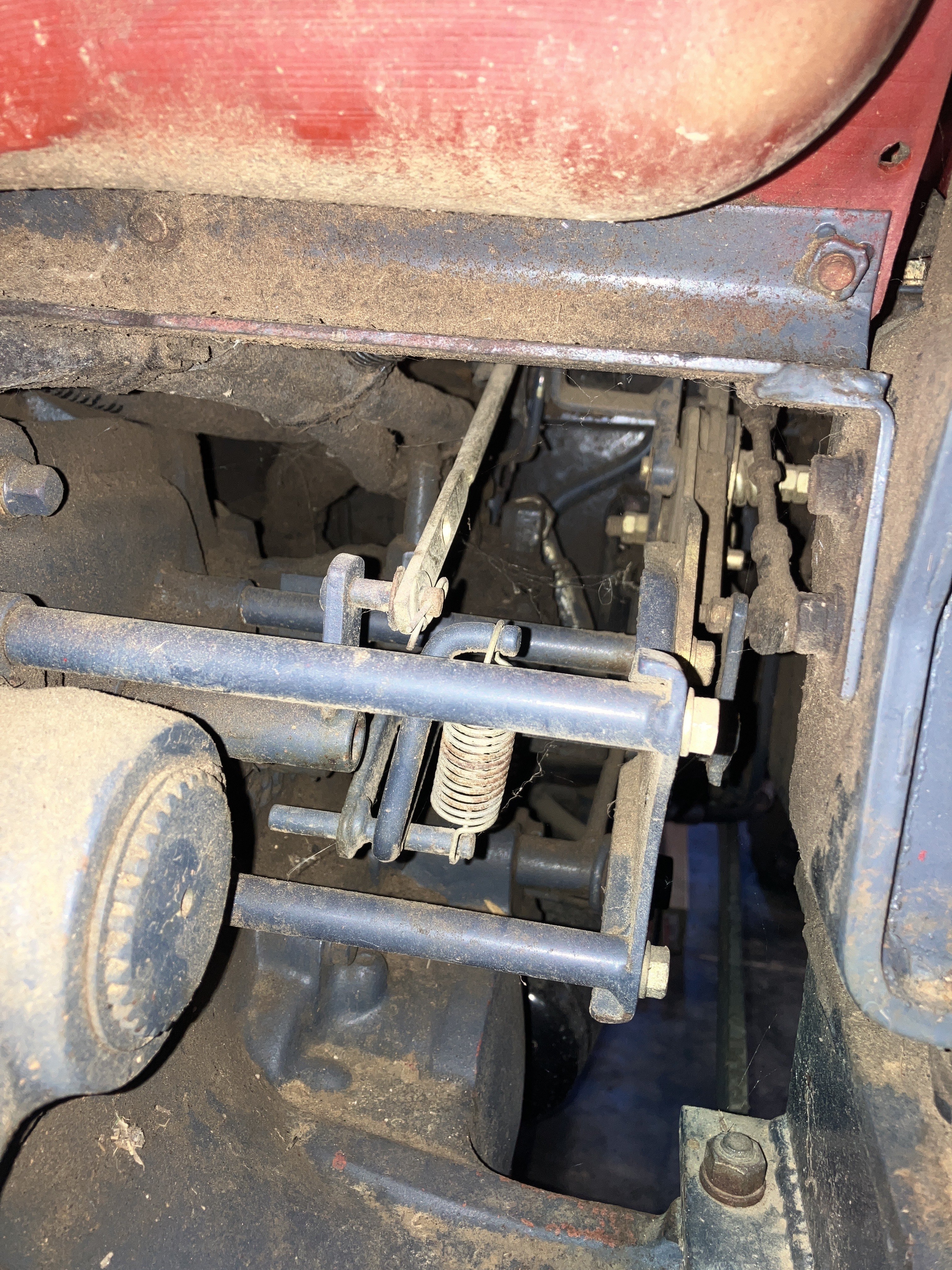

Hello. I have a Mahindra 4110 tractor that suddenly stopped lifting the 3-point hitch arms. I have found that the Position lever is attached to Nothing under the tractor! I have attached 2 pictures, one that shows the rear, right side of the tractor looking where the right lift arm would be and the second picture shows a close-up of where the linkage is.

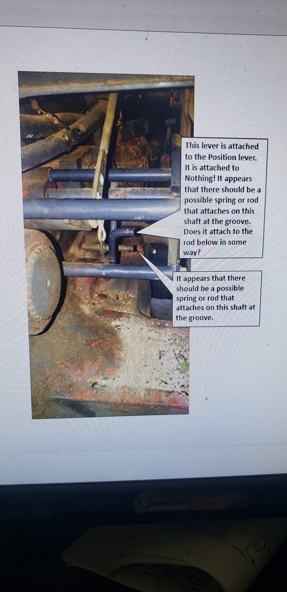

The blue rod in the second picture moves when the Position lever moves but is attached to nothing. The other rod in the second picture appears to be in-line with the blue rod. Each rod has a grove that seems to indicate a connecting spring or something that would link these together. Or, does the blue rod connect to something else!
I am having a hard time looking at the diagrams on the Mahindra web site to spot what this blue rod connects to. Can anyone look at your tractor and send me a picture of what a "normal" connection looks like? My lift arms need to lift!
Thank you in advance!

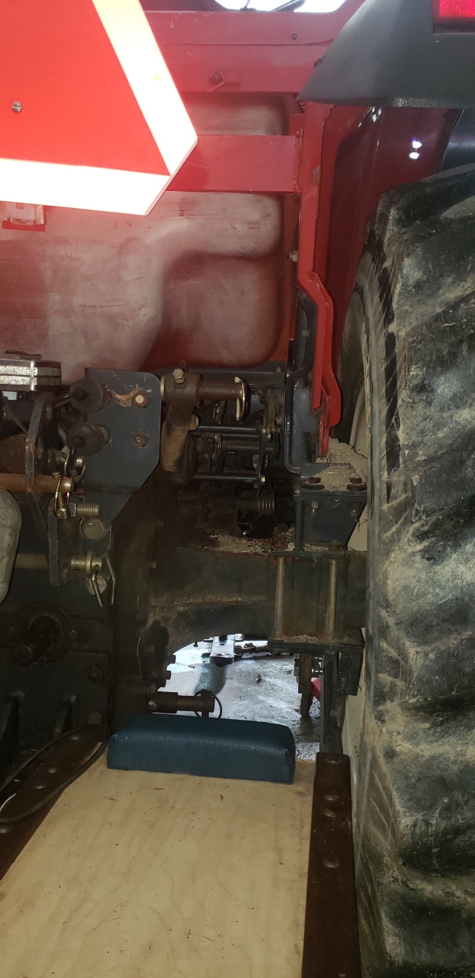

Yours has the same transmission as mine and Skipmarcy. They changed to the "New Metal" one after ours where made. That linkage has to do with the Draft Control. Here is a pic of mine. As a rule that lever should always be forward. Just use the right lever to raise and lower.
