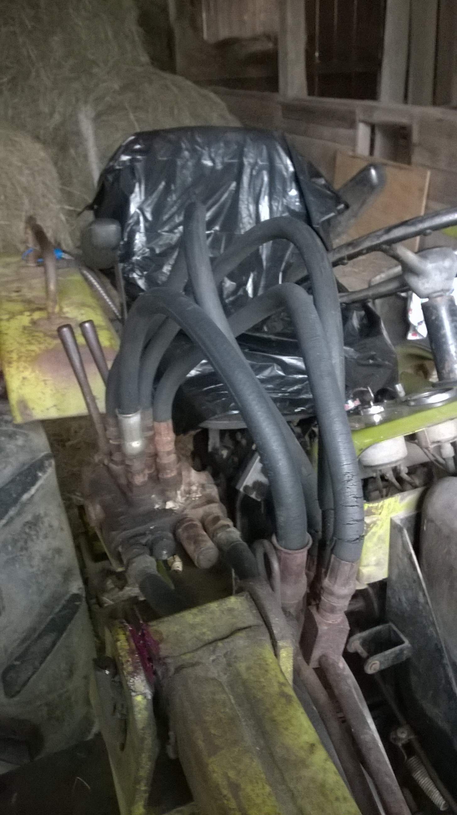

442831d1444008582-fel-diagnosis-wp_20150913_002-jpg
The only (possibly) useful photo I have of the control valve is below. There look to be a couple 'plugs' on one side. Maybe that set screw is under one of these.
I would think the relief valve might be the long looking plug middle right of your picture.
/ FEL Diagnosis #25
(I would think the relief valve might be the long looking plug middle right of your picture)
That probably is a screw cap under which will be the adjustment which may want spacers or have a nut and screw that you tighten to increase pressure setting.
Plugs on the side I would believe are for 'power beyond' installation.
/ FEL Diagnosis #26
That looks more like detented float cover to me.
/ FEL Diagnosis
#27
Any idea if/how these covers remove? There are two covered 'ports' here. The long one the PILOON pointed out and a second shorter one. I tried (not very hard) to unscrew the longer one. But I'm not sure they DO unscrew. Finding and adjusting this relief would be a good test. I've ordered my new loader valve but it's going to require some new hoses and fittings so I won't be able to get it installed right away. Upping the relief pressure might help this FEL while I'm stuck using this old valve.
