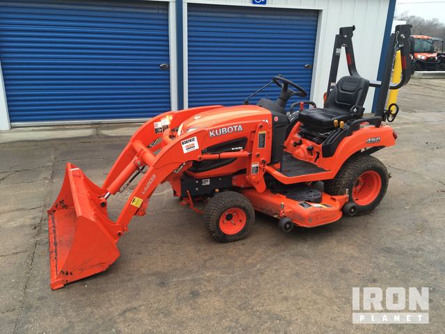

Yea I realize now that was kinda vague.
I'm taking about the curl cylinder. I was going to use a single one mounted in the center of the cross bar support. So the question is on that curl cylinder would it be better to mount the cylinder from the front face of the support so it basically runs at 90deg on that support and sits on it or on the bottom so that it is straight out from it.
   / FEL Build Questions. #43
That will affect the curl and dump angles. So you just have to play with the geometry of that to achieve whatever angle you want. It's a somewhat of a time consuming job. Took a while on mine to figure out.
   / FEL Build Questions. #44
This is how Kubota did it:
