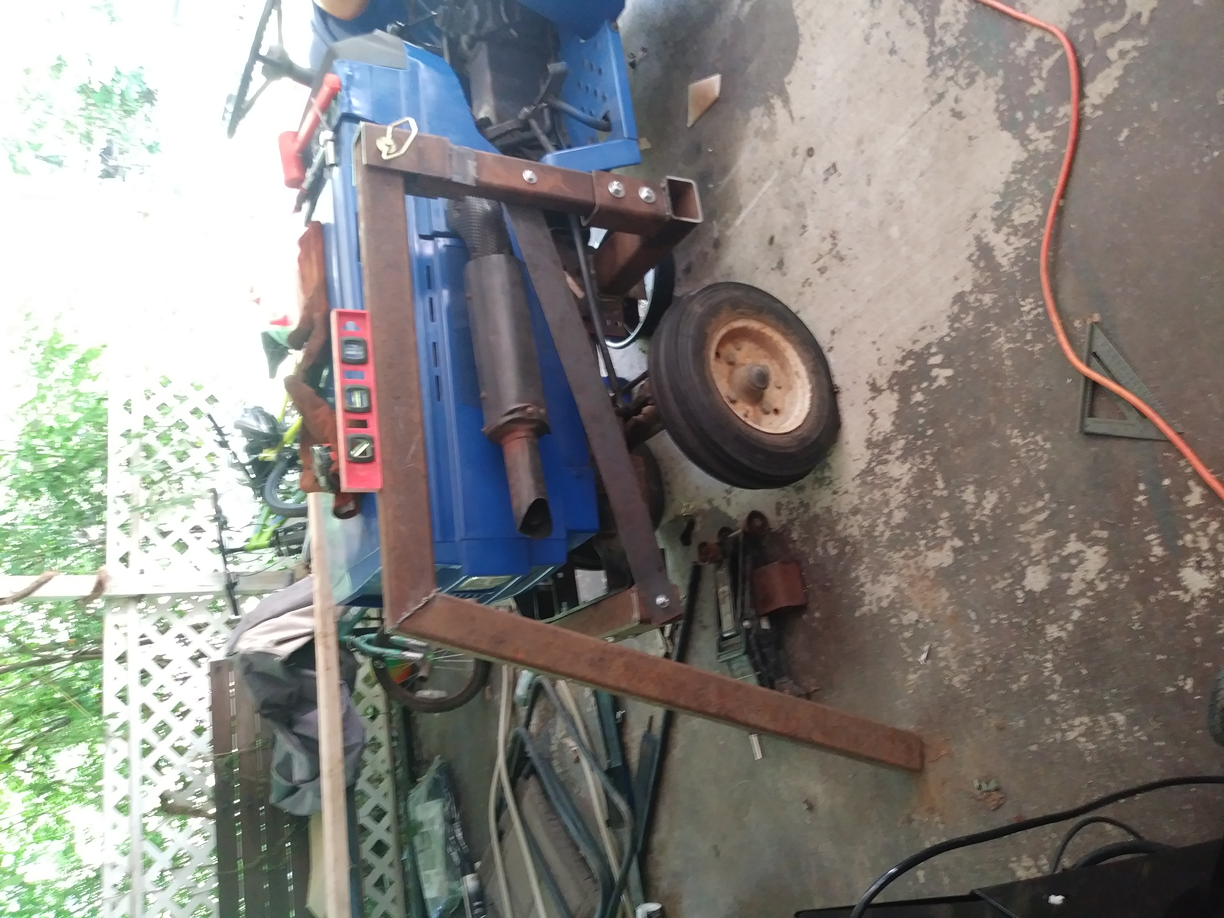

So I got the front bumper and supports made.
The questions I am pondering is should I close the ends on these things? The bottom main beam and uprights? I was planning not to simply so they couldn't hold water.
The other question was bushings. I see some each way is there a need for them really?
   / FEL Build Questions. #32
I would box them to keep rodents and insects out.
For pivot joints most small machines have a pin inside a tube with a grease fitting, no removable bushings.

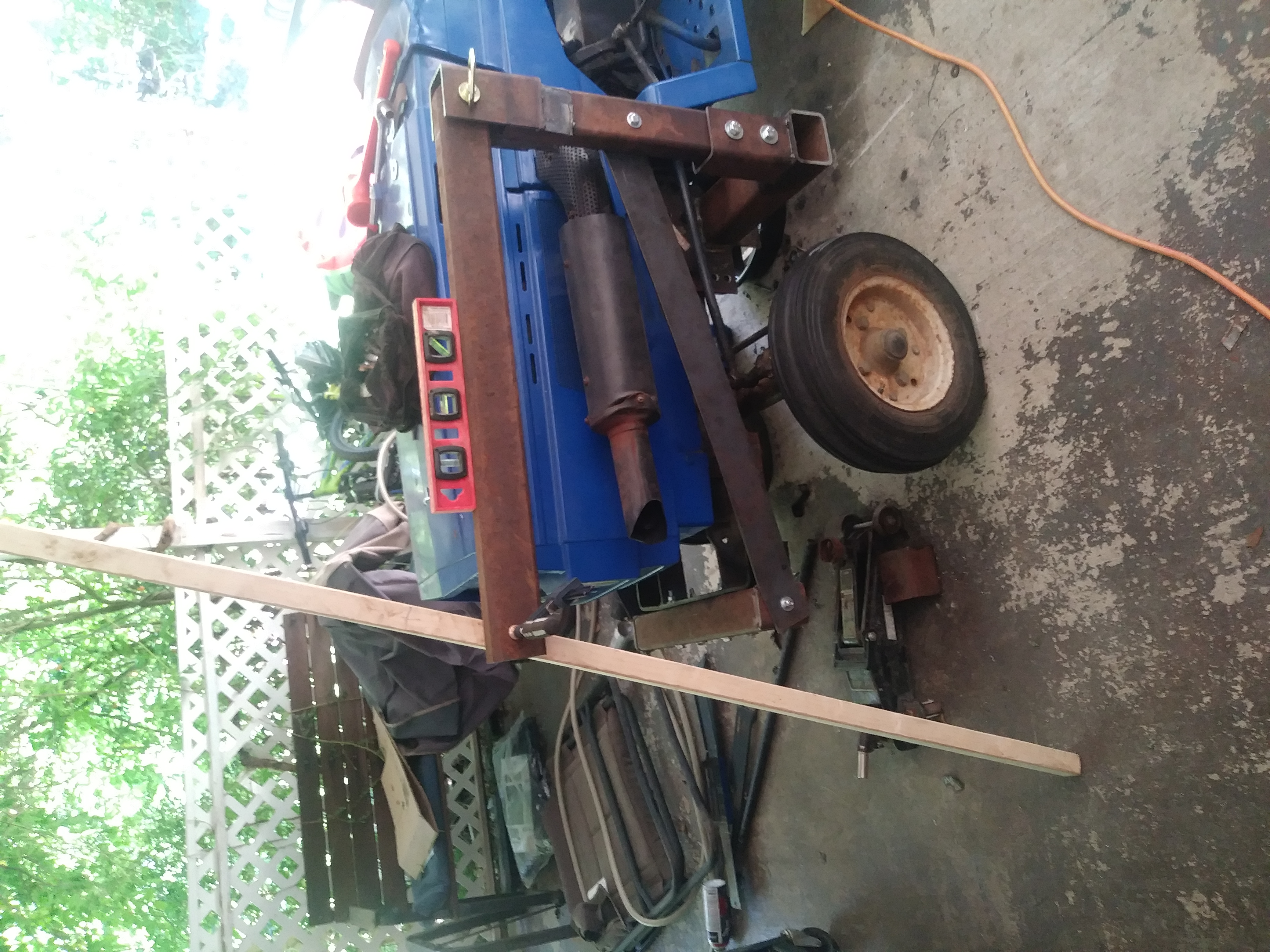

Thanks I will make it happen.
The test fitting the arm seems to be moving fine straight up, down a good bit. My question is does the angle in the arm going down towards the ground seem reasonable it puts the bucket about two foot in front of the tractor. I know I can shorten the arms a couple inches in order to buy a greater angle but then I run the risk of not being able to open the hood.

Lower portion of arm on.
So here's the question of the day. If I'm going to use a piece of Steel through the arm portion to act as a bushing, do I need to use anything on the uprights where the pin goes through or should I just not drill them to a larger size leave them tight to the pin diameter?
   / FEL Build Questions. #36
Mowens; If I'm going to use a piece of Steel through the arm portion to act as a bushing said:
My wag is if each wall is 1/2" or more,bushings wouldn't be necessary but will extend life of components. ,I would drill holes slip fit to pin and weld short (1/2"to 3/4" long bushings on outside of upright walls. That provide's added bearing/support surface on longer pins. I must tell you I feel like a Boy Scout explaining survival tatics to a Navy Seal. I am totally awed by you and your brother's skill on this project.
   / FEL Build Questions. #37
Welding tubing to spread the load will keep the pin holes round longer. You will also want to keep the pin from rotating against the non-greased part of the joint, either welding a tab to the pin for a bolt or drilling for a cross pin.

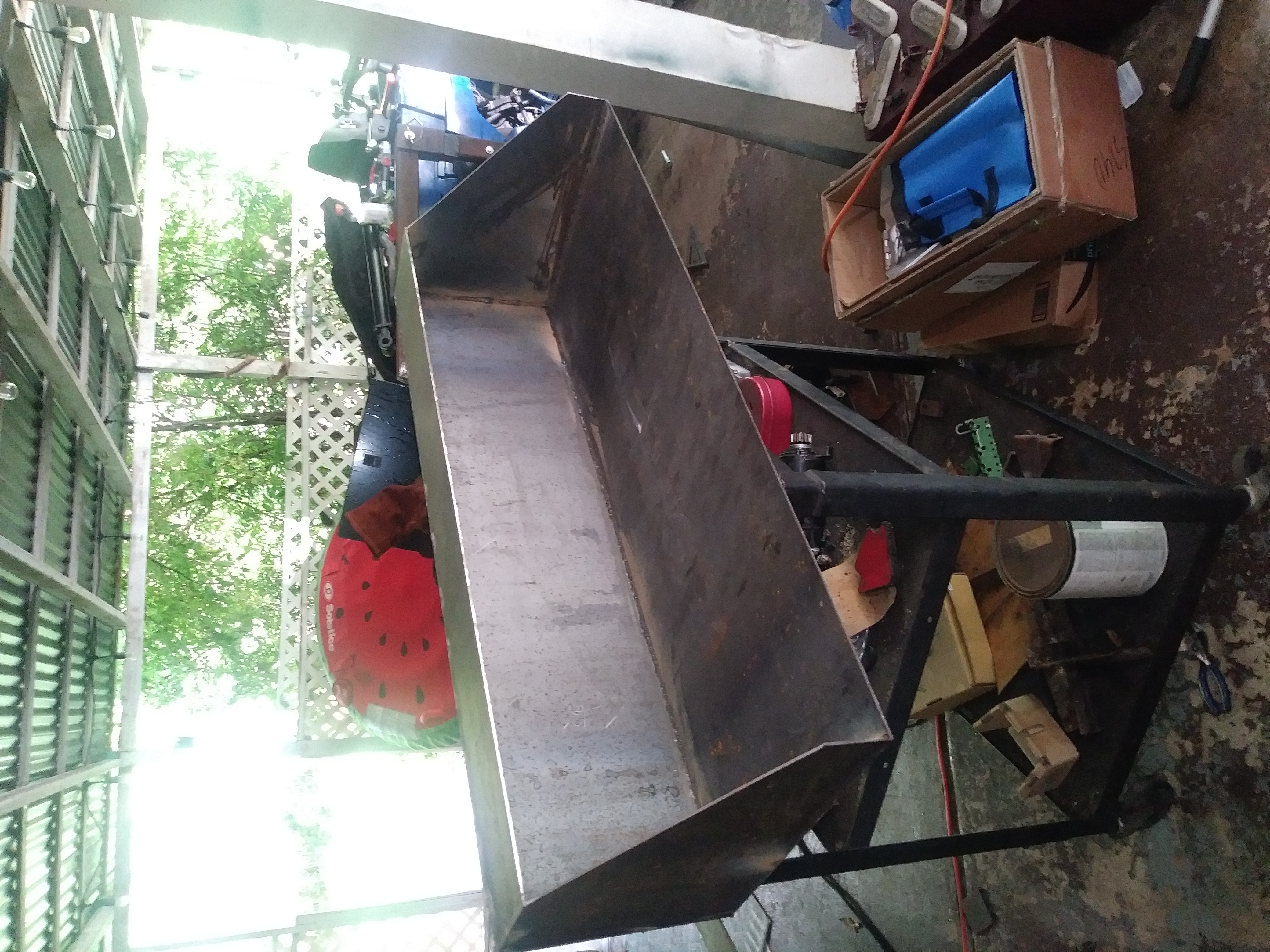

Got the bucket fabbed up. Hydraulics almost knocked out. This beast almost done.

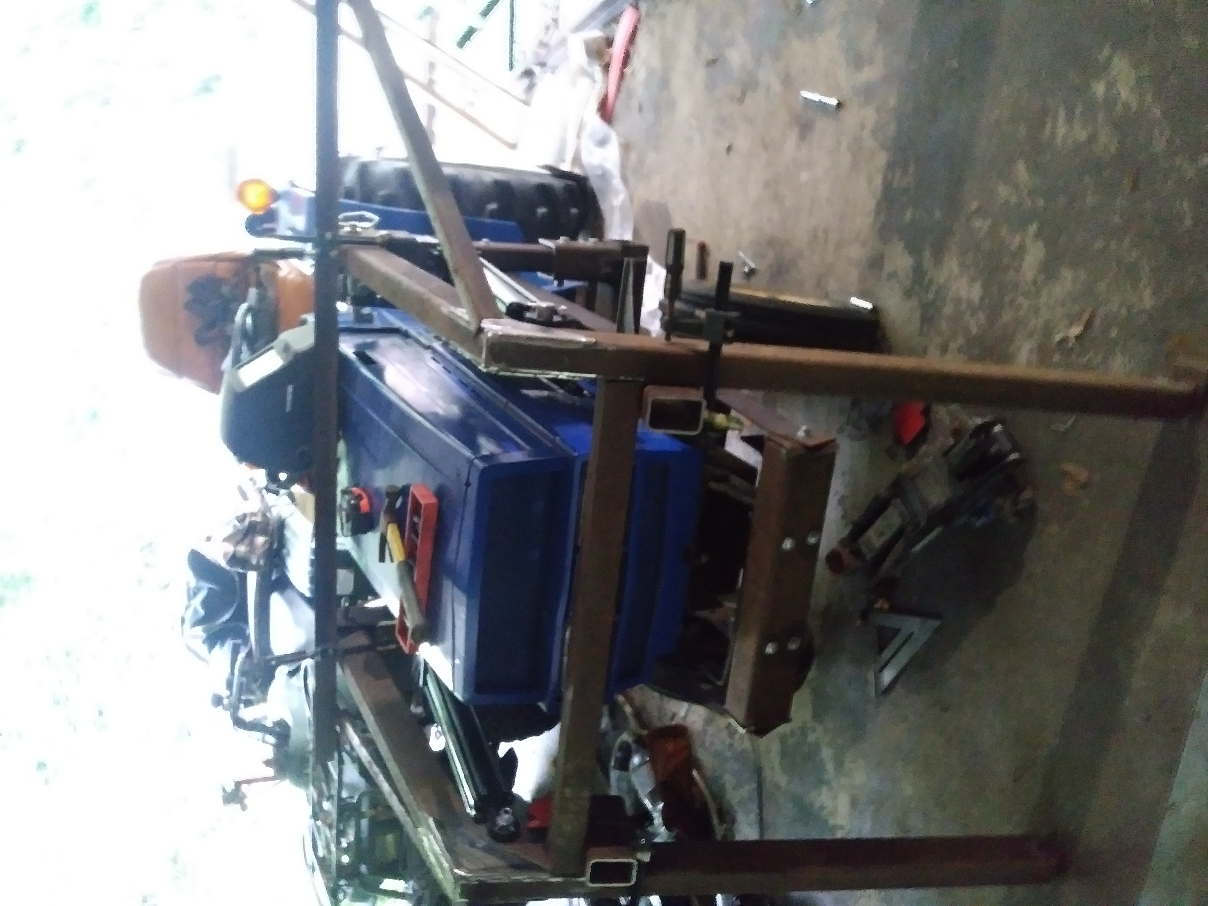

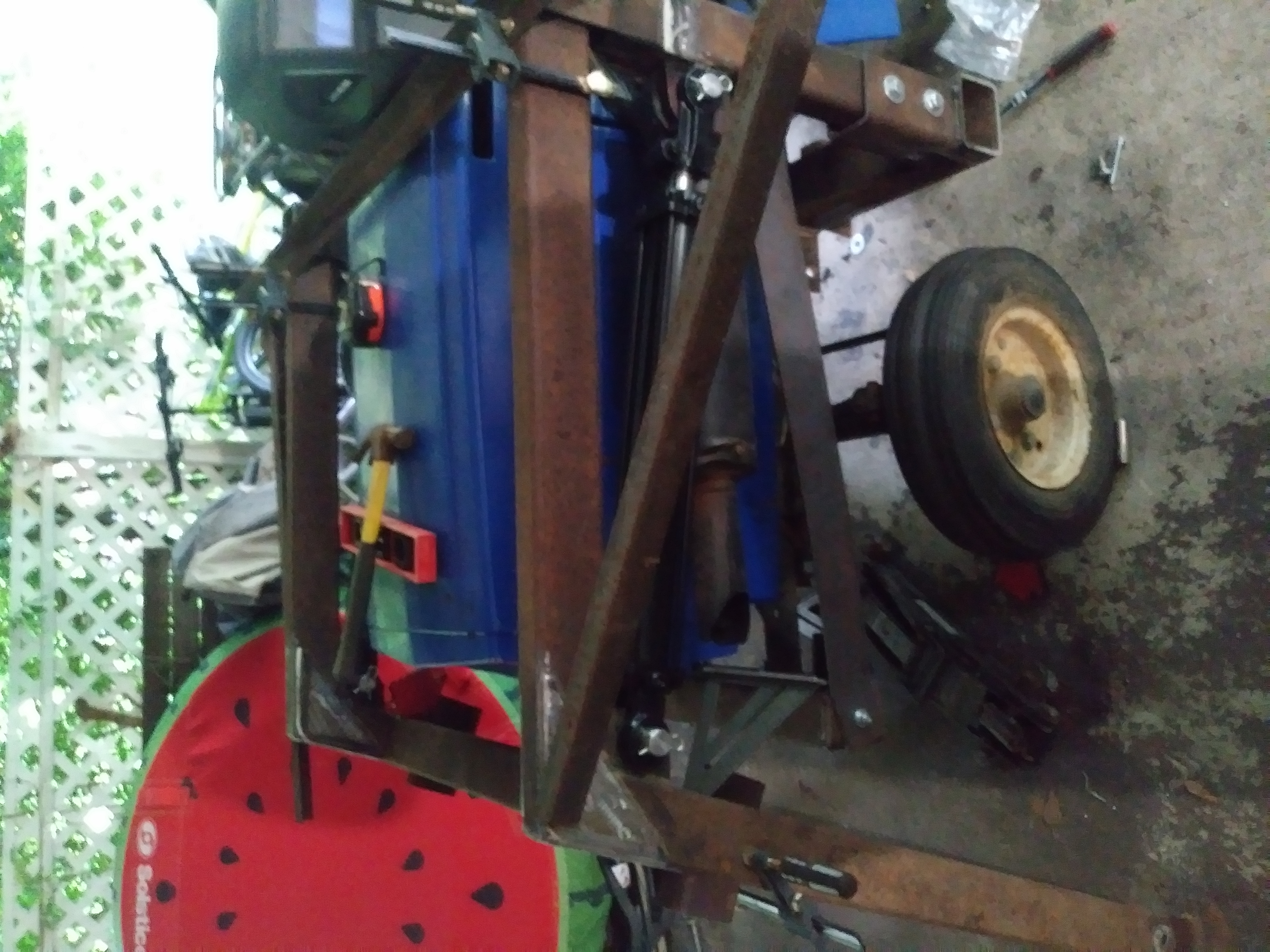

Some updated pictures. Learned a lot as this went along.20190614_192403.jpg20190614_192412.jpg
Pardon the supports trying to keep it square as I add the cross support.
Is it better to mount the hydraulic from the front of that or the bottom?
