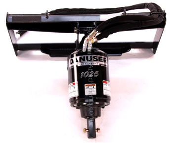

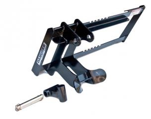

Hydraulic post hole digger for front mount FEL. I don't have actual pictures of mine yet (these are stock pictures), but if you get one, make sure you get the offset set up (second picture) so you can see what you are digging. Otherwise if you get a center mount one intended for skid steers you may need a second person on the ground to guide you. These FEL mounts are way better than 3 pt as you don't have as much of the wobble that a 3 pt allows (sometimes holes then go at an angle) plus you can reverse the auger if you get stuck under a root or rock and can't lift the auger out. If you already have hydraulics for a grapple, you should be set. Otherwise you will need to add them. Make sure you don't oversize the hydraulic motor depending on your hydraulic GPM capacity.

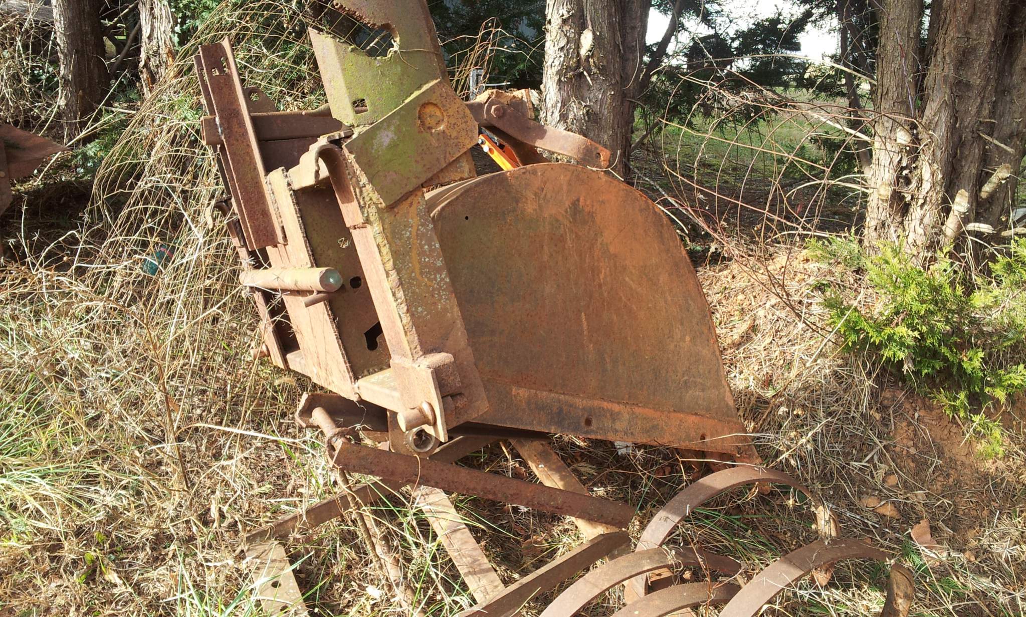

Before I learned that a JD 4100 can have additional hydraulics added to it. This was our solution for digging and trenching. Frame from scrap around the stockpile and the bucket was $37 at the local scrap yard. View attachment 294115
I love it.

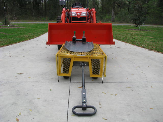

#1. Ratchet Rake from Tractor Supply $300
#2. Bucket Solutons' clamp on Bucket Spade $380
#3. Payne's clamp on Aluminum Debris Forks $800
