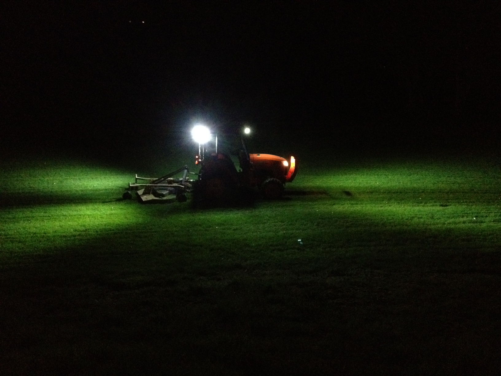

Until I moved to the country with a 2.3 acre yard I would have laughed at anyone who mowed at night. Last year when it was 100-106 degrees for several days I mowed at night just so I didn't sweat/bake to death! I had no issues doing it with my stock headlights but of course more light would have helped. Lights are on the long term list of things to add.
I have noticed that my neighbors with larger farms, that do hay, also mow at night. When I asked why, they said it's for the cooler temps and the fact a couple of them work odd shifts. They all have auxiliary lights mounted front and rear.

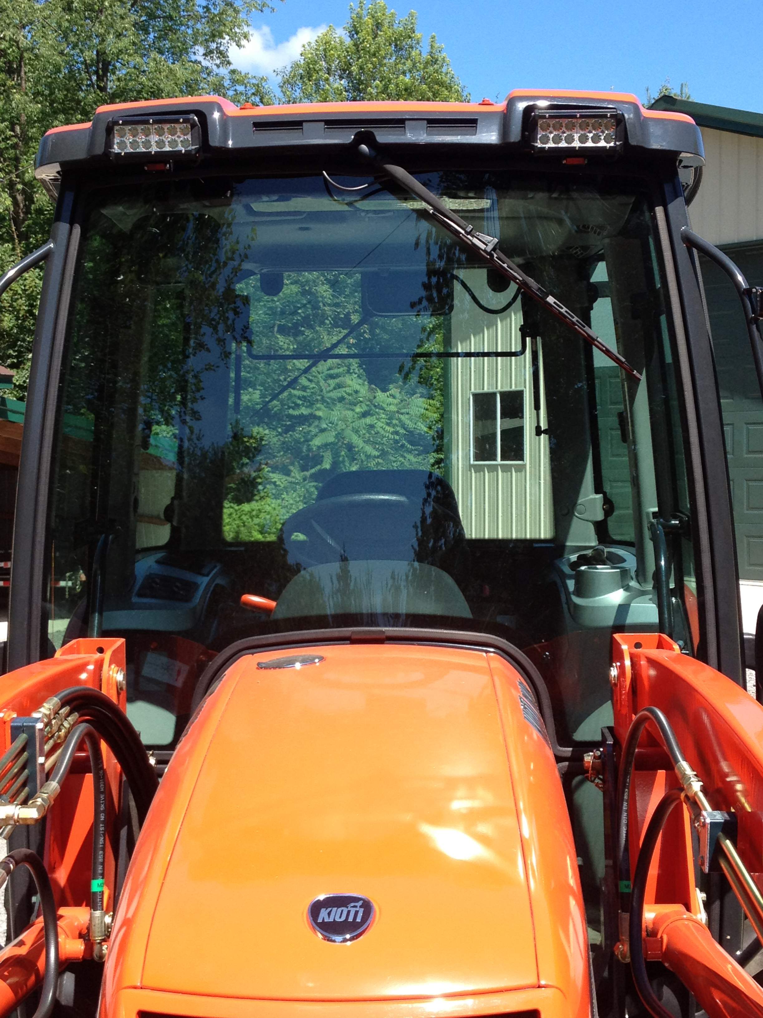

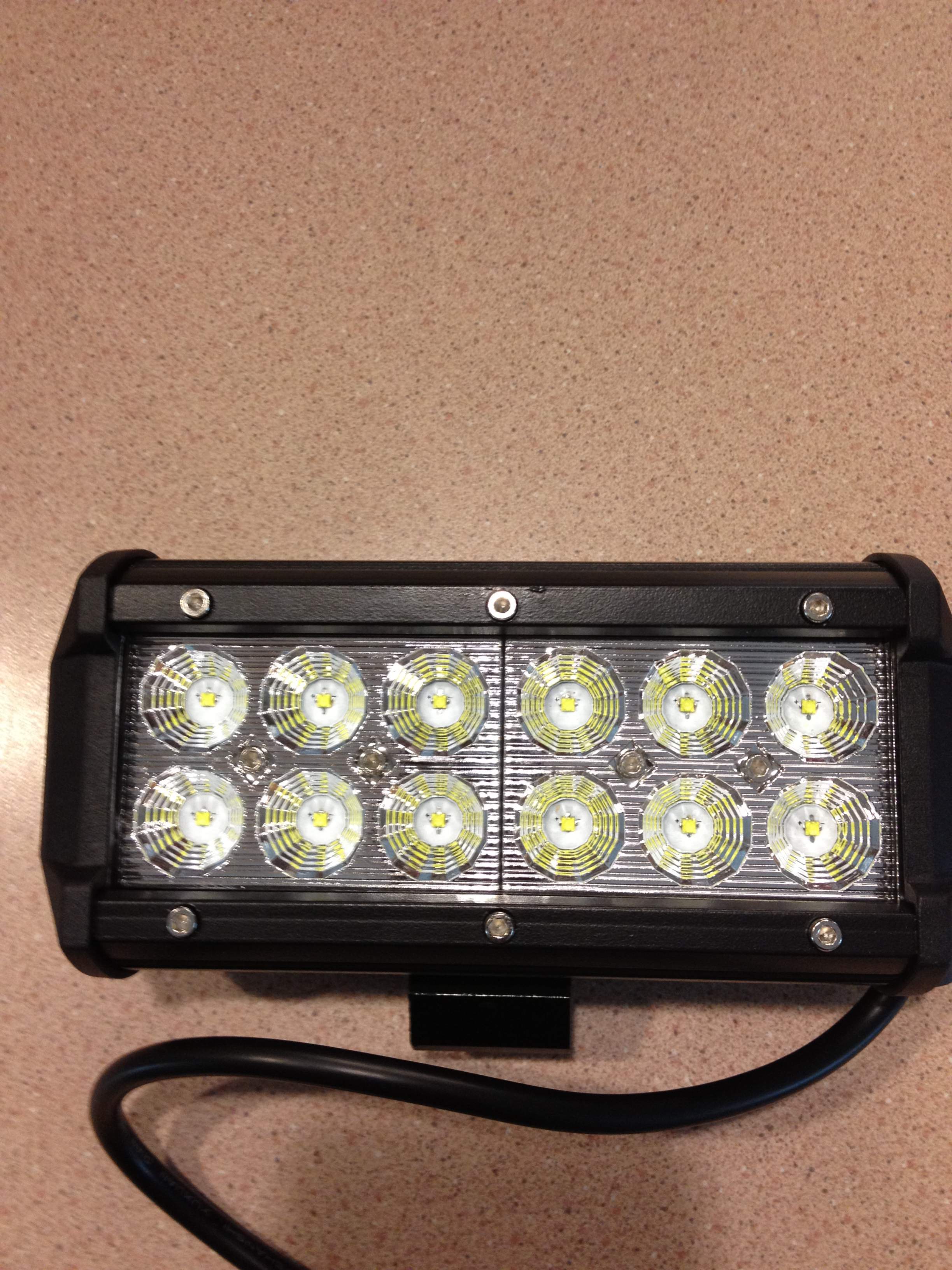

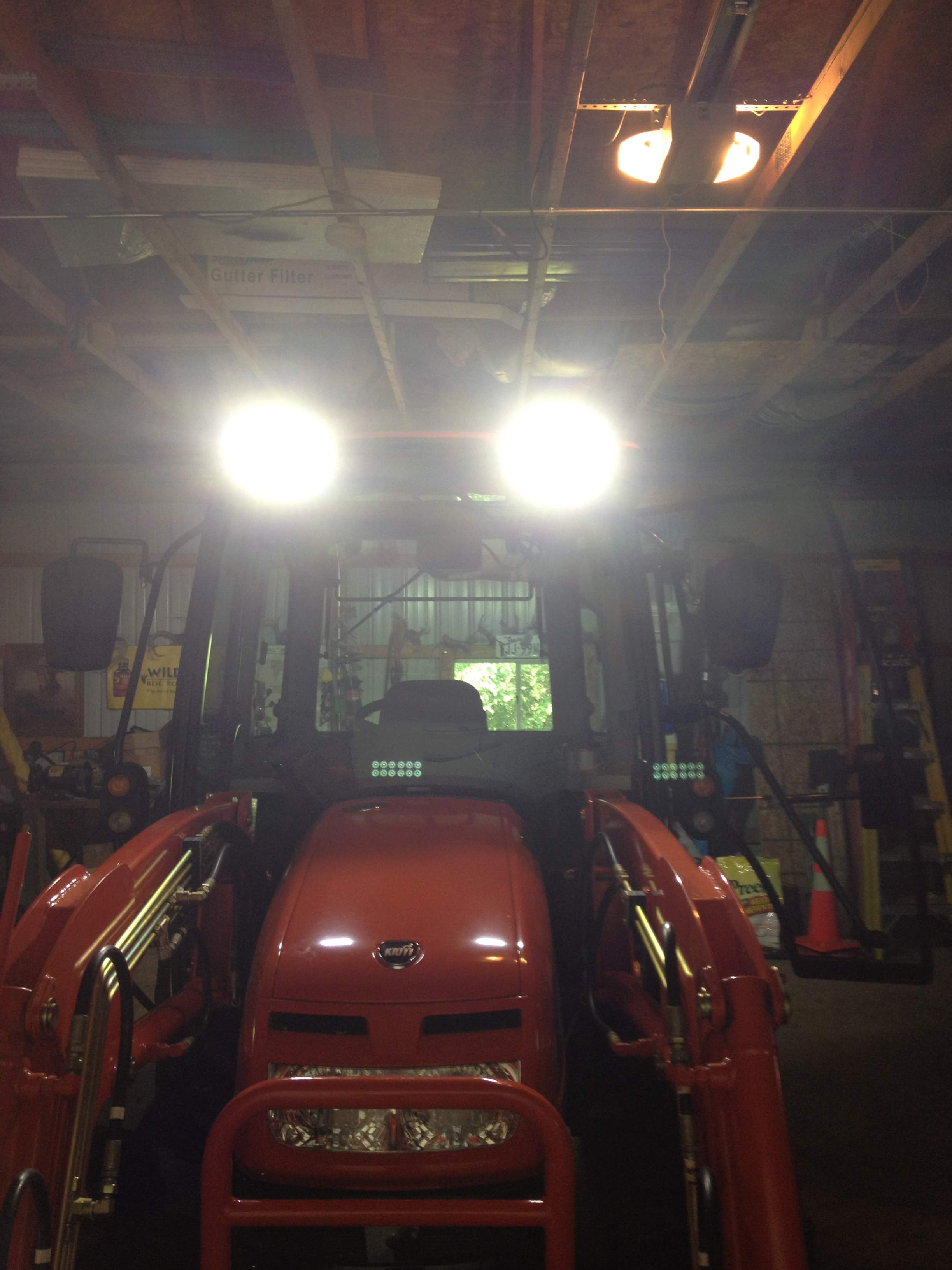

Hard to beat the cree LEDS.I have added them to my tractor and Kubota RTV 900.
