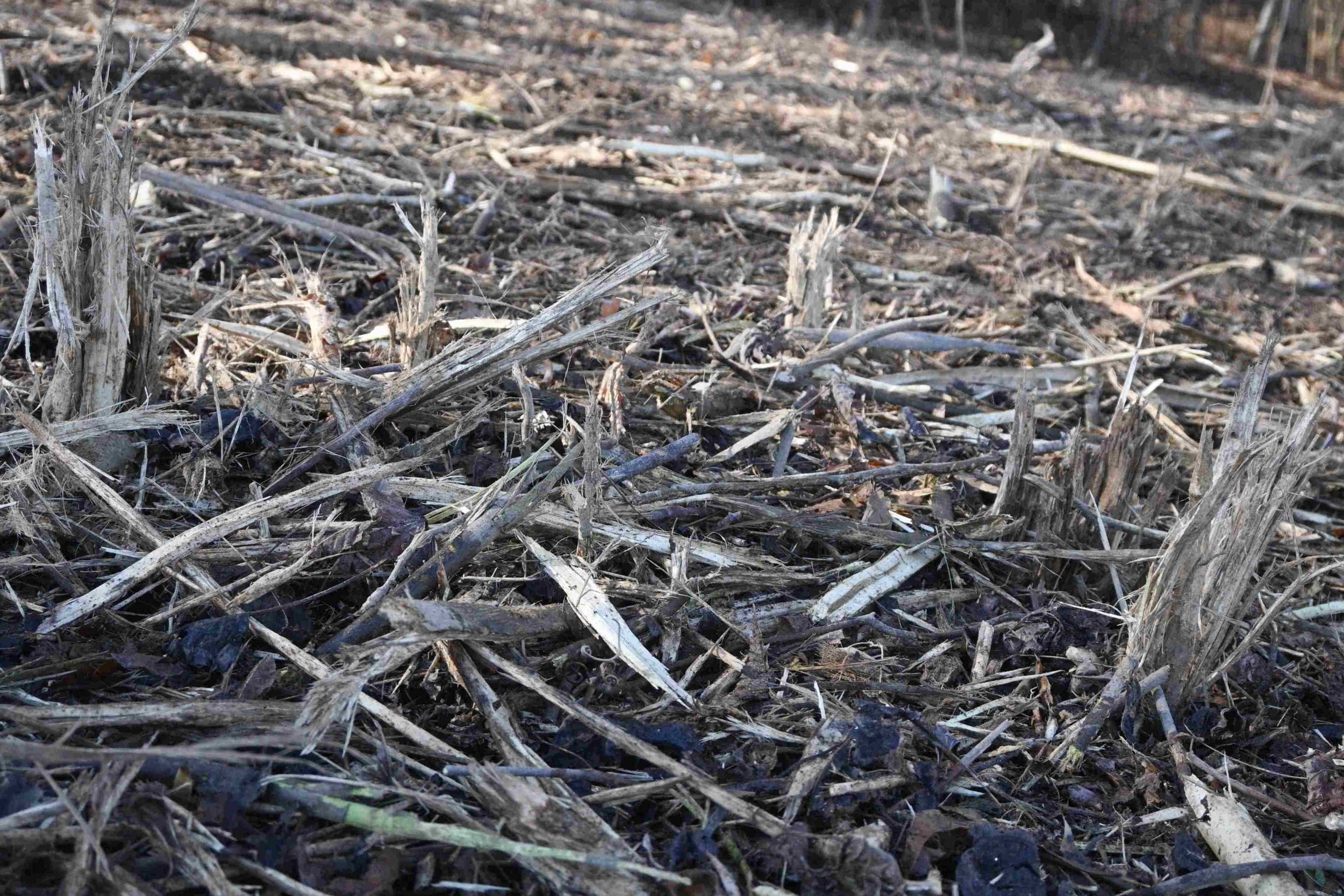

If you get the F-3680 I would just mow over it several times at good height to chop it into finer bits and leave it where is. (Always mow at full throttle.) The F machines are industrial-rugged, but not so easy to change cutting height often. (do not need tools, just fiddly!) I settled on about 4" for everything all year and just call it 'Mowed Paddock'.... works fine here for us! Even set my JD 22" SP mower the same for around-house edging and trim. Cheers, Rip

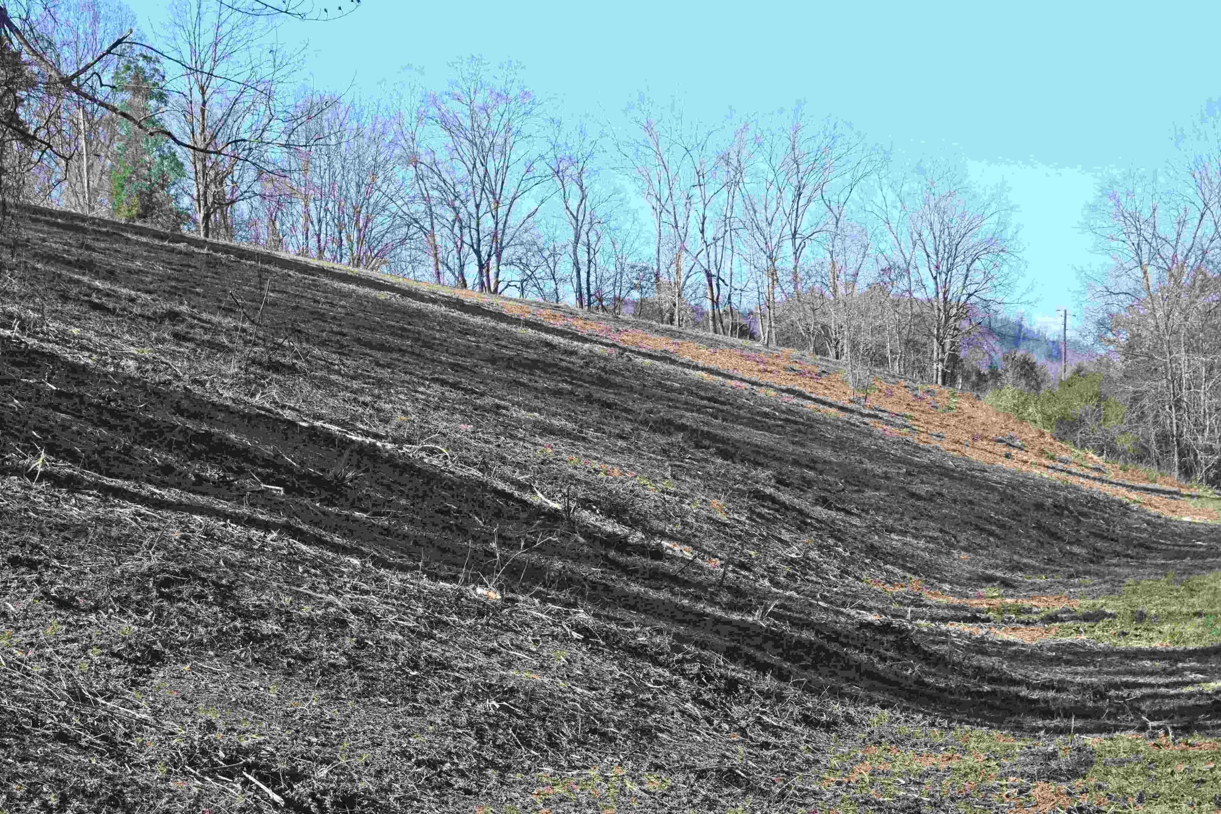

I have 5-6 acres of hillside some with 25 degree slopes to mow. Local kubota dealer has a 2012 F3680 4wd with 2300 hours for $9,000 …
Wondering if this is something that would work or should I put that money towards a Ventrac or Power Trac instead?
What did you end up going with to keep this bank mowed ?

Power trac pt1445 but am still in the break in period so I don’t quite have an opinion if it was the right choice for these slopes. Already had to upgrade the Oem wheels on the mower deck and fabricate a debris deflector. But not enough hours to have a real opinion yet.
