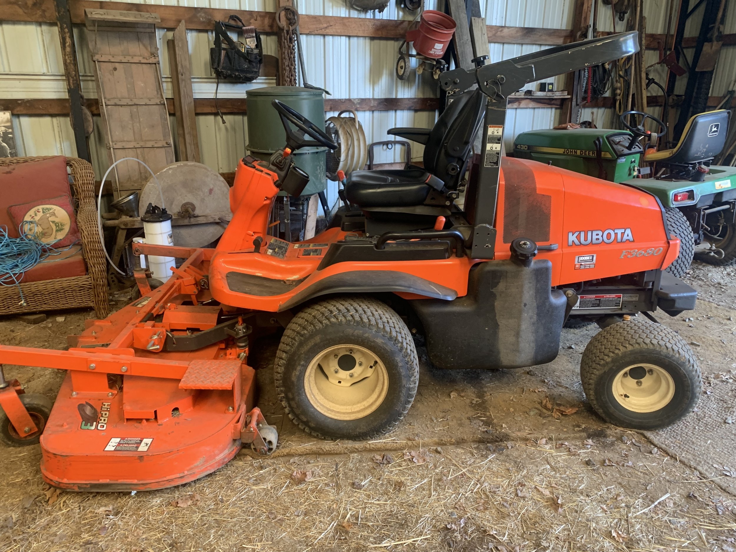

I have 5-6 acres of hillside some with 25 degree slopes to mow. Local kubota dealer has a 2012 F3680 4wd with 2300 hours for $9,000. Apparently, I can get a 63" Perruzo flail mower for about $6,000.
Wondering if this is something that would work or should I put that money towards a Ventrac or Power Trac instead?

I have one and it’ll climb a wall. It’ll also descend steep slopes safely. Excellent traction up & down steep hills. Sideways on a hill is also stable, but it will tend to “crab” a bit, requiring steering adjustments.
Take a picture of it and post it.

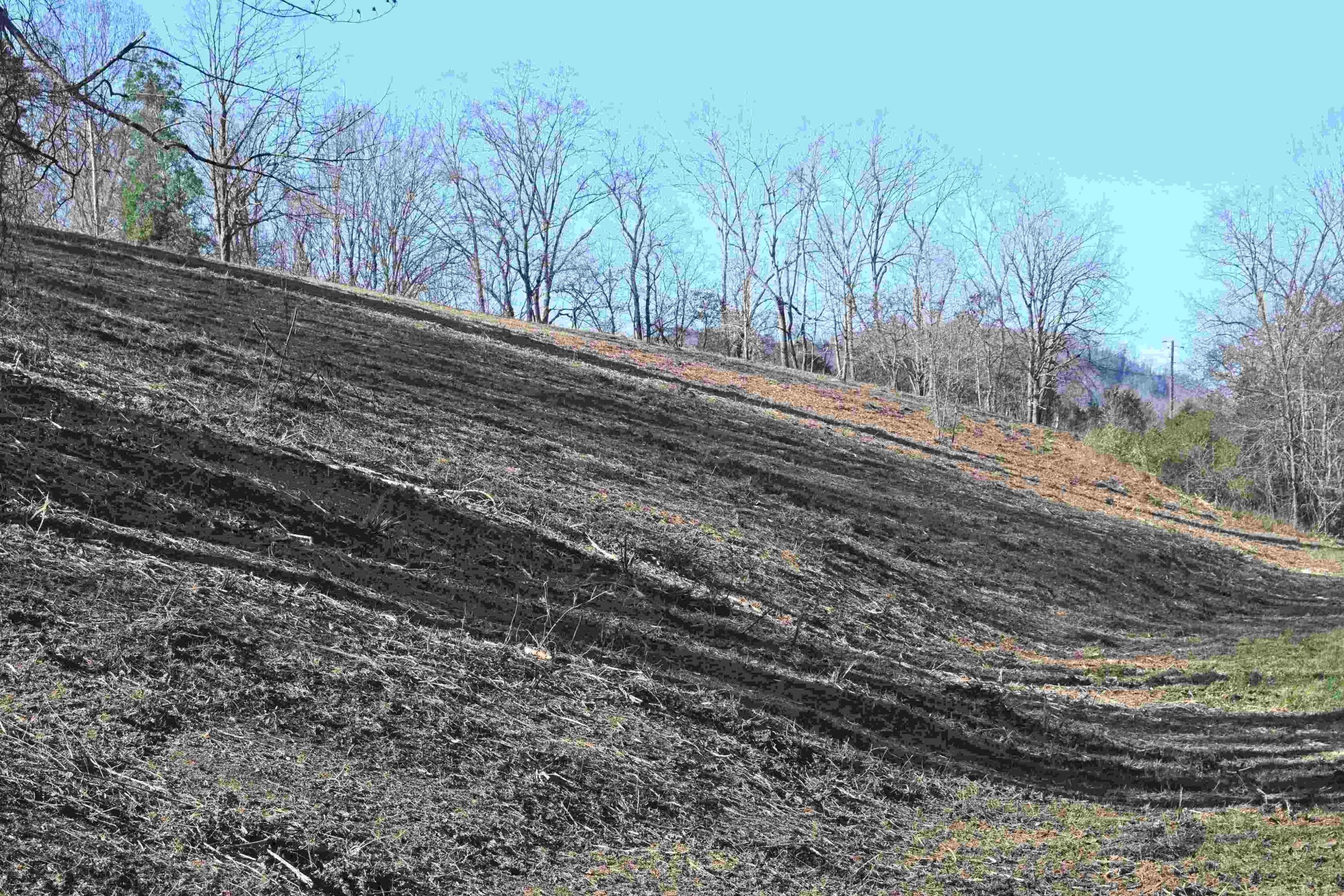

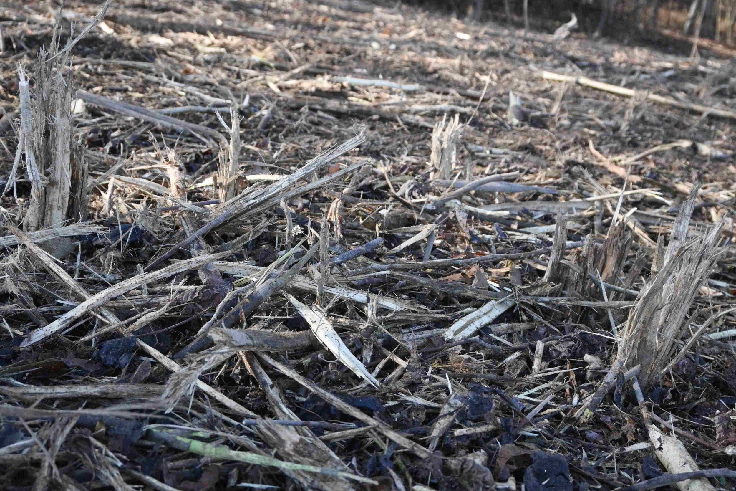

I'm posting a couple of pictures after the forestry mulching was done. The operator told me where the slope felt the worst to him. One of those areas measures 32.7 degrees near the base of the hillside.
Kubota doesn't publish any official slope rating that I know of. I think I recall that one TBN members posted he had mowed a grassy lawn slope was 27.4 degrees.
There is now about 4 inches of mulch material on the surface. Additionally, the mulching left behind some shattered tree residue including shattered nubs of tree stumps.
Starting to wonder if this is just too much for a F3680 with a finish mower and turf tires in terms of steepness and rough field mowing conditions?

Is a clean up of the shreddings possible with a landscape rake?
That doesn’t look as steep as some of my steeper clients places, but I wouldn’t want to run anything better than a set of junk mower blades through that debris.
Clean up into piles with landscape rake and burn?

The company that did the mulching has a root rake grapple for their Cat 299d and might possibly do it, but I didn't ask them about doing it. I personally wouldn't want to get my MX5200 on that slope with a rake.
Since the F3680 finish mower blades don't pivot like brush cutter blades, I'm also concerned that both the blades and the mower spindles could get bent.
I'm also not sure about ground clearance in some areas where the mulch got piled up deeper.
Most of the wood that was mulched is poplar, gum or elm.

So long as any stumps are ground down to near ground level and no significant rocks, either of my F-Series would handle that easily with Kubota deck at about 4" and turf tires.... even without my loaded tires, 3" wheel spacers, etc.
The Kubota blades are mounted to spindles with cupped washers to let them slip if hit rock or stump.... still try to avoid.... should have no issue going over the mulched material if no really Big chunks. Blades and spindles are pretty tough, and outboard blades also belt driven, so only center blade gearbox driven by PTO, and even it is internal clutch driven.
No ground clearance issues.... I would double the rear counterweight as ass end is quite light with only the 50Kg standard. The other mods I have made mainly provide additional stability and peace-of-mind on my significantly steeper sections.
Happy New Year and Good Luck.... Rip

I’d also want to clean up those chips as they will soak up all the moisture off the ground, inhibiting grass roots from growing.
