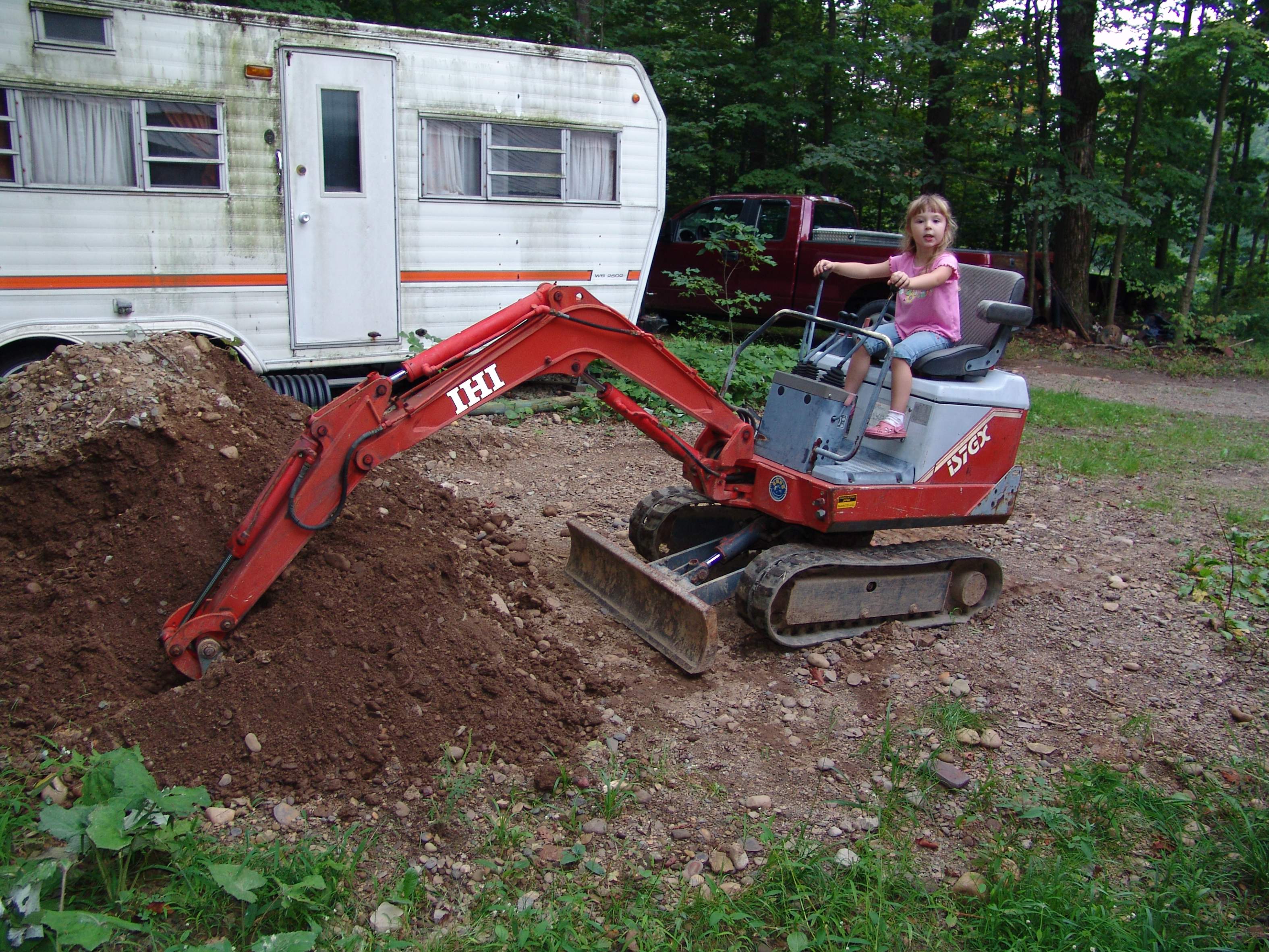

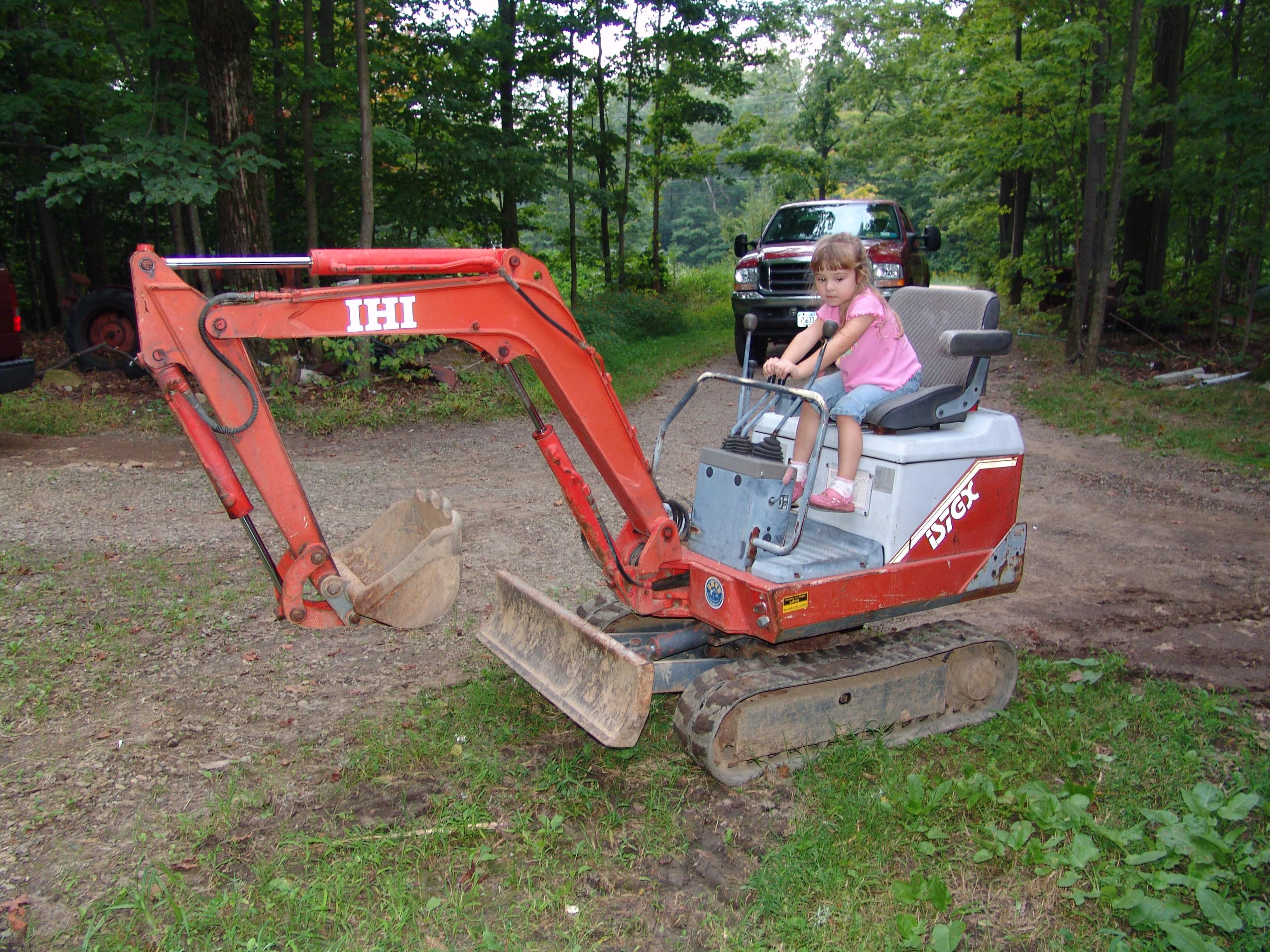

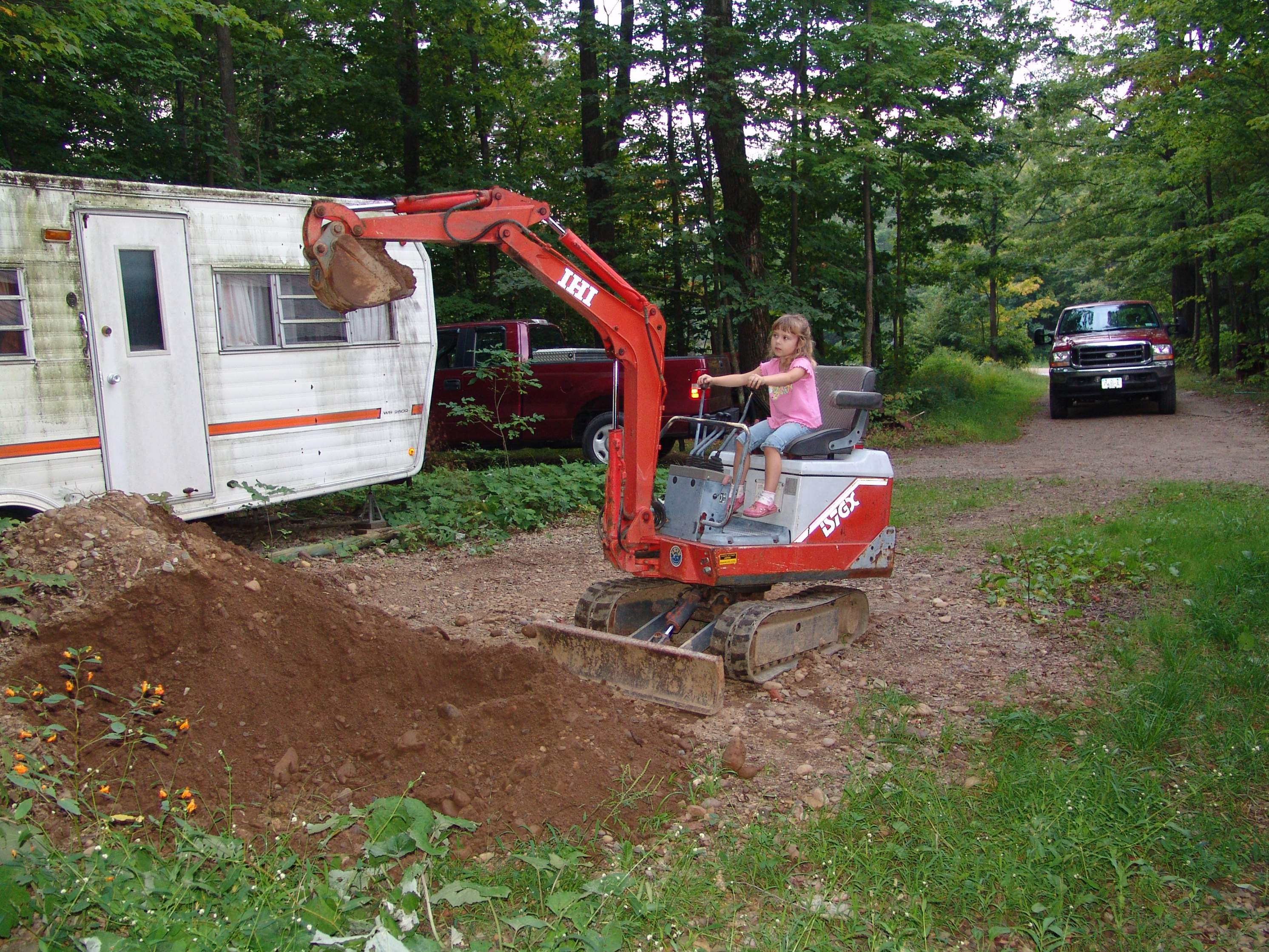

My grandfather has an IHI 7gx that I have used before. I will say this, it is better then a shovel and has its uses but this machine is extremely limited and is very tippy feeling. I would look for something a little larger if you could. I have used it to dig out a few stumps (took a long time), dig a trench to run power to the barn, dig a grave to bury a dog and have used it to muck a horse stall that was extremely deep from a long winter of no way to clean it out of there.
As I said, it is better then a shovel but is a limited machine. It weighs 1 ton and would be good for your tasks as long as your not in any hurry and do not need any deep holes or trenches dug. We hauled my grandfathers home for him in the back of our F-250. I would imagine it would be comparable to a small 3pt hoe as far as dig depth. 001.jpg004.jpg015.jpg
As I said, it is better then a shovel but is a limited machine. It weighs 1 ton and would be good for your tasks as long as your not in any hurry and do not need any deep holes or trenches dug. We hauled my grandfathers home for him in the back of our F-250. I would imagine it would be comparable to a small 3pt hoe as far as dig depth. <img src="http://www.tractorbynet.com/forums/attachment.php?attachmentid=295938"/><img src="http://www.tractorbynet.com/forums/attachment.php?attachmentid=295939"/><img src="http://www.tractorbynet.com/forums/attachment.php?attachmentid=295940"/>
Cool pics! I just spoke with the seller and he already has a check in hand from another buyer. He will let me know if the sale falls through. I will continue to look for an ex but after reading the responses, I might go a little bigger than the IHI 7gx.
