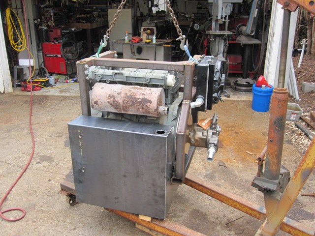

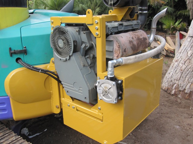

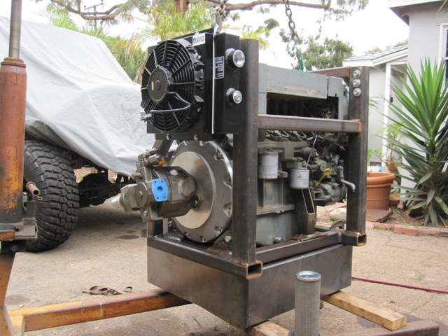

couple shots of power unit:

Lumberjack,
So far only 145 hrs on the system, cutter head and pack have been flawless.
Hard to keep it busy in this region.
Most of my work has been with local county fire doing fuel brakes. But that been limited due to concerns
for wildlife and habitat destruction, wood rats, mice, lizards etc. I guess they aren't affected by wildfire...
California.....
/ Excavator power pack #18
I'm contemplating a power pack for my 13klb excavator.
Have you found the additional weight/tail swing hard to work around/with? The weight should increase stability and help offset some of the swing torque on hills.
/ Excavator power pack #19
Haven't had an issue with tail swing, and yes, I think the added weight helps offset weight of cutter
