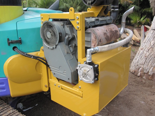

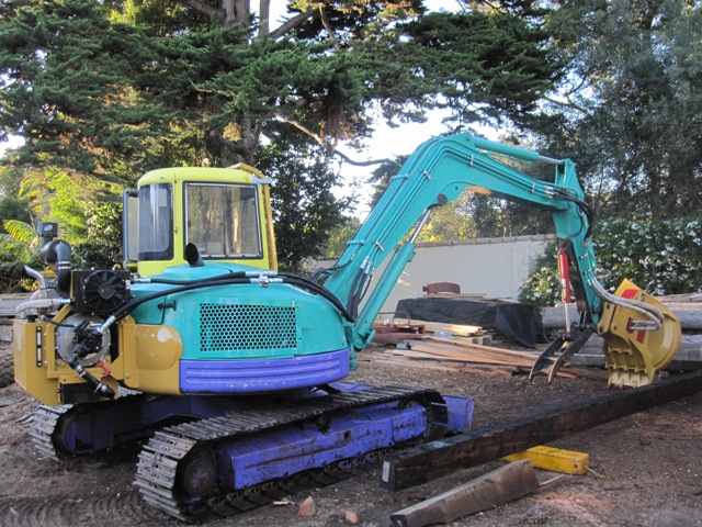

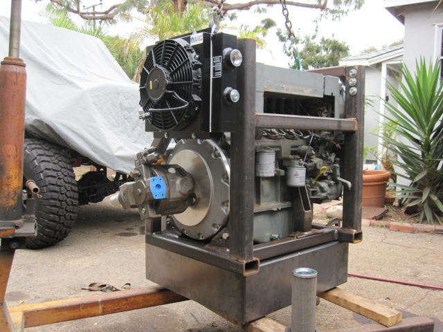

Just finished 15 hrs of mulching with a power unit I built for a "midi" excavator
Running an AFE RDM 34
power unit is a Deutz 4 cyl 54 hp running a Rexroth variable pump
plummed directly to head
Surpassed all of my expectations!
Now, to keep it busy, any suggestions?

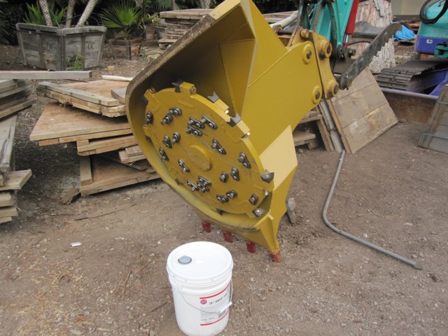

Is that a new head? I noticed it doesn't have any bullet teeth on the bottom of the disc, just the thumb nail teeth. Ours also has the bullet teeth, but it's a RDM44.
It will take some practice to get clean results with the head, but once you get the technique down you will like it even more. It's great to be able to move logs, rocks, piles or metal, refrigerators, and everything else you find in the woods and not worry about bending up the head. We can pull smaller stumps with ours, shake off the dirt, then mulch the stump.

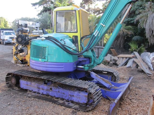

One major design flaw to address - blade hits hyd tank when all the way up:confused2: One good swing with the blade completely up would be disasterous
Re: guards and screens: I was very surprised how little debris and dust makes it to the machine, ran with the cab open all day, air cleaners show no dirt. not like a
skid steer type head that puts you right in the thick of it. Tank is the most exposed part of the machine therefor I built it out of 10 guage, need to work up a guard for the oil cooler on the deutz though

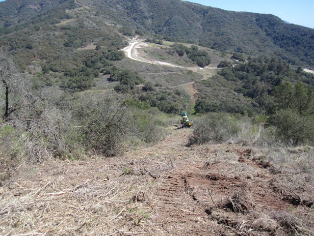

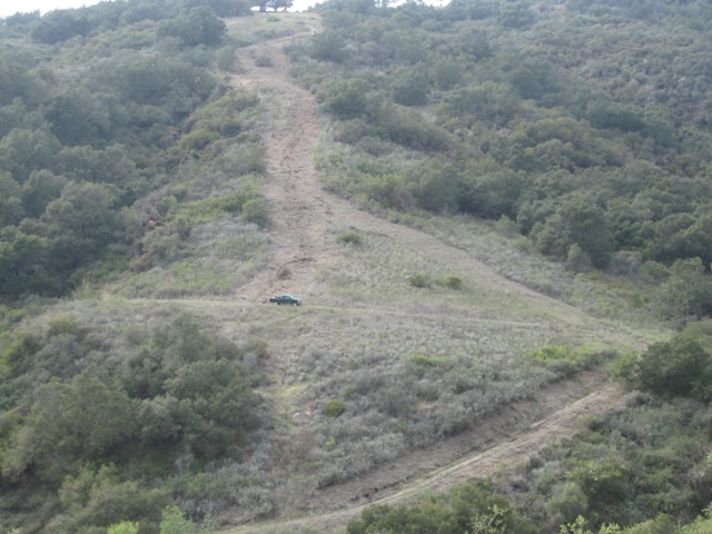

Here are a few photos of the days work:
First shot, completed break - three passes.
Second shot, first pass heading down blind and steep, took a little getting used to. chip quality looked like **** but improved considerably as the day progressed, also got better at tracking without ripping the place up

Here is a shot of the top of the 34 Gen-3 Has quadco teeth on top as well as opposing quadco teeth (5) mounted stationary to the inside of the housing opposing the disc teeth, you can just make out the bolt heads on the discharge side of the housing. not sure when he started with this setup
As you can see, thumbnail teeth (carbides) on top share the same pockets
as buttom teeth

Looks the same as ours except a little smaller and we have the bullet teeth and thumbnail teeth on bottom. Ours was built last July/August. Try to engage small trees with the 10 o'clock portion of the disc. With practice you will be able to cut them off however high you can reach, and suck the top of the tree into the shroud on top of the disc at the same time. It helps to slow the disc down if you can with your setup. Ours is ran off of the pilot control so we can run at any RPM we want just by adjusting how hard you press the pedal. This really speeds things up vs chasing all of your tops after they hit the ground. Same principal, even when material is on the ground try to get it into the shroud on top of the disc instead of using the bottom. The opposing quadco teeth are much quicker.

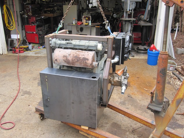

couple shots of power unit:

Hey as long as it works this day in time simple is better in a world that complicated. When I buy a ex may get up with u to help me build a pack for mine.

I'm contemplating a power pack for my 13klb excavator.
Have you found the additional weight/tail swing hard to work around/with? The weight should increase stability and help offset some of the swing torque on hills.
/ Excavator power pack #19
Haven't had an issue with tail swing, and yes, I think the added weight helps offset weight of cutter
