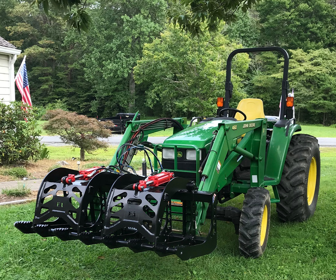

I took my Wicked Grapple off to use forks the other day. When I re-installed the grapple today, I could not connect the hydraulic hoses as the grapple side was under pressure. When I loosened a pipe fitting on the grapple, to relieve the pressure I could make the connections.
What is the correct way to relieve the pressure when disconnecting the grapple?
/ Everything Attachments #1,867
Before you take your grapple off, shut your tractor off. Then turn ignition to "on" but don't start. Cycle your grapple open / close electrical toggle a time or two. Then disconnect hoses.
/ Everything Attachments #1,868
The pressure inside the cylinders and hoses on your Grapple is dependent on the outside temperature difference between when you disconnected and when you are trying to reconnect. Hydraulic fluid expands with temperature as do most fluids. So you may need,to relieve the pressure as you mention. On the tractor side, shut down and cycle all the valves to relieve pump pressure to the tank.
I try not to store my Grapples in the sun to minimize that from warming up the fluid.

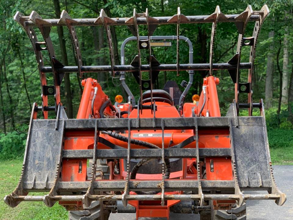

If it's a 60" Wicked Root Rake Grapple, I'd store it fully open and face down. Cylinders will be retracted and lid will be bottomed out.
Like this, fully open..
If it's a long bottom 60" Wicked...fully closed.
Those are the positions which will prevent gravity from building pressure. If you're a chemist, I"m sure you've forgotten more than I ever thought about learning concerning expansion due to temperature. :laughing:
Travis

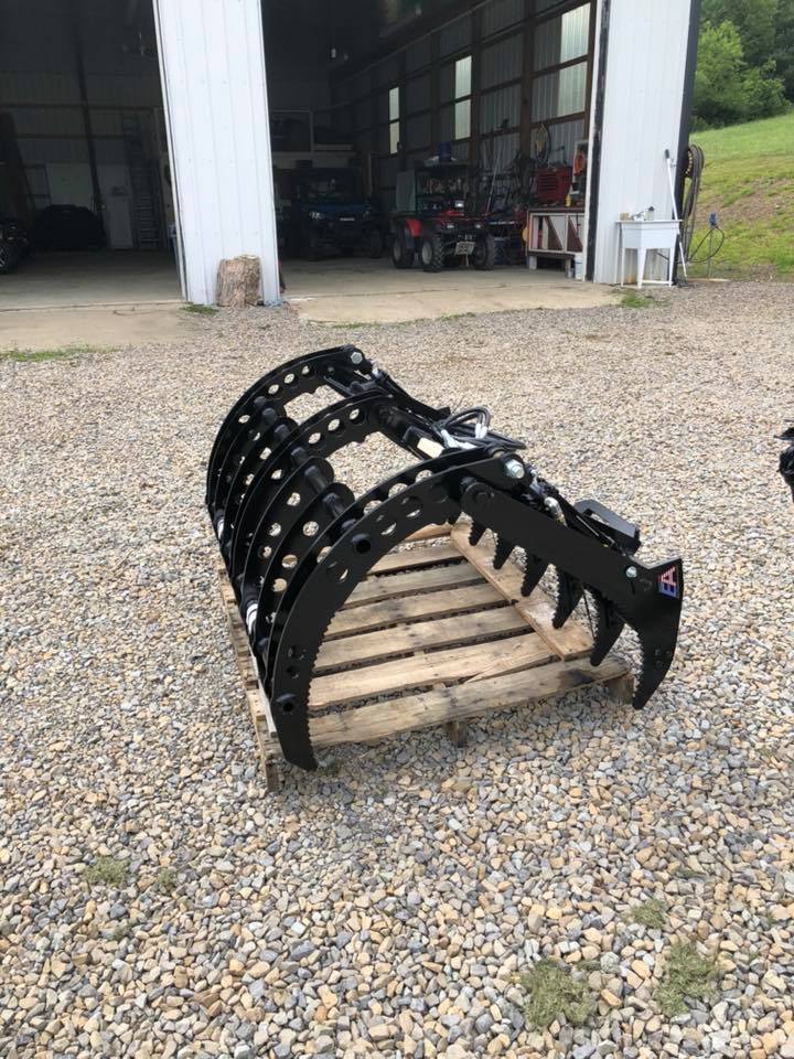

Achievement Unlocked! Wicked 60" Root Rake Grapple earns "Old Man" seal of approval!
Got my 3rd function valve from MIE installed today. Hooked my new Wicked grapple onto the tractor, and headed behind the house to clean up some dead trees we had cut down. Judging from the 6 minutes I spent on the machine before being kicked off by my 75 year old father, I think I'm going to like it. Dad definitely likes it! That thing closes with authority. The dead pine tops he was piling up were snapping like toothpicks when he clamped the grapple down on them, and he was smiling the whole time! Its his new favorite attachment! I'll have to sneak out with it sometime when he's not around to get a little playtime with it myself! He was raised on a farm, spent untold time with tractors and implements, so when he brags about any "new" piece of equipment, you must be doing something right!
