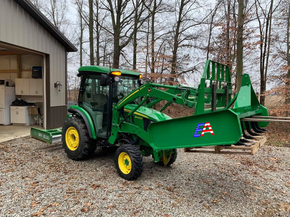

Check out what's on the rear of his tractor in this pic, which was taken when he first received it...

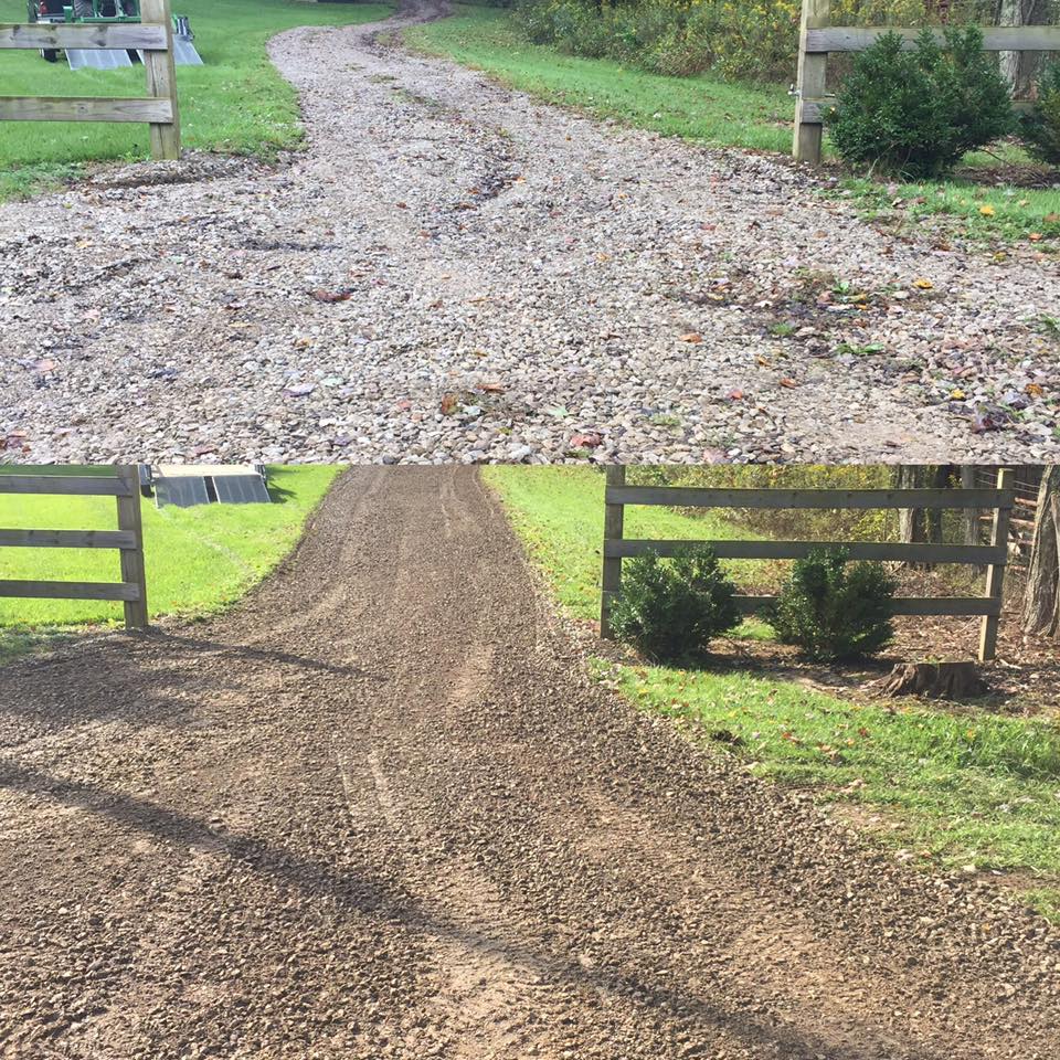

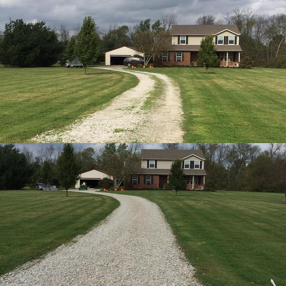

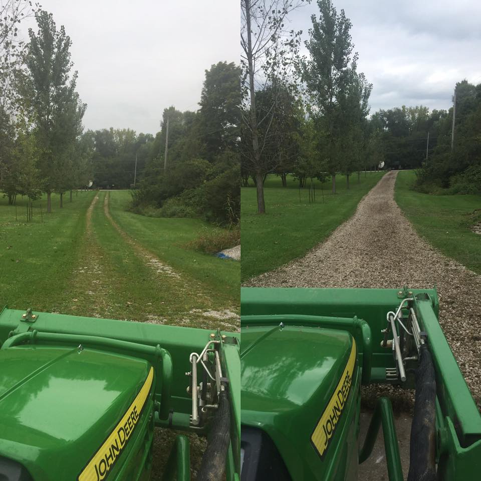

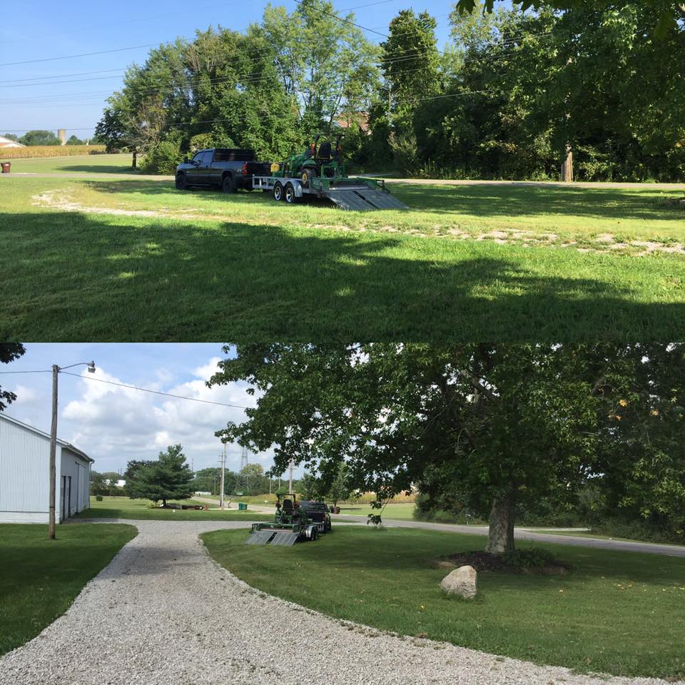

Before and after pics

some of those "after" pics HAD to of had new gravel put down, right? a land leveler works that good?

eubie5 : Not necessarily . Several of those before and after pictures are exactly like what my driveway would look like before and after , running my homebuilt land plane , several passes up and down it . We use a blue , crushed 3/4" shale , from a pit just down the road . Driveway is 800+ feet long . First 50 - 60 % is flat , with just a couple of feet elevation change . Last 40+ % starts out mild then increases to a 14% grade at top . My home built is 7' wide , by app. 8'+ long .
Really the only issue We have with Our drive , is every 4 to 6 years , We have usually 2 loads brought in to " Cap " the driveway , more to keep the dust down than anything . This past summer , Driver did good . But 5 years ago , the contract driver had No set chains on his tail gate , Thus when he was spreading and hit the steepest part of the grade , Poof . Instead of a maybe 2" cap , I had 6" to 8" thick blob for 75 to 100' . Been working the last 4 years dragging that excess either down the hill or up depending on were I wanted it . To move rock , I drop my front blade down 1" below the bottom of the side skids . To just " Touch up " the driveway , I have both the front and back blades set right at skid level . When in touch up mode , Our driveway will start out like the pictures with the grass growing down the middle . After 2 passes up and down , it will look like the after pictures .
