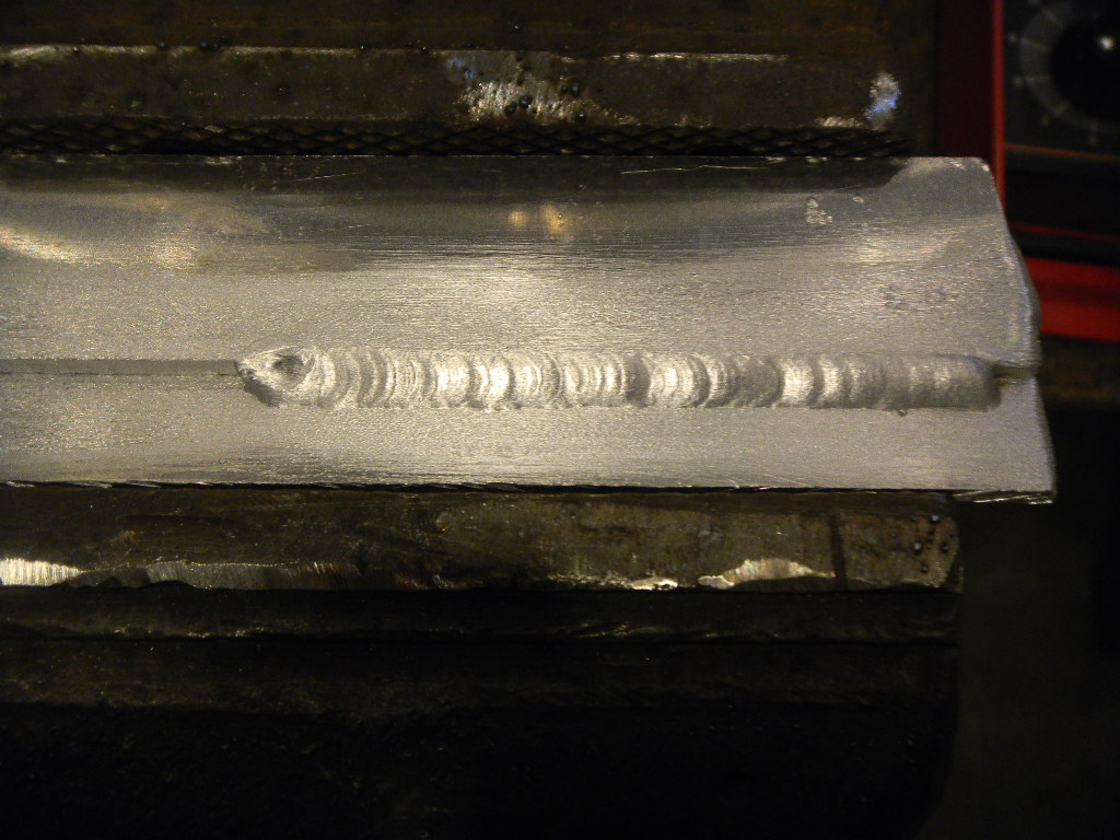

Huh I felt it was pretty mediocre been awhile since I walked a cup. <img src="http://www.tractorbynet.com/forums/attachment.php?attachmentid=467316"/>
I'm searching for a 'Bow Down' animated emoji to post.
