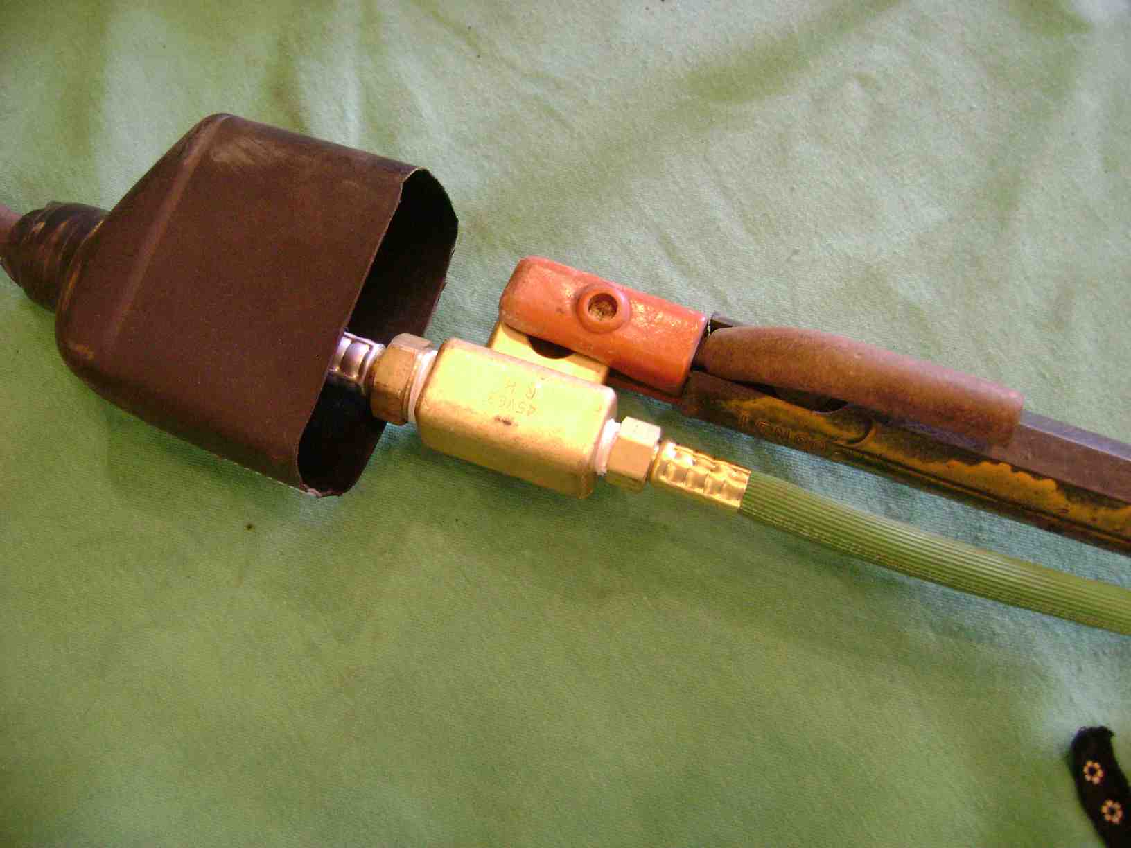

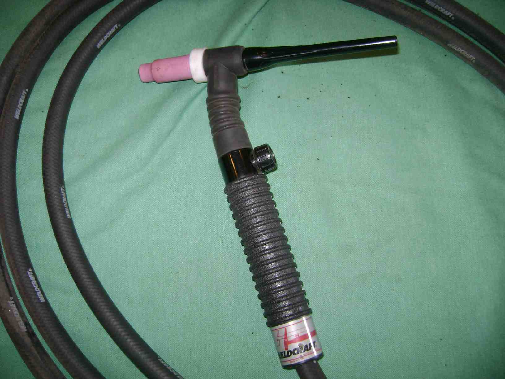

I found a little 17V Tig torch on Northern tools that had a proper dinse connector so I did not need the power block, it just plugs in to the front panel of the 160. The regulator came from an internet welding supply, and the argon cylinder I bought locally.

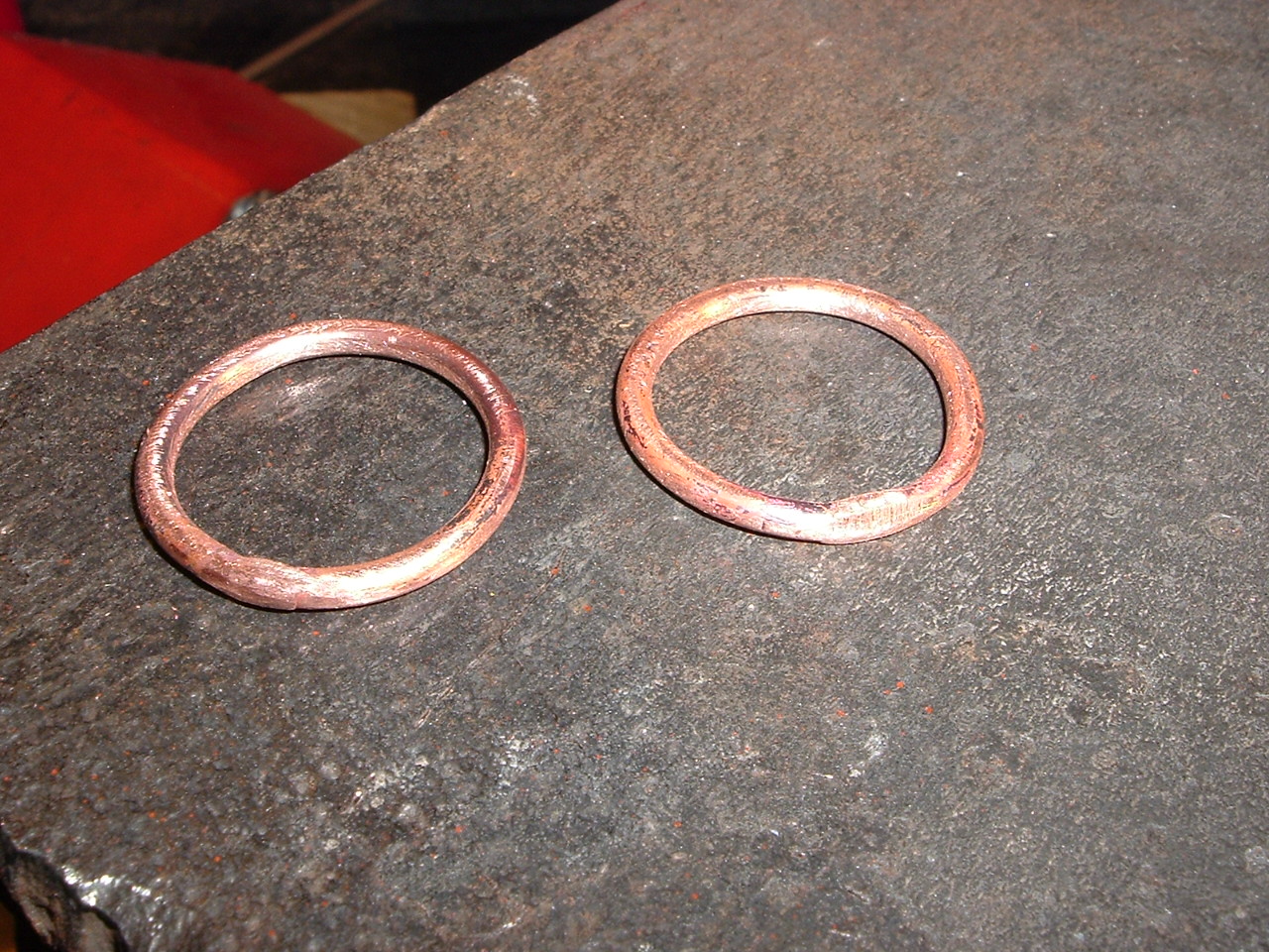

Shown below are some things I have put together, like the small chain I built to hold a retaining pin on an implement, and the extension of the control valve for my rear remotes. And the repair of a broken hook that came off of my ballast barrel. Also shown are some copper crush washers I made out of 10 gauge copper house wire. Just TIG the ends together and away you go. DC TIG works well for copper and brass, not aluminum though. Although Shield Arc points out you can do it with helium gas.

All the work you see is scratch start and no pedal (wish I had one). The copper washers were really interesting. What you don't see is there were originally 4. I messed up the other two. But I only needed 2 so I came out OK.. :)

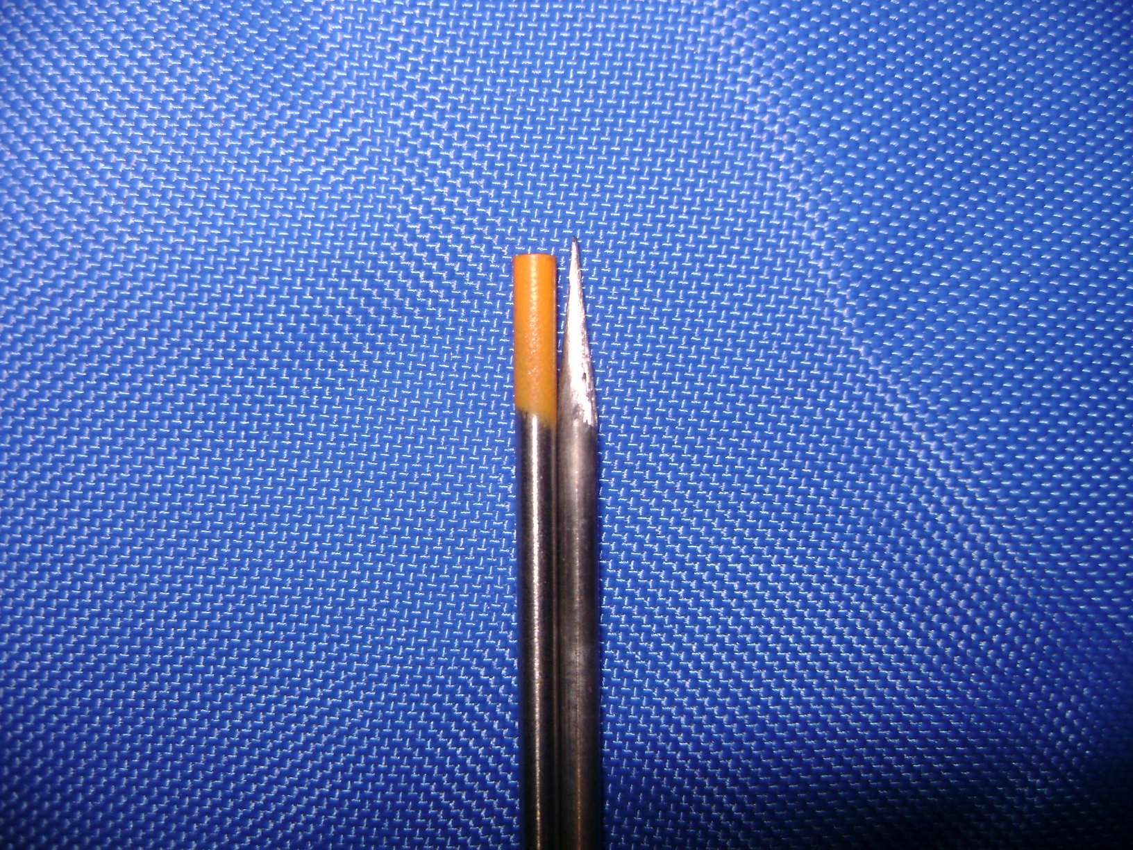

I have been using Lanthanated tungstens. (blue)

I got to the point now I use Ceriated tungsten for everything with these inverters.
Never tried it they did give me some purple tungsten to try once and I promptly threw it in the trash, it didn't do anything good AC or DC.

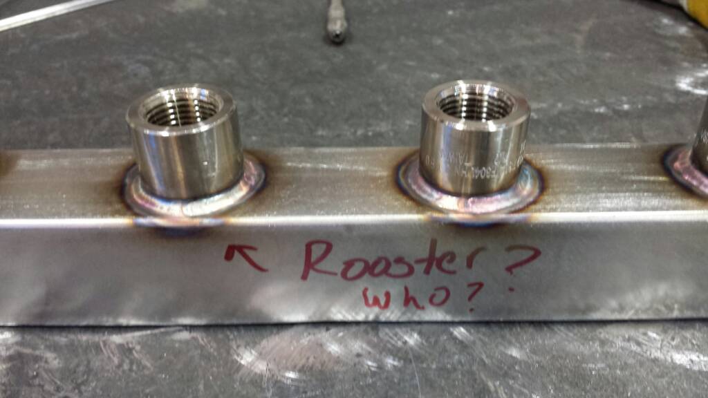

Ok so said I would tig some with this machine but since life has gotten in the way and I just got around to it tonight to do a little artsy project for the wife. Only had some carbon around so I ran two quick passes on it with a bevel. Pretty satisfied with it actually the starts are really nice for a scratch start but I still stuck it plenty due to lack of practice, a foot pedal will ruin you for sure.
3/32 70-s6 130 amps walking the cup.
First pass
Cap pass if you will.

WOW aarolar that is some very nice Tig welding! :thumbsup::thumbsup:
