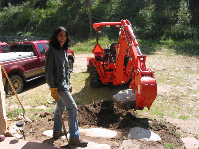

OK, first of all, I've always been a tractor guy, but got into TLBs almost by mistake when my wife said it was time for a new tractor. I was floored when she said that, but didn't dare argue - and so off we went on a new tractor hunt. After several "ecstatic"? weekends looking at tractors & not seeing what we wanted, it finally dawned on me that I wasn't raising crops anymore. In fact the work we were doing on our land had more in common with landscaping.
So we started thinking about landscaping and that led to TLBs. Both tractors and TLBs of roughly the same size often share a common engine and transmission. But there are lots of differences.
Comparing tractors with TLBs, the tractor was originally designed to be a pulling machine. It evolved to optimize pulling implements, which is why the 3pt hitch was so important, and why all tractors have them.
Eventually tractors became better & better at pulling. Concentrating on pulling ability dictated things like how the tractors weight is distributed, the transmission type, the size of the rear & front tires, tread type, the control layout, and even the way the frame is stressed.
The evolved tractor is so versatile today that it can even hold a backhoe and work a front end loader as optional implements on each end - Even though it isn't really designed for either. It was designed to pull implements with its 3pt hitch.
The TLB (Tractor/Loader/Backhoe) was originally designed around a loader at the front and a backhoe behind. It evolved as a pushing machine because that is the best use of the front end loader. And it had to be stout to withstand backhoe forces. A TLB typically has a much stronger frame and more stability because the TLB's weight distribution, transmission, drive train, tires, controls, and frame are designed to support pushing, lifting, and carrying things with the frame mounted front end loader on one end, and then by reversing the seat the operator can still operate some tractor controls along with the frame mounted backhoe. Both the FEL and the BH can be somewhat larger than a similar tractor because of heavy TLB frame.
Then by un-hooking the backhoe the the TLB can quickly mount a 3pt hitch and become a pulling machine - much like a compact tractor can drop its 3pt hitch and mount a backhoe and subframe for digging. It's about the same effort to swap either way.
So a tractor can drop its 3pt and mount a backhoe with a subframe. And a TLB can drop its backhoe and mount a 3pt hitch. Each one does what it is designed to do very will - and each is versatile to do a decent amount of what it wasn't originally designed to do.
Some TLB downsides: Kubota is the only company currently making a compact TLB, and the overall heavier, more stable construction of the TLB that makes work as it does also makes it more expensive than a similar sized tractor. An upside is that Kubota makes very good and reliable TLBs - the B26, (L39), L47, and M62.
