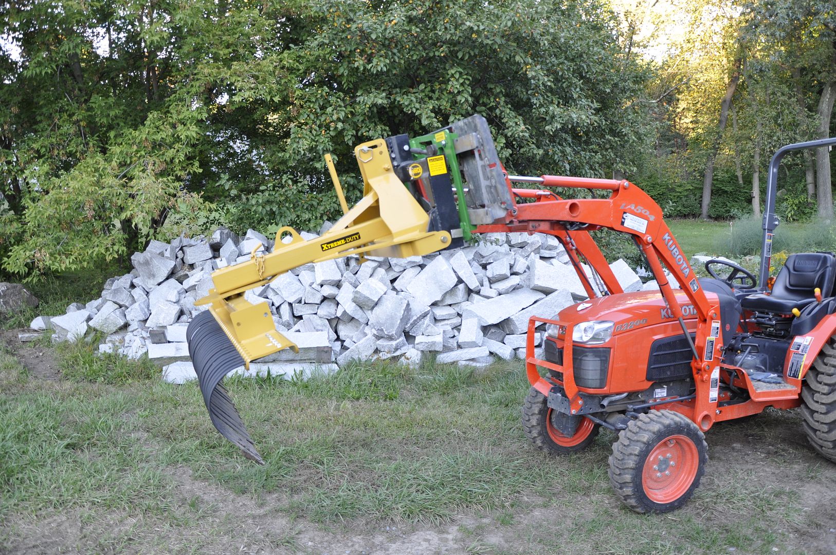

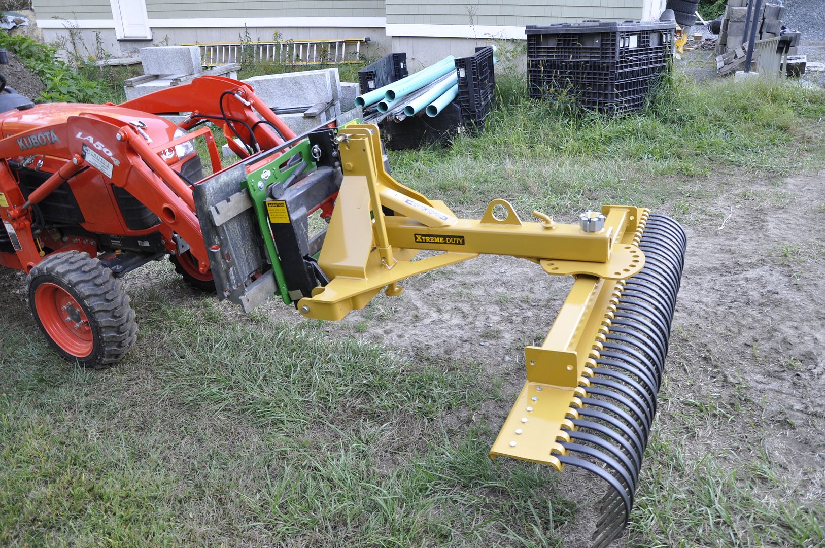

I received my Xtreme Duty rake from ETA about a week ago. It sat in the trailer for a few days before I had the chance to pull it out and get it hooked onto the tractor to try it out. I had looked at Landpride and Woods and a few others because I had been thinking about getting a rake for a while - then I saw the Xtreme rake and the videos from the ETA guys and that was what helped me make the decision to go ETA.
My initial need for the rake is to grade out an embankment I need to lay down topsoil and plant grass on - it's steep enough that I wouldn't be able to do it with a 3pt hookup - so I got the 3pt adapter for the Artillian fork frame I had made up earlier this summer - and plan on mounting the rake on the FEL - and using it that way. I got it mounted up and tried it out the other day - and I'm very happy , it seems to work great.

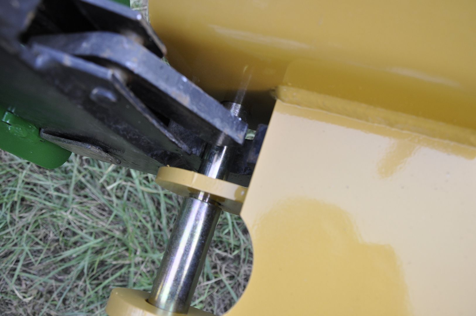

I do have question though - is there a sleeve or something available that I can install to make the rake fit better into the Speeco quick hitch I have? The Speeco typically uses a "pin" that gets installed onto the attachment - the pin is larger than the typical Cat 1 pin - I think it's Cat 2 diameter. The ETA rake fits onto the Speeco hitch - but the pins are loose in the pockets
Hopefully this pic shows what I'm referring to:
   / ETA landscape rake is a beast #31
Many farm equipment supply stores such as TSC, and etc, have cat 1 to cat 2 bushings. That may help you. the outer pin half on the rake is cat 2.
try one end of the QH to see if it fits. Otherwise if not, you will have to have one made or a bushing modified.
