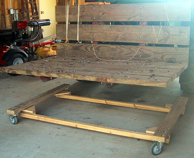

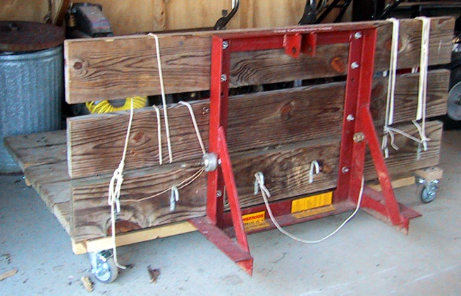

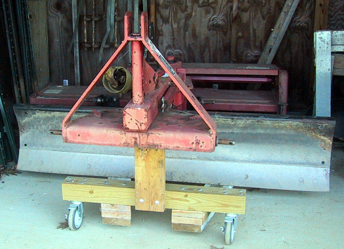

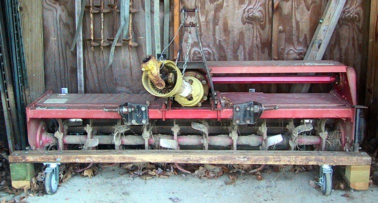

I sadly came to the conclusion that 1) I'm not getting any younger, 2) my tractor "toys" are not getting any lighter, and 3) the number of toys has outgrown the space I designed into my storage shed. As a result changing attachments was becoming a growing issue. I looked at quick hitches, but concluded they are expensive, heavy, and didn't really address the storage issue.

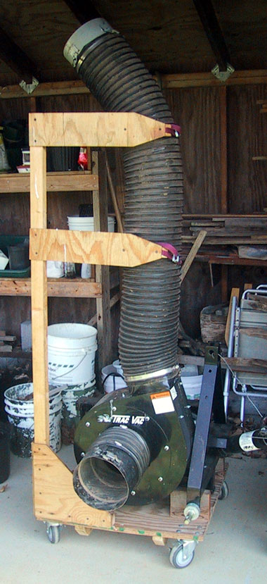

So with my 70th birthday approaching last fall I decided to finally move ahead with a long-standing idea to build dollies for most of my attachments. The photos show the result, which have been very satisfactory. I changing attachments is now much easier. I no longer have to get the tractor in just the right position, and the tools move easily to make the connections. Implements stacked in front of others is no longer an issue - I can just wheel them aside to get to the one in the rear.
Not having welding tools, I made them from scrap wood, buying only the bolts and casters. I found Caster City very helpful - they have a wide variety of types, and there is a live person who will advise on type, size, and tire type based on weight, floor condition, etc.

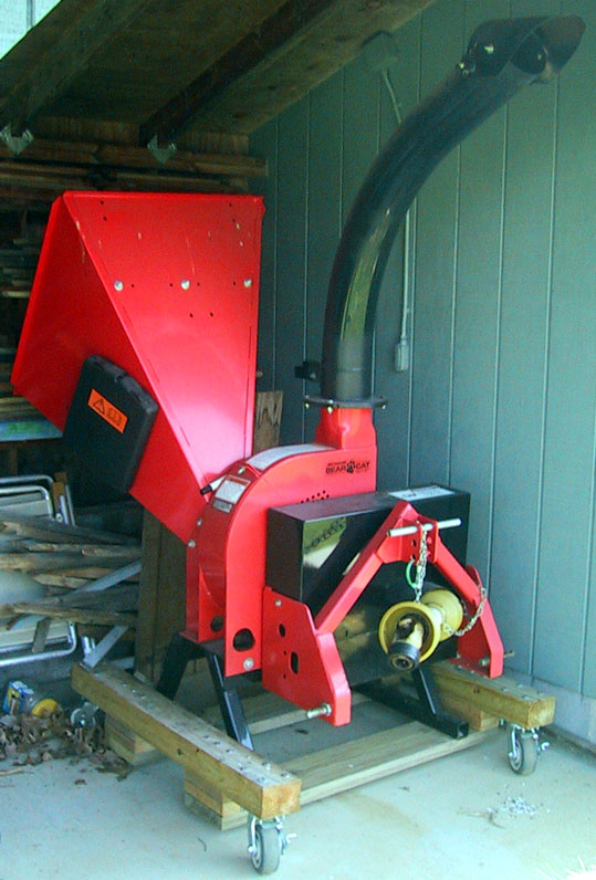

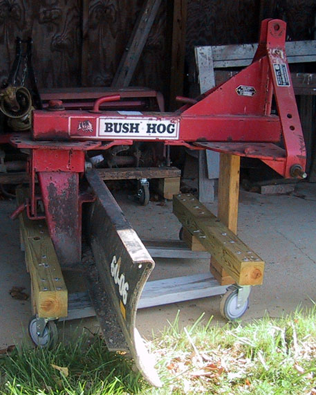

Learnings: 1) The 600# chipper is about the upper limit in weight for this approach. Even with heavy duty casters, it's a bit tough to get moving. 2) The one for the tiller is under-engineered. Even with very old hard 2x4s, they are bowing laid flat. They will get reinforced next time I get the tiller out. 3) The fixed upright on the blade dolly is less than ideal. Since I often adjust the top link to get the blade to cut as needed, when I bring it in it always needs adjustment to set on the dolly.
But all in all, they are a big improvement. I no longer hesitate to change implements for a few minutes of work.

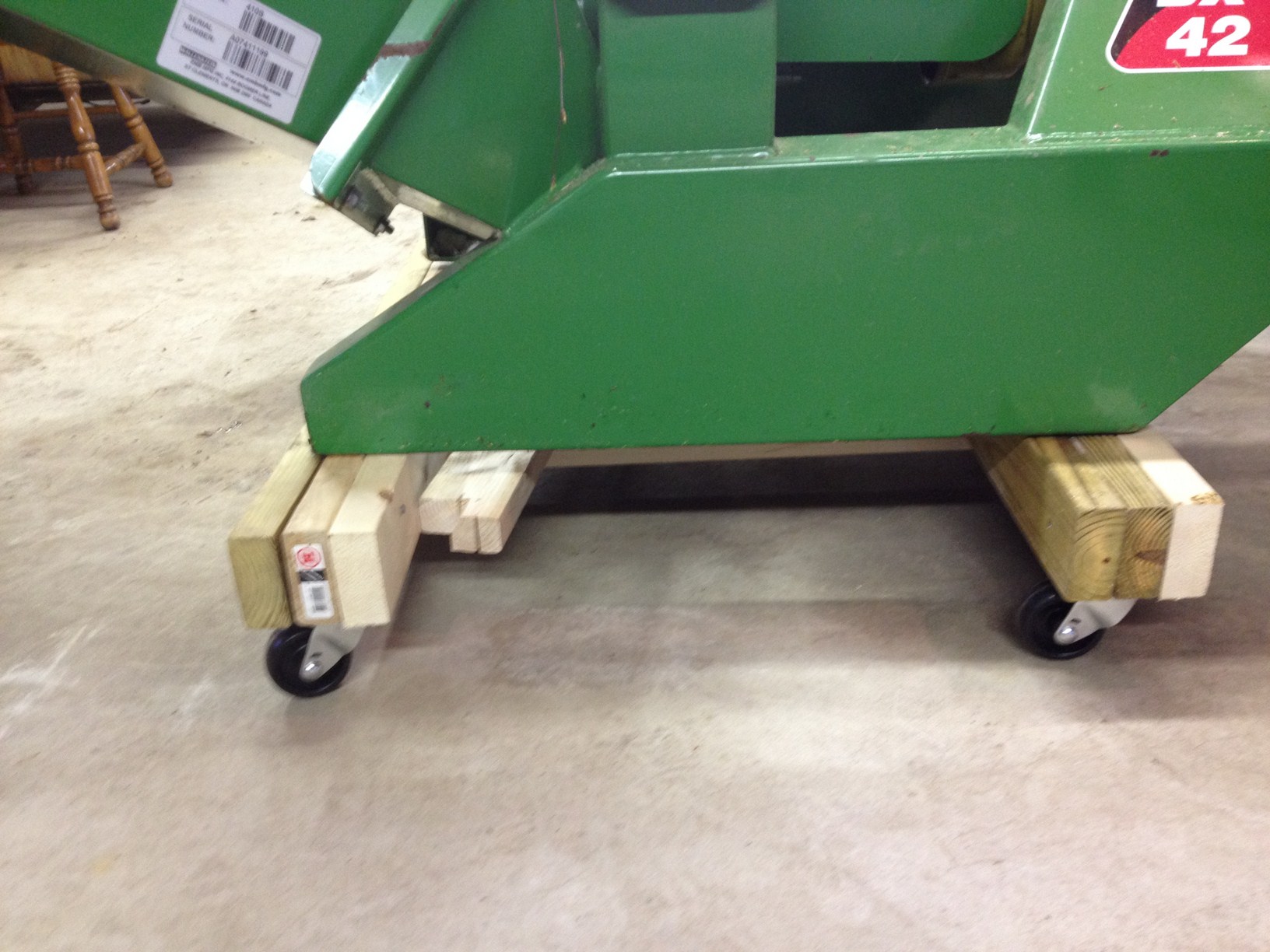

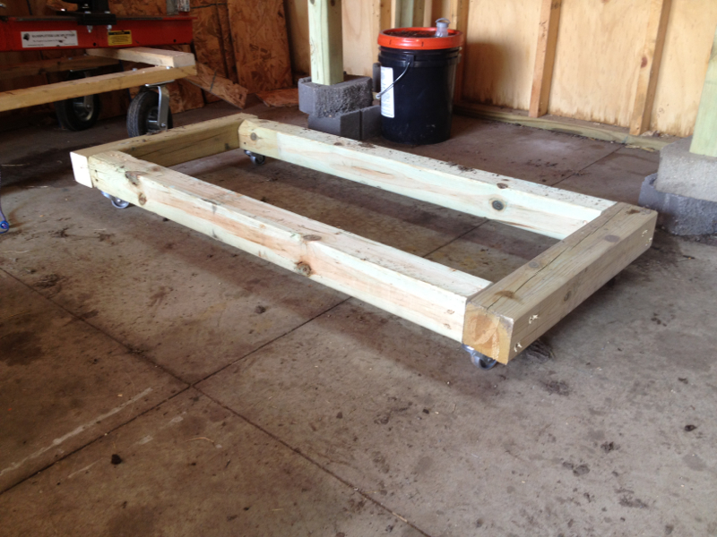

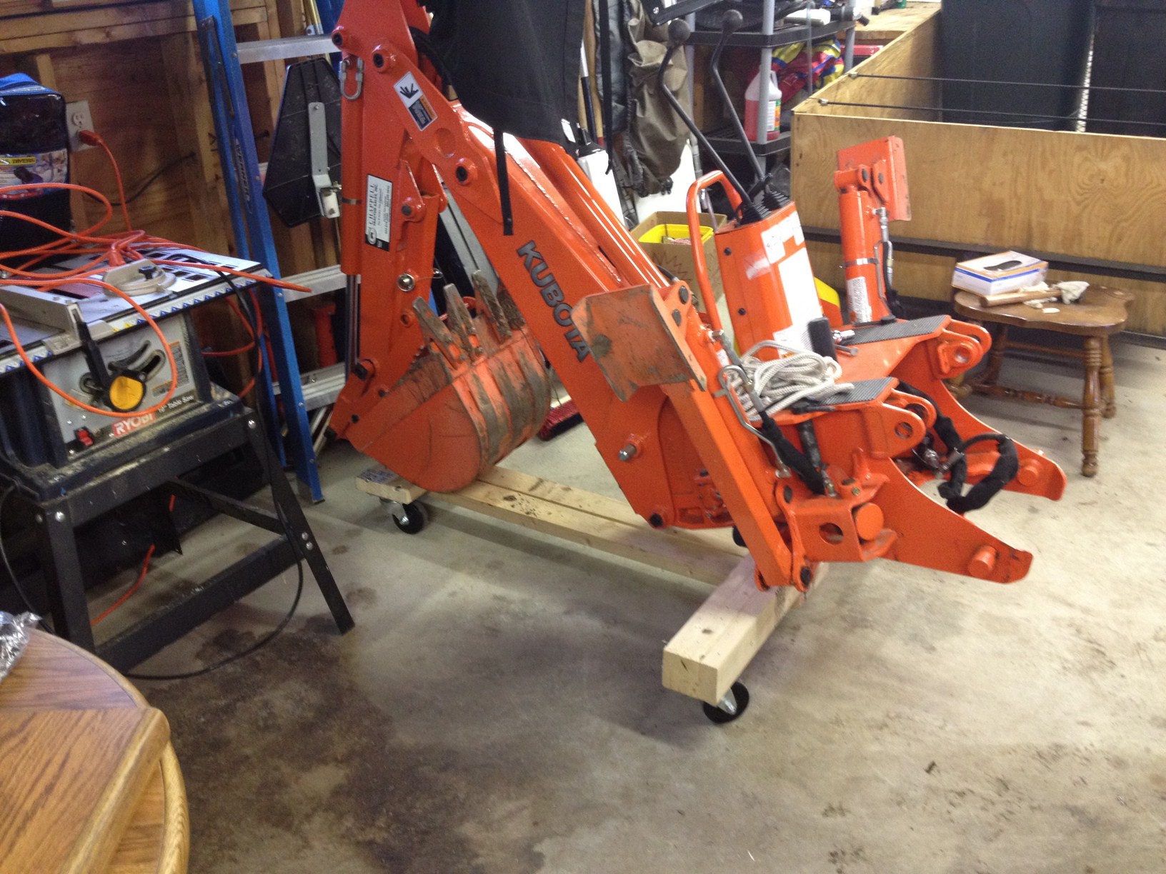

Nice dollies! I'm doing the same myself, but don't have nearly the assortment of implements you do. For really heavy stuff you might try the rubberized casters, I made a dolly for my BH, which weighs over 1,000 lbs and it's not too bad to roll around on a clean floor using those wheels.
Here are the ones I built:

Brilliant! I made these two recently, they have made it a lot easier to do things by myself.

Great job! Thanks for posting. A few years ago I built a BH dolly and it was my first welding job. It is still sticking together and has been wonderful. I think wood is great for smaller implements. I like your blade stand and will copy it. How would you change the upright if you were doing it again?

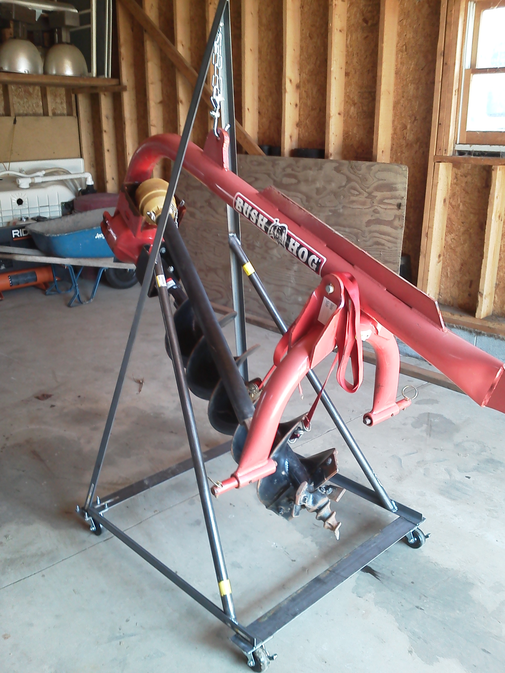

Well done! Just a couple weeks ago I decided to start putting stuff on rolling stands for two reasons. 1) storage space and 2) easier to hook up. I made the decision to do this after buying a PHD, wasn't planning on the purchase :D. I couldn't come up with a good way to store the PHD inside and did not want to just drill it into the ground. So this is what I came up with:
http://www.tractorbynet.com/forums/attachment.php?attachmentid=258048&stc=1&d=1332790576
After I did this and tried it, I thought wow! That was easy to hook up AND store. I just need to get some more wheels and steel for the rest of my toys, I mean tools! :laughing:

For the blade stand I'd try to work out a way to have the upright fold, so I could drive off it after picking up the blade. As it is, I need to lift the blade then roll the dolly off to the side because the blade itself hits the upright when I pull out.
I'd also see if I could figure out how to make the height of the upright adjustable, so it could be set to fit whatever height I have the blade set at the time. The issue being that I adjust the top link often to angle the blade for different tasks, and as it is I have to crank it back to the setting the stand is build for when I take the blade off.

Interesting. My casters are very similar (250 lbs i think). My floor is smooth concrete, but relatively dirty, I do have to sweep any hard debris out of the way before moving it. I've found the trick is to push low on the dolly to get it moving (otherwise the bh wants to move without the dolly). It definitely comes in handy, the hookup is a one step process now without any climbing on or moving of the tractor and I don't have to try to do any precision backing :)

This ought to motivate me to building one for my chipper since it's not QH compatable and a real PITA to hook up.
/ Equipment Dollies I Made
#17
Thanks, Roy.
One caution - when designing it, make sure the casters clear not only the dolly itself as they swivel, but also the base of the implement when it’s on the dolly. I made the chipper dolly a tad too narrow, so the casters can rub against the chipper stand when turned sideways. They don’t turn well when they do that. :-(
I made the dolly so the chipper rides as low as possible because I’m short on overhead room for the blower discharge. If it rode a bit higher, or the dolly was a couple of inches wider, all would be well.
