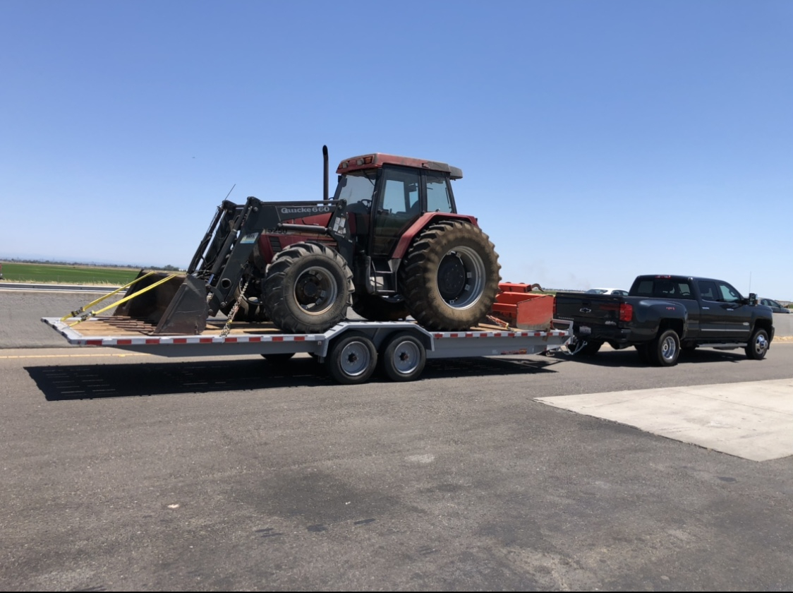

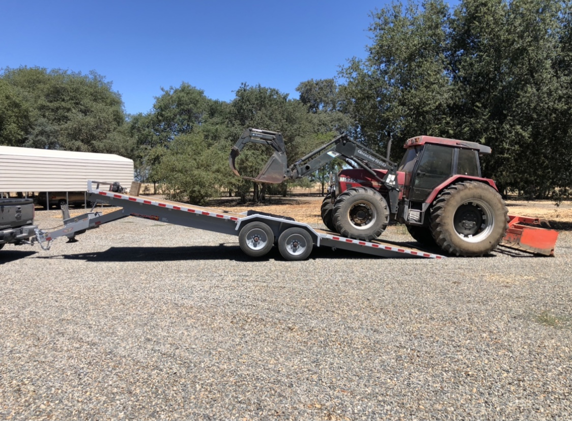

I just picked up mine couple weeks ago. It can be optioned with a gooseneck. Empty weight is 4540 lbs. I had serious reservations about this trailer when I first saw delivered pics. Pics badly distorted what I thought bad quality. I was wrong. It’s a great unit. 26’ 102” 16k, 10” channel frame. Full tilt, hydraulic Jack & tilt with wireless remote. GCWR in second pic 29,110 lbs. Handled beautifully.

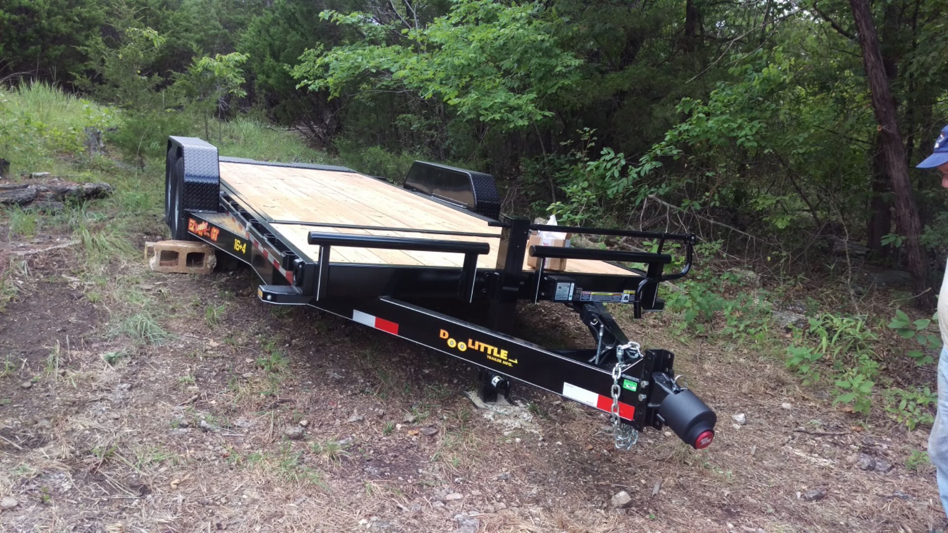

About 5000# seems pretty much correct. My Doolittle EZ loader tile (has two frames) but is a bumper hitch instead of gooseneck weights 3700 #. 14K. I called the manufacturer and scaled it myself to be sure. They really should include the actual weight of the trailer in the Spec. file. BUT I don't know of any manufacturers who do that.

Are you going down a runway?
This used to be a weigh station on Highway 99 north of Sacramento. It's my first heavy pull with the new trailer so was double checking for safety issues.
