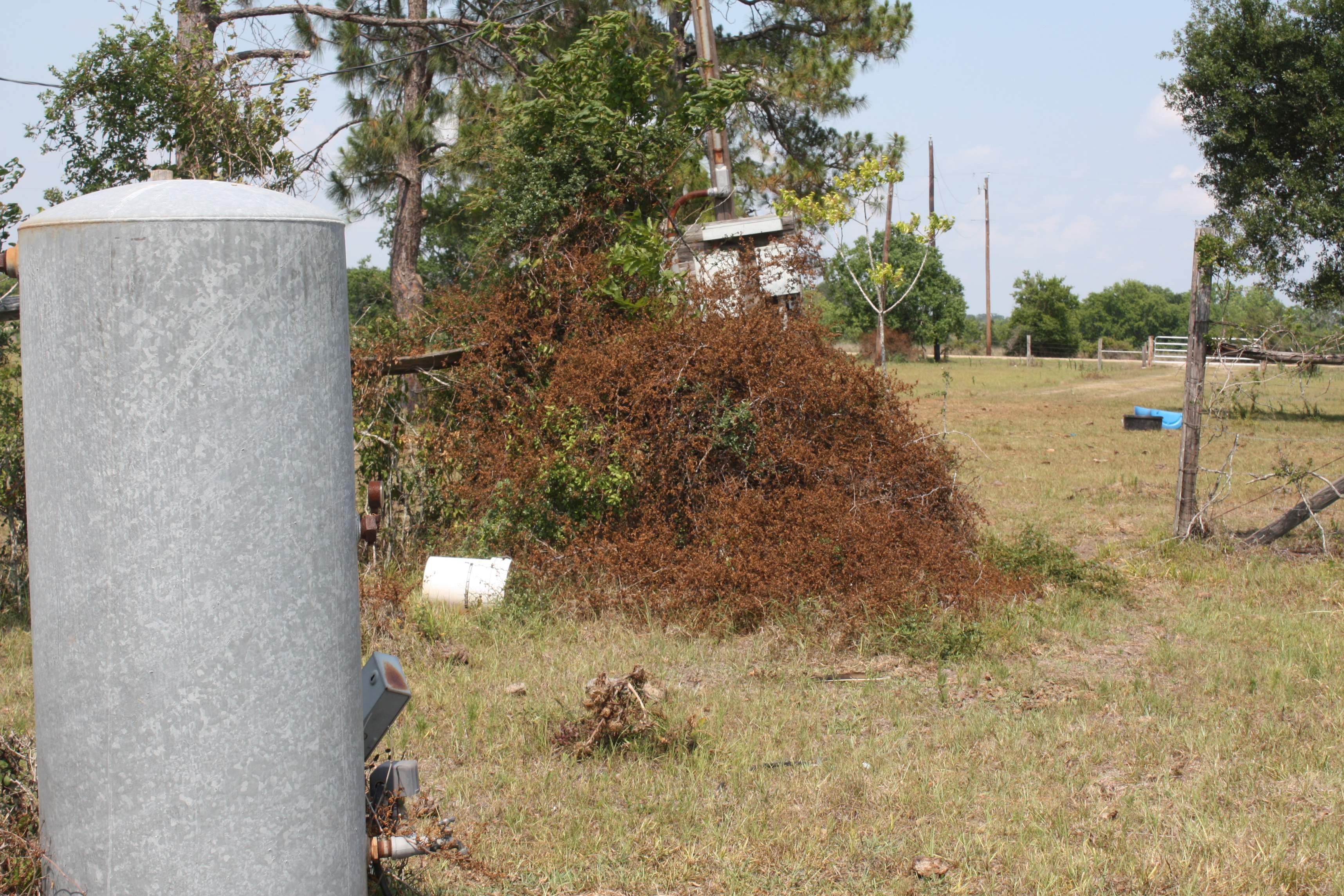

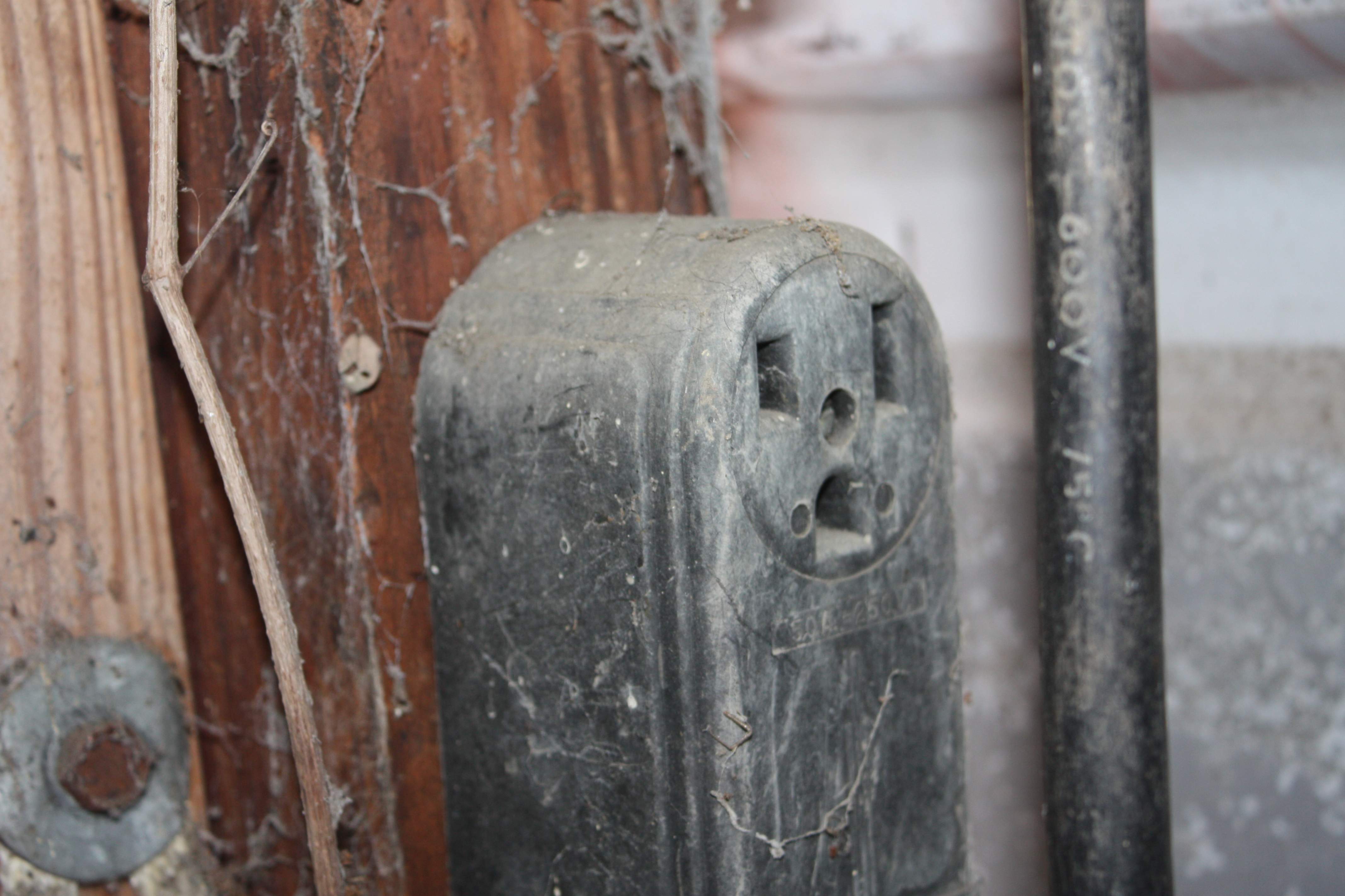

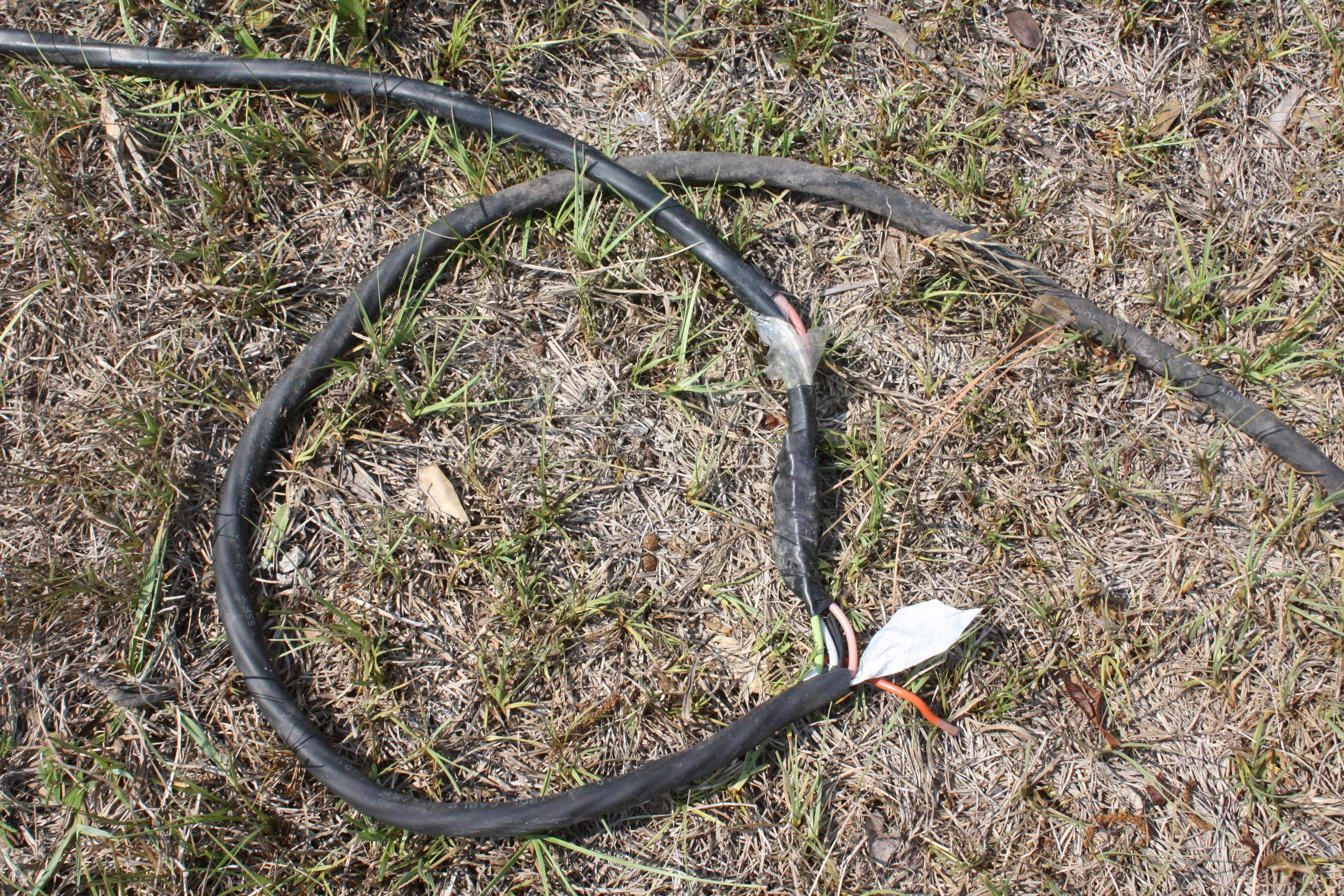

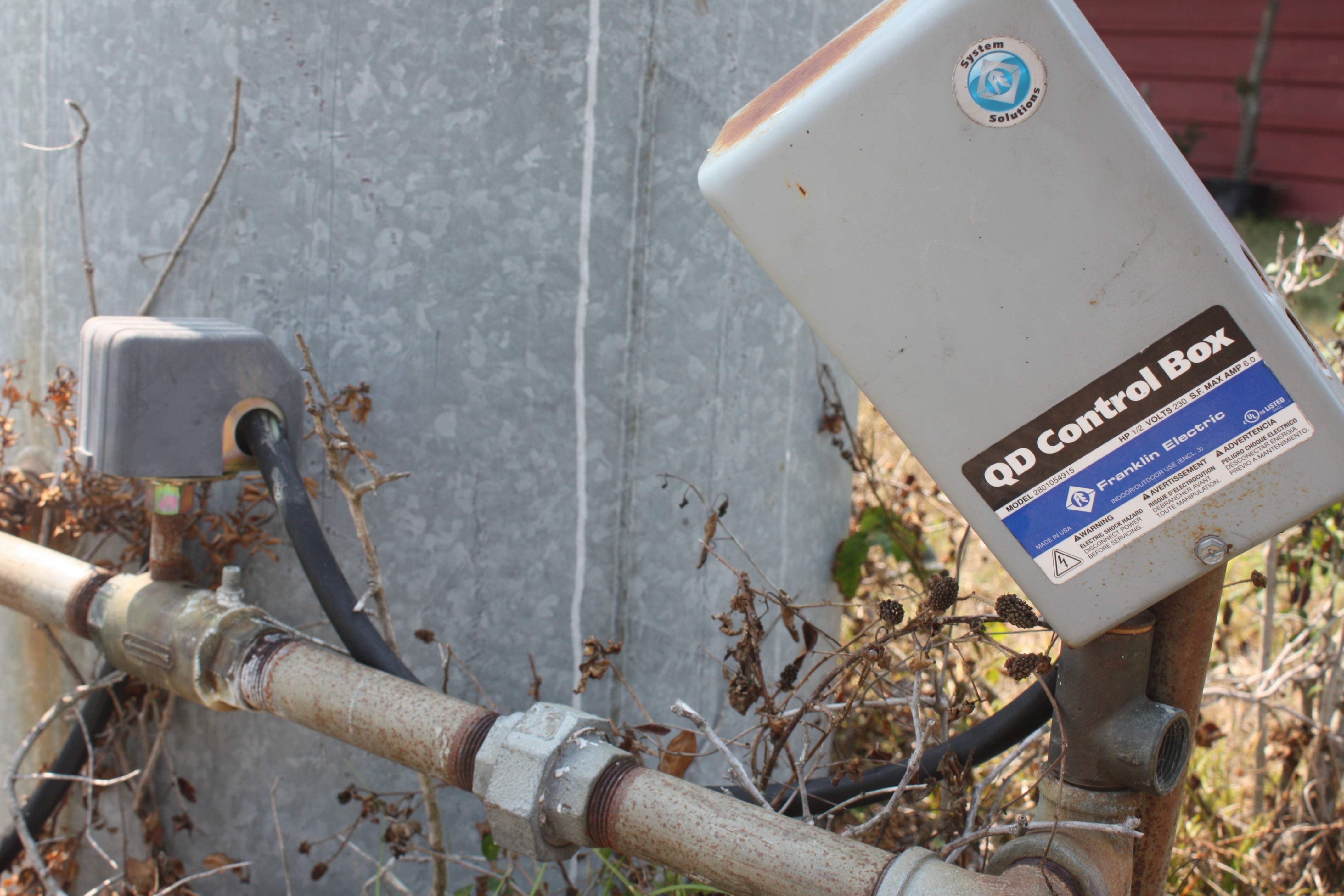

Here is: #1.) The water well. #2.) The above ground wire. Everything happens for a reason - if I didn't post the question yesterday - and if everyone didn't reply - and if I didn't go back out for additional pics - this unsafe wire might have sat there and caused some serious damage. At this point I am thinking replace everything - better safe than sorry. #3.) The water well feeds this trough.
We bought this land end of last June. It is unbelieveable I didn't notice this wire between last summer and now... dangit. What a dummy!!

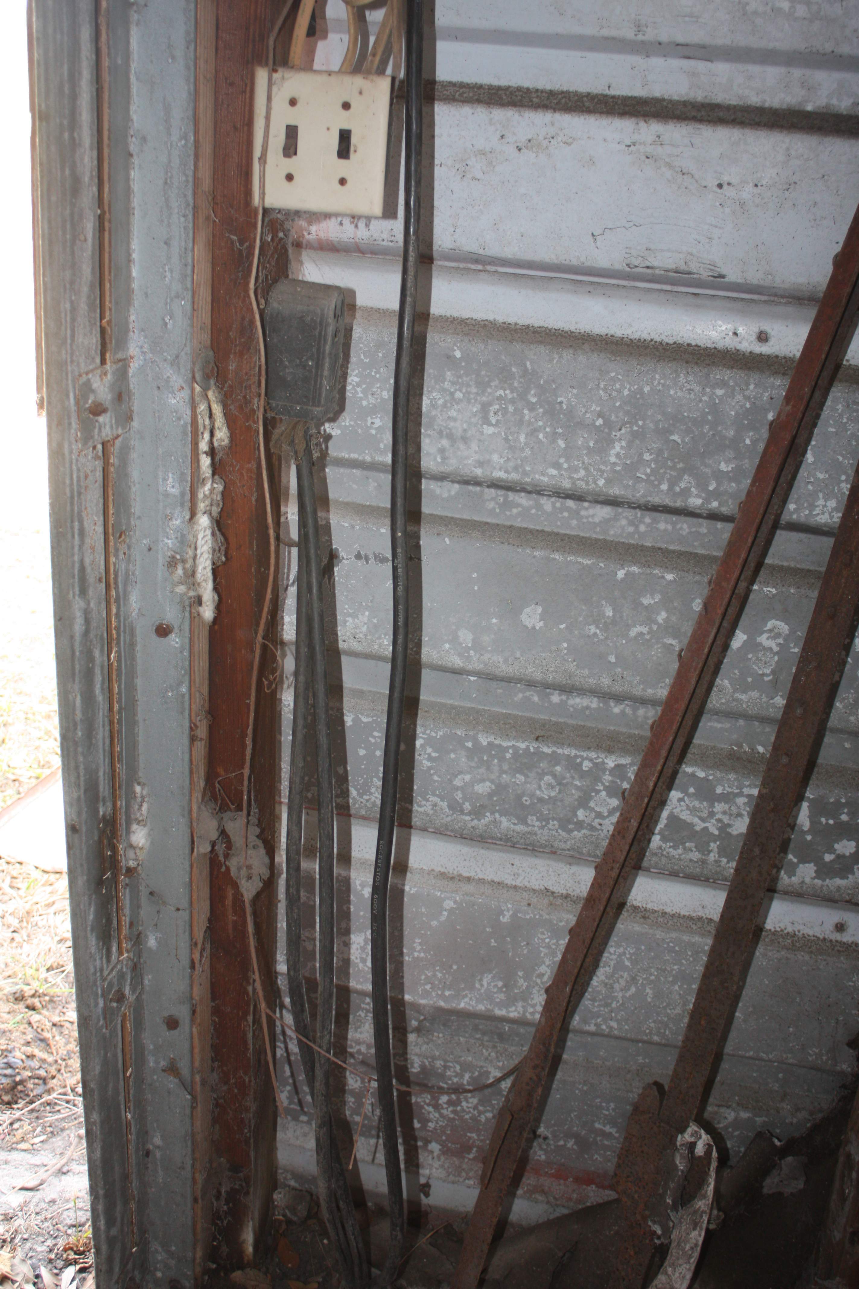

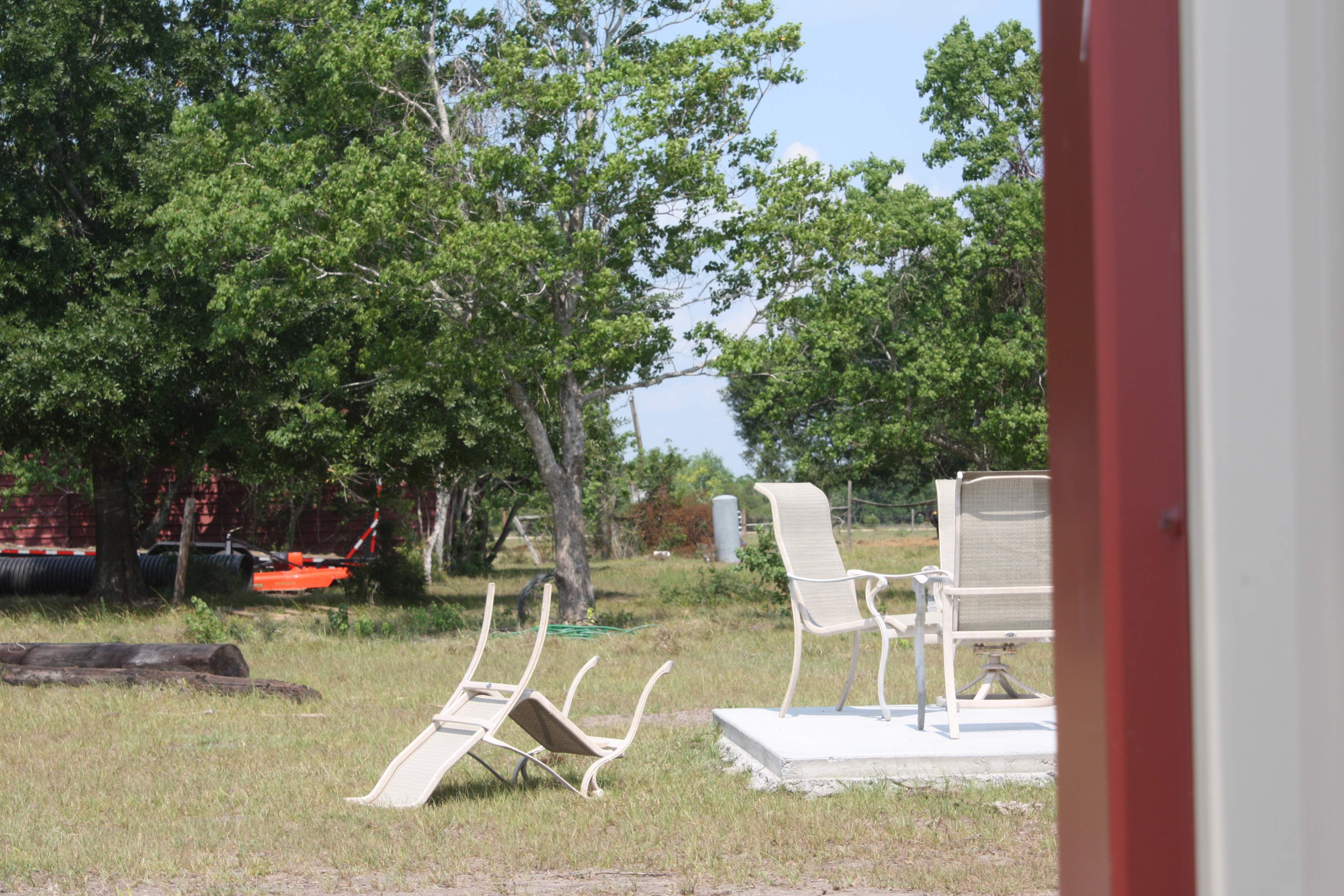

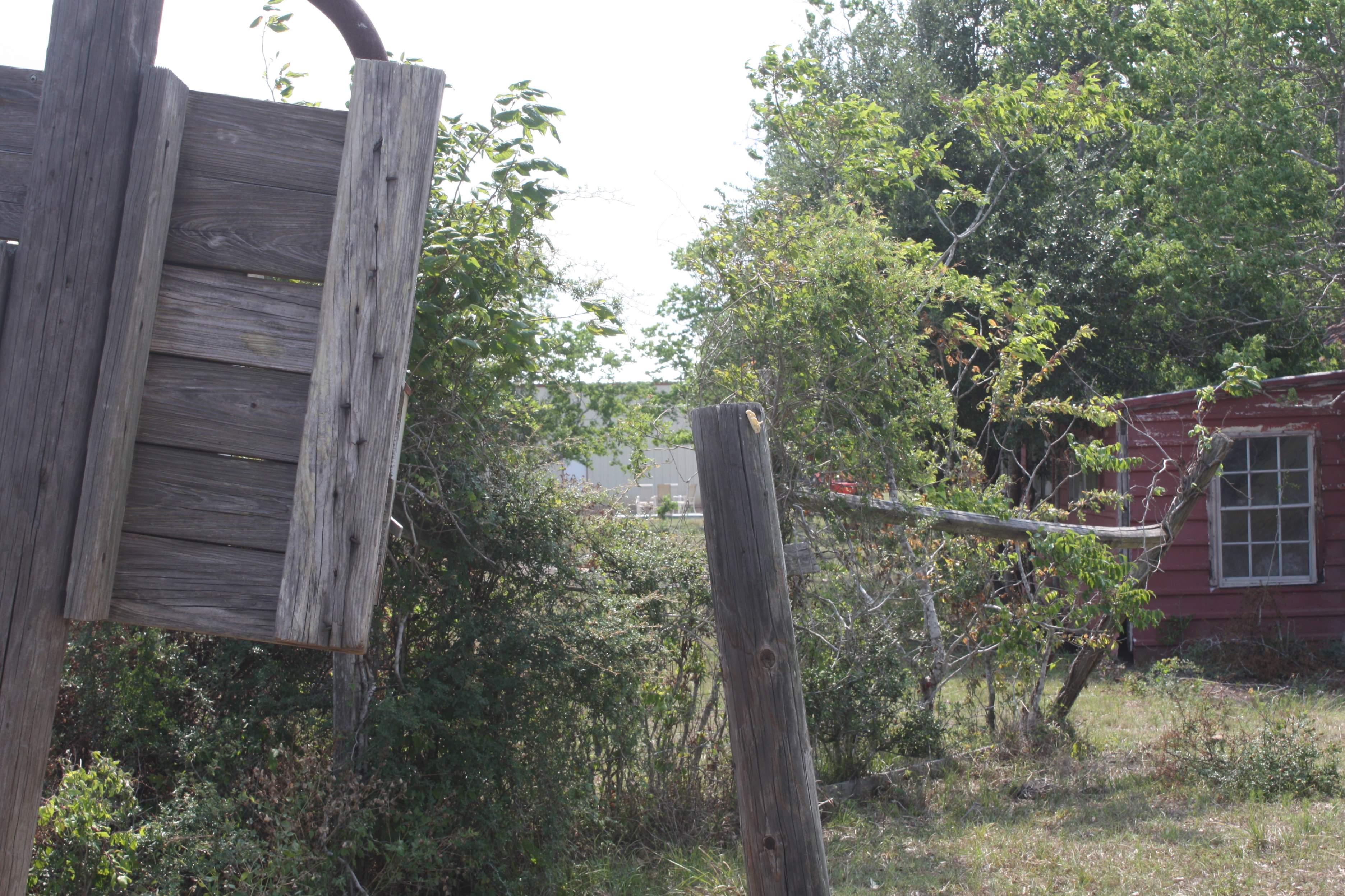

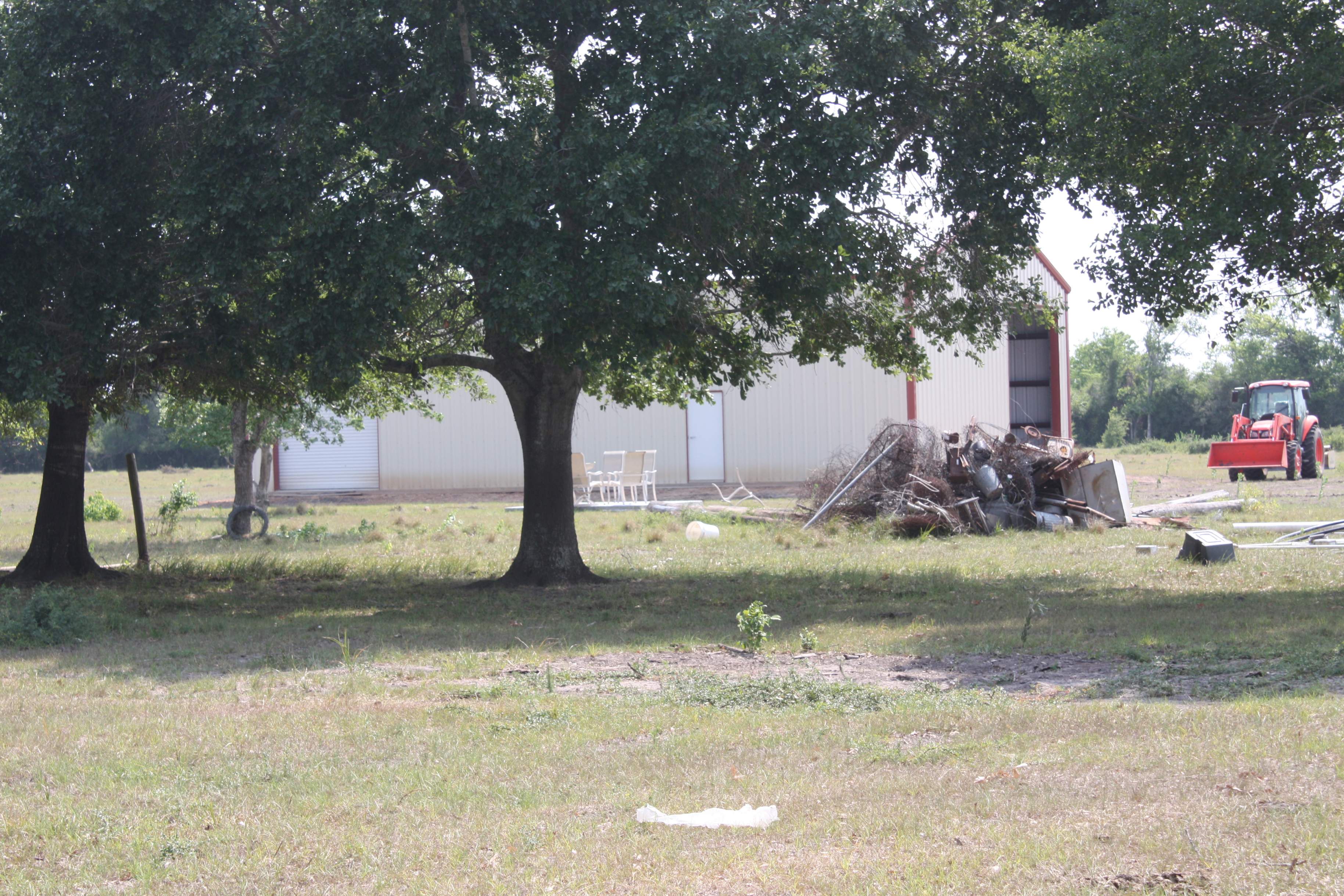

Random pics from today... Since I have a new schedule (none - LOL) I am trying to get all the nasty rose bushes up so we can spray with a boom and then grow some healthy grass... :thumbsup:
Tuesday I used my bucket but left them where they started. Yeterday I loaded some on a flat trailer behind my F250 - tore up my arms - it kinda worked. Today I pushed a bunch of them to this big pile... it worked... glad I have a cab.
Anyway - time to talk more about the electrical...

Interesting post. A good segway in to my questioning:
1.) Can I do something temporary that is safe and inexpensive? I dont mind buying all new - but doing it twice (once now and once again when we do the metal building) sounds wasteful.
You were reading my mind!! LOL! Thanx!!
2.) I don't plan to demo the old barn... with that in mind: My well and old barn are near my power supply. Later down the road when I have power at my new metal building - do I carry all the power to the metal building - run it through a circuit breaker panel - and then return to the well and barn - it sounds like a waste of wire...
3.) Can an electrician make use of those two wires that run from the 50a to the building? Disconnect that funky outlet and use the wires for something else? Like normal receptables...

If the old 50 amp wires still work, they can be used to power a subpanel and with that, it can be broken up into smaller 15 or 20 amp circuits to power outlets, lights, etc.
If this was my job, and your planning on moving power to new shop. If you buy a new , small panel for the existing service, you can go and re-use it in the old barn when it comes time to renovate that. If the current well wires are run to this old service, you can install a waterproof junction box in place of this old service and feed it from the newly rewired old barn with the current 50 amp wires that are running to the barn. Then feed the well with these wires (if they still work and arnt rotted out)... if you get my drift.
See id run new underground wires from the new shop to the old barn just because of the pictures i see of the old outlets in the barn. the wires seem to be just coming out of the ground. Id be leery at how good they are. Lets say you were to run a 60 amp feed from the 200 amps at the new shop over to the old barn, then run a 20 amp feed from the old barn out to the well ... possible using the old 50 amp circuits wiring. Just an idea

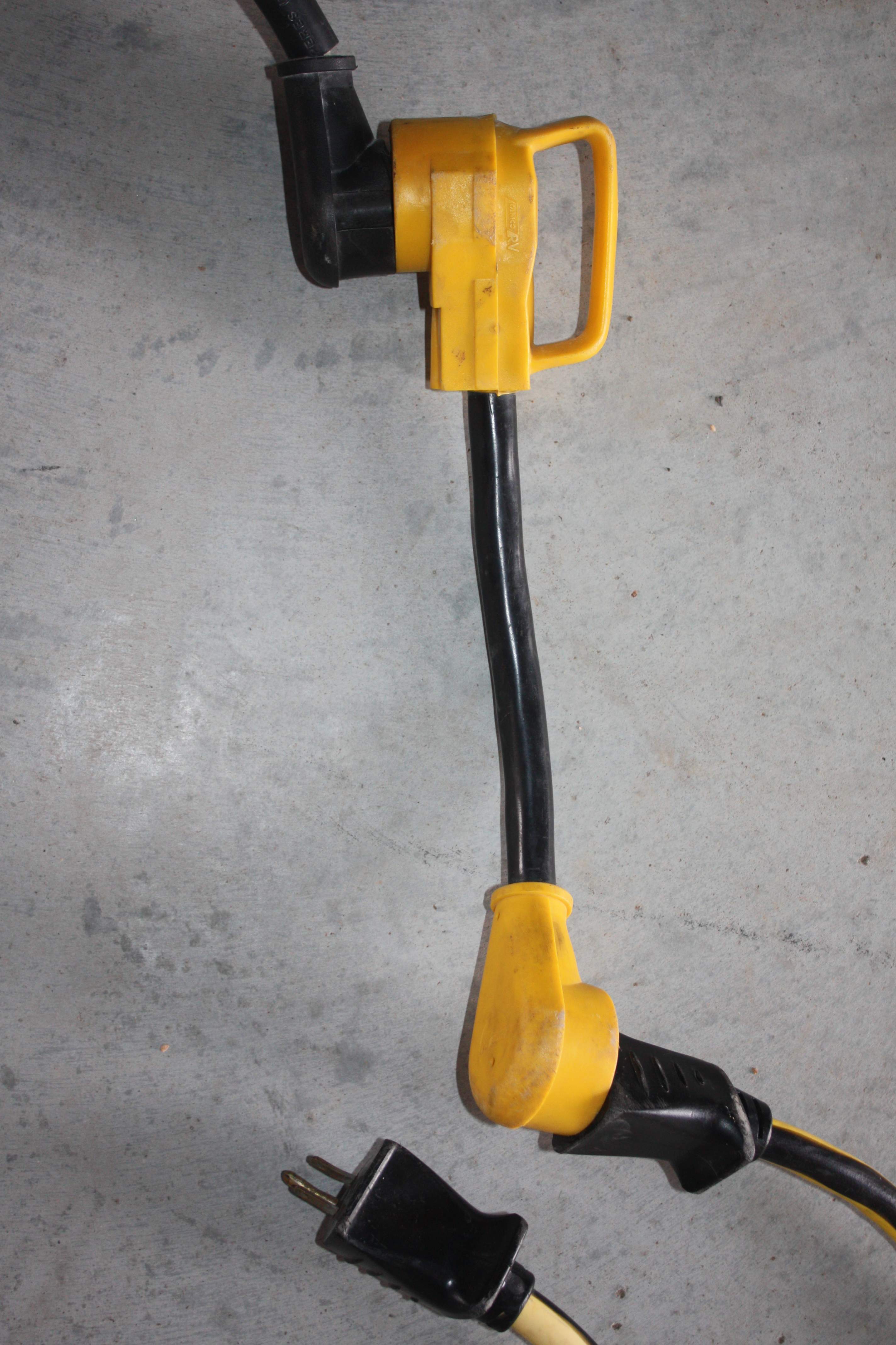

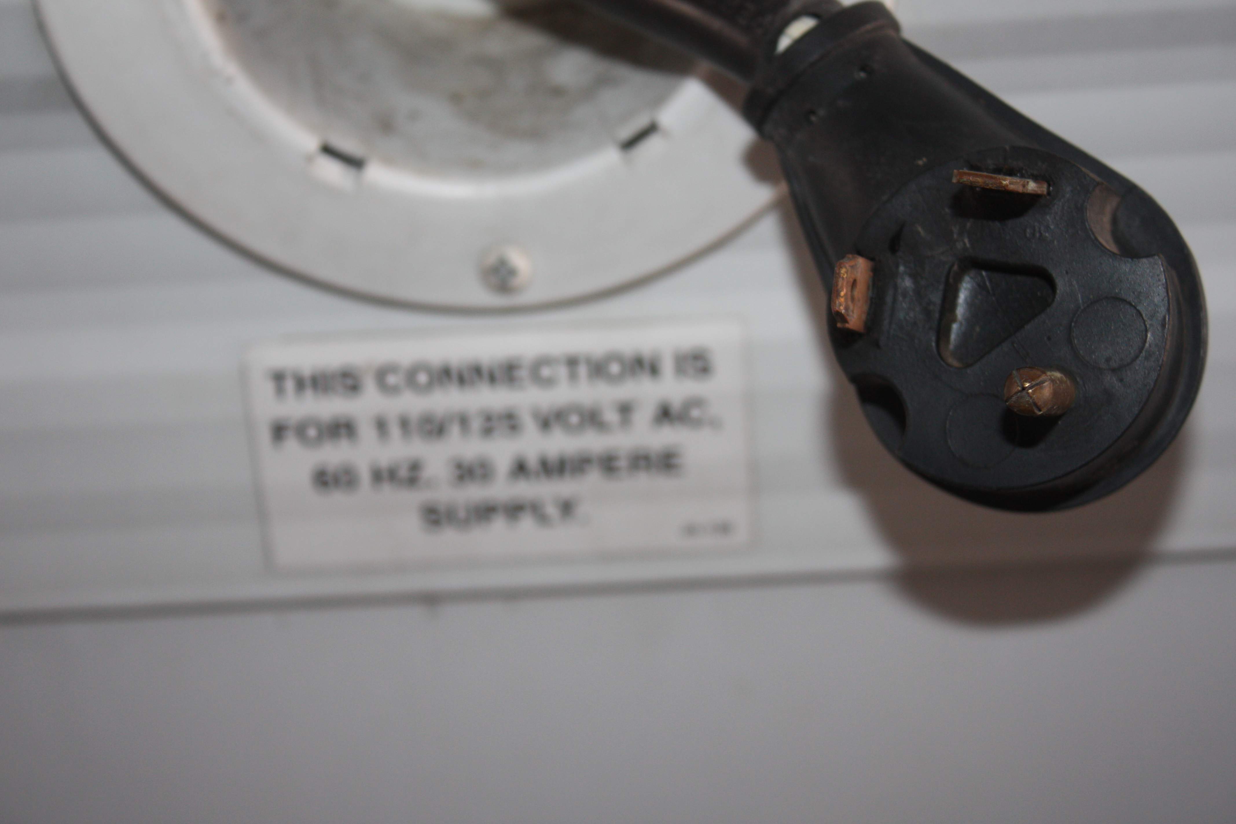

beyond what everyone has said. i am seeing a good amount of more problems in your recent posts.
if it were me.
i would most likely install new main panel at pole.
run new wire out to the old barn, and install sub panel in old barn
run new wire out to the well.
when ready, run new wire to new barn/shed. and install sub panel in new barn/shed.
i would remove the adapter you are now using for your trailer. (dog bone)
and most likely replace entire cable coming from of trailer. with a new "twist lock" plug able end ((double check on amps needed)). "ya said boys and dvd's" kids regardless. the twist lock. would be harder to unplug and a kid getting a shock.
i would most likely rewire old barn. for switches / lights / receptacles. and run to the new sub panel in it.
actually i take part of above back.....
i would install new breaker panel on utility pole.
run new wire out to the "old barn"
install a new sub panel in old barn and run wire from this to well
redo wiring for lights / receptacles in old barn to go to this new sub panel in it.
when it is time run new wire to new shed/barn and place sub panel in it. for all the lights / receptacles in it.
replace the wire / cable coming off of trailer for a new "twist lock" end. ((double check amps for entire trailer for size))
install full water proof twist lock receptacle on utility pole.
install GFCI standard receptacle at utility pole with full water proof covering.
above is a good amount of cost and not no temporary fix but long term fix.
due to need of running new wires to each area, including bringing things up to code, with installing ground rods. and getting wires from place to place under ground far enough to meet code for your area. i don't think there would be much if any sort of "re do over again costs" in above. just out of pocket expense for everything.
sorry, but to me, it looks like a DIY job someone did on there own. and a lot of the safety is just not there. and i am going to assume there are extra splices and things that you may not be able see or yet have found.
granted i am no electrician by no means. and been slowing replacing / upgrading / bring things up to code on this old farm (sheds and house) and the pictures i see resembled some of the nightmares i have had to deal with. and for me, it meant replacing and putting in new in many spots.
