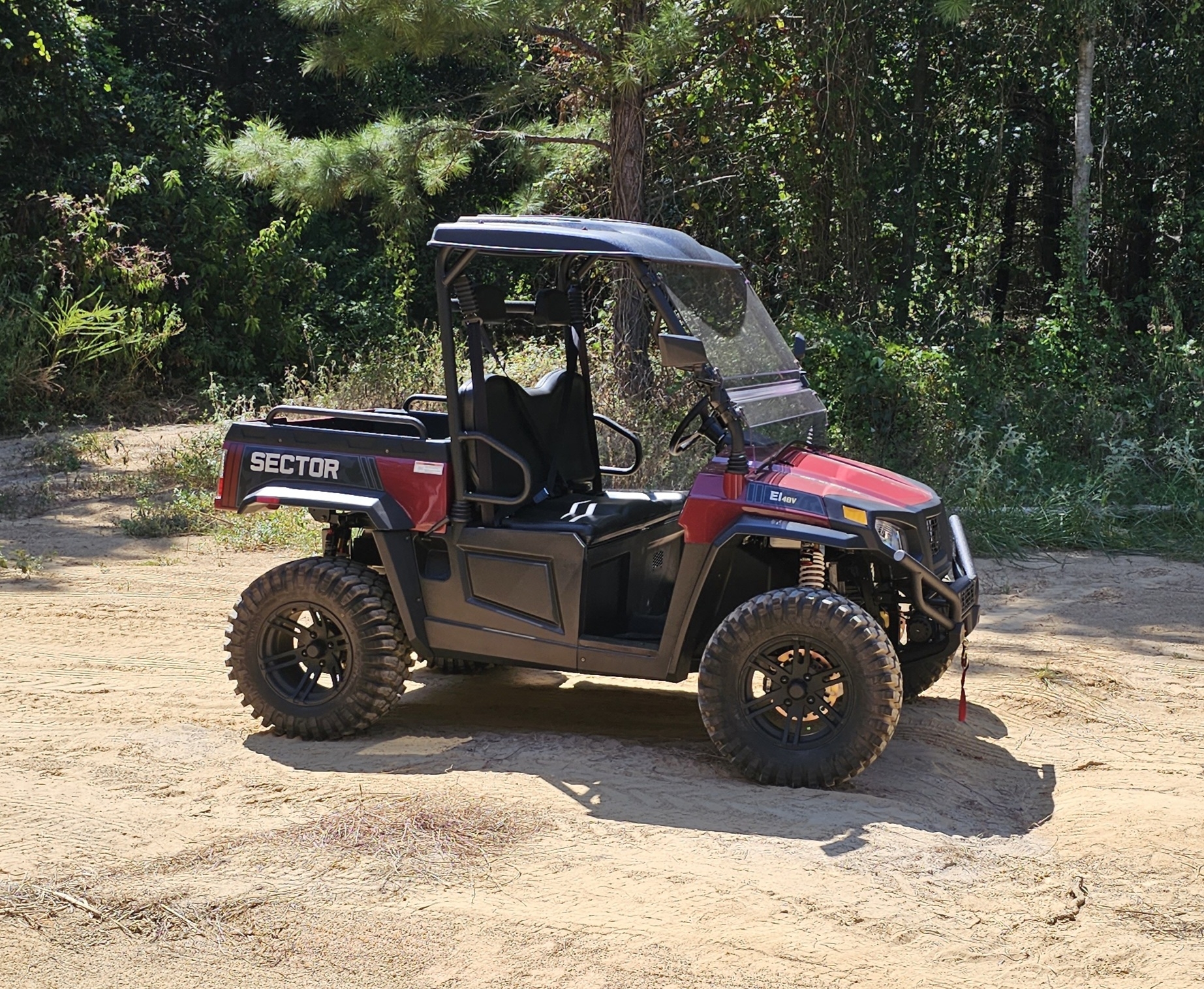

We finally pulled the trigger on this.
$13,200 out the door. 3500 lb winch, roof, windshield all standard. Delivery included (about 60 miles). Next step is to disable the backup beep. Very loud. I'll keep you all posted on the good and the bad. Dealer had stock, we could have had one same day, but needed to make some room in the garage first.
The driver position is a little snug for me, but I need to lose weight. Has tilt wheel, so that helps a bit. It is much faster than we need. So far, I only went about 100 yards with it. I was already hot and tired, will give it a longer run this morning.
