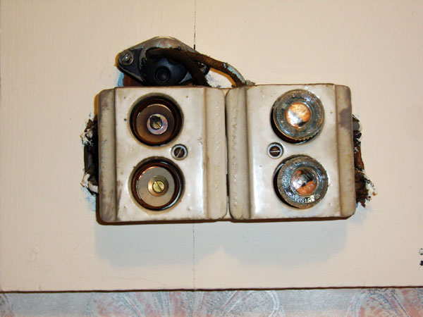

Last year I smelled something like burned electrical insulation. Found a very hot fuse box that was probably installed in 1934 when the house was built. [When we bought the house I though it was inoperational.] Traced down the circuit and breaker in the modern but mainly unlabeled main box. The electrician came and installed a new connection box to replace the fuses and then installed a GFI box inline just down stream from the main box. No room in the main box for the GFI. All is happy since.:D
I have been there. Since this place is a demolition/remodel I opted to replace all electric and plumbing. Parts of the place are over 100 years old. I was amazed and dismayed that people would actually do some of the things we found when inspecting the electric runs. I was actually surprized to find a basic extension cord running under tacked carpet into a wall outlet that then fed another wall outlet.

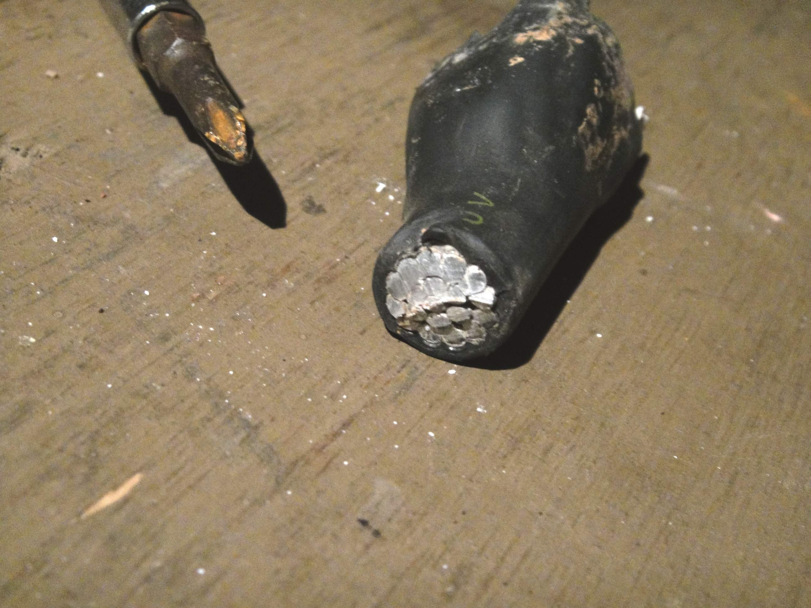

I had a similar problem in my detached shop that is powered by it's own D/B underground service, Mine turned out to be low voltage on one of the hot legs.
A 2 inch section of the large 4-O wire oxidized to the point of just one 14GA strand left. apparently there was a nick in the insulation that let water in.
The cable was all swollen up and powderized.

This past summer, had half the house go out. Yup, one leg of the underground supply was out. Thus, only had 1/2 the service panel powered. Simple fix. Power Company came out, foreman had his detector, found the spot immediately. (under my row of green beans!!)
They dug down 2.5 feet and spliced the line, hot gun new shrink wrap. All was well.
It doesn't take much a nick in the underground jacket to cause the ground acids (or whatever) to short out that line. It was aluminum, if memory serves.

This is what my underground wire looked like in the part they cut out, was only about 3 inches like this, what I'm surprised about is I was using my 220 volt welder right up till it went out on that one leg, actually was still getting low voltage of around 30 volts.
Can't figure how the welder was running normally on that little strand that was left.
