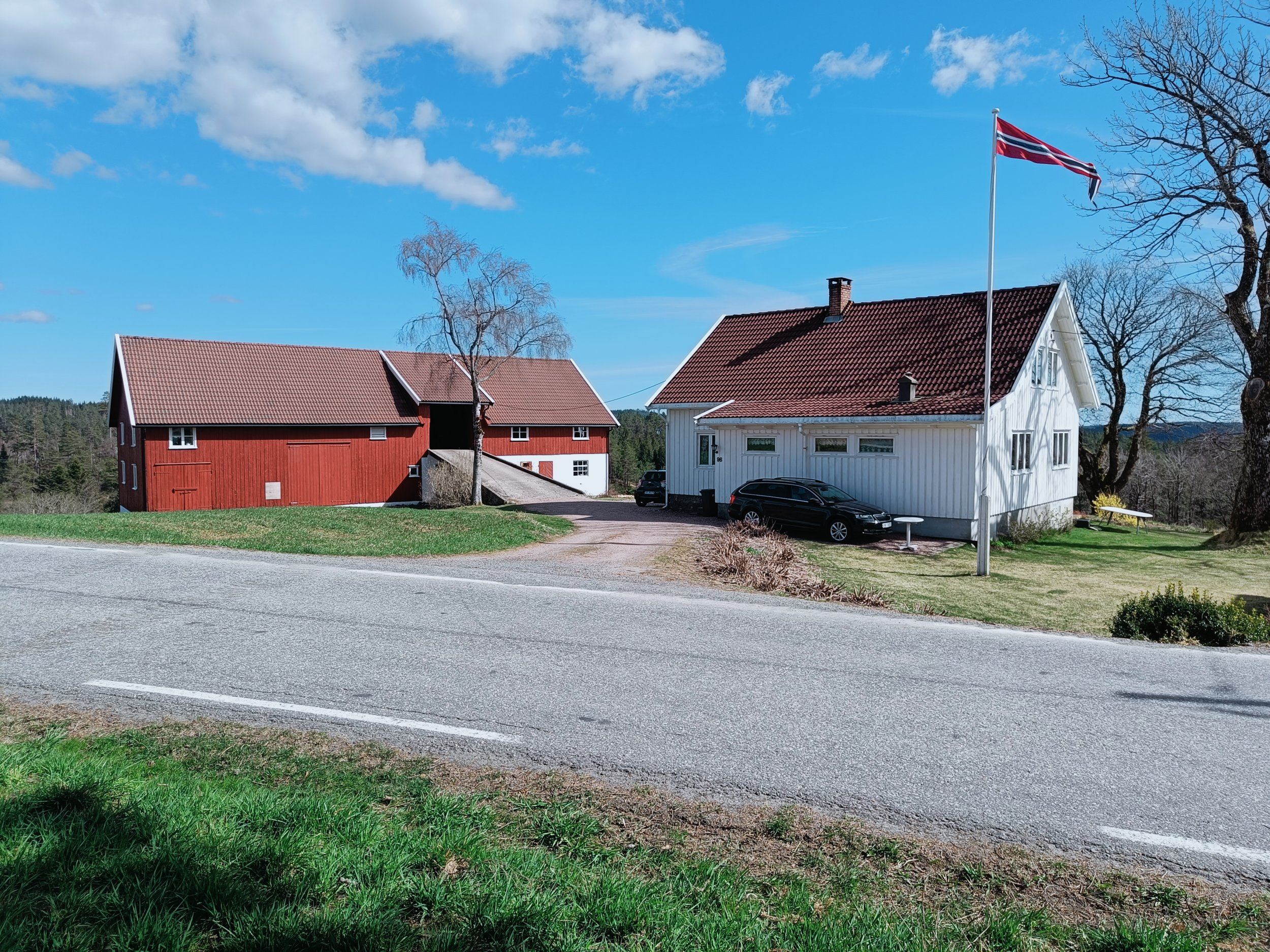

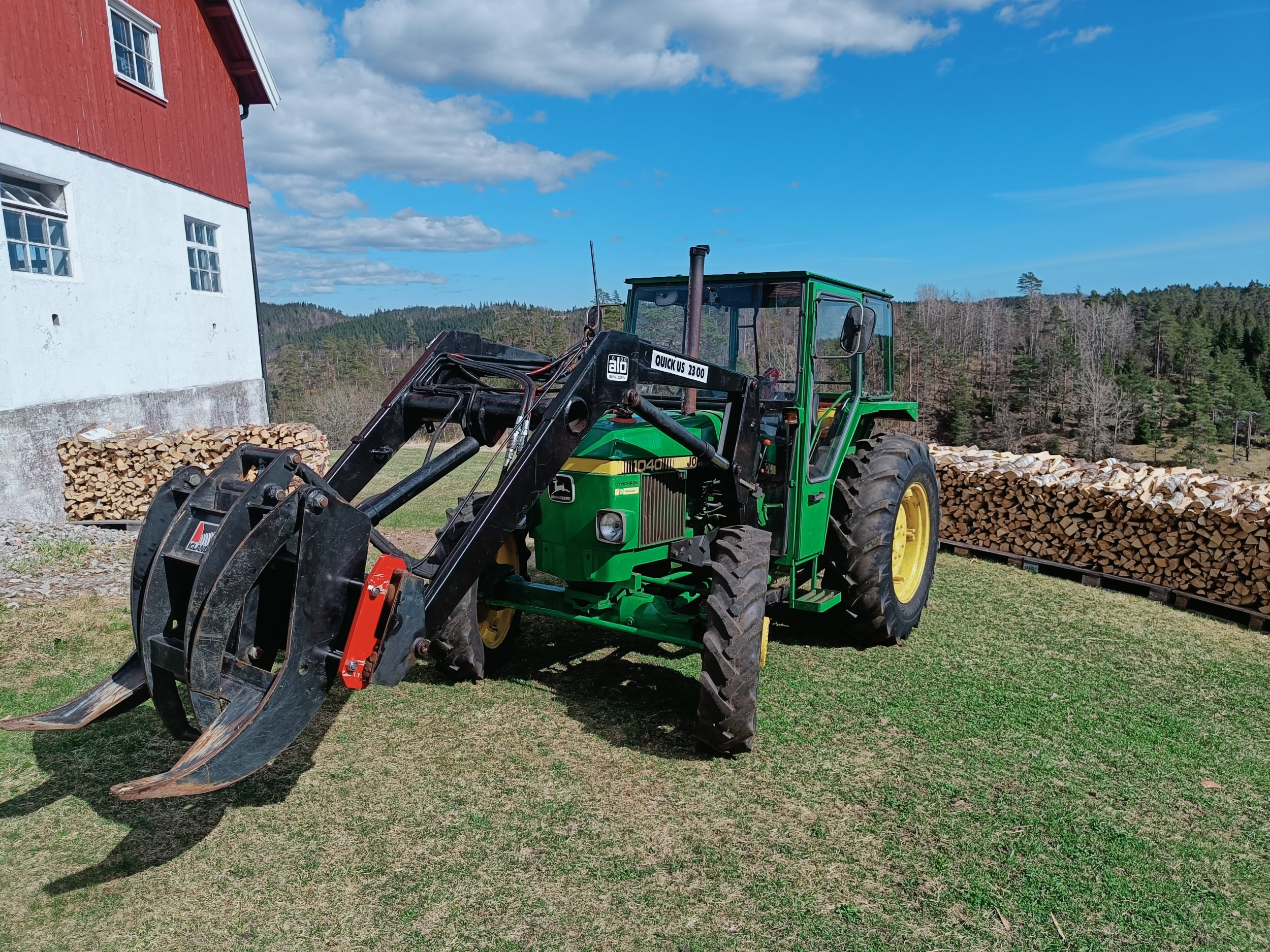

Here's a couple of pictures of the tractor and one of the farm on this lovely Sunday :)
